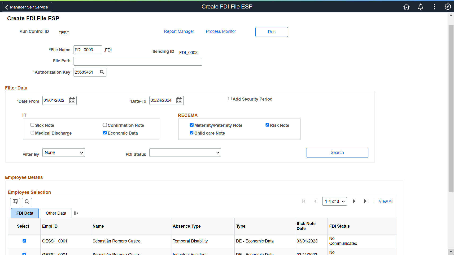

Create FDI File ESP Page
Use the Create FDI File ESP page (GPES_FDI_FILE) to .
Navigation:
Global Payroll & Absence Mgmt, and then Social Security / Insurance, and then Create FDI File ESP, and then Create FDI File ESP
This example illustrates the fields and controls on the Create FDI File ESP page.
FDI File Name
Field or Control Description
Sending ID
This field displays the sending ID used to track and confirm transmission of the FDI medical report text file to the social security agency. The system automatically generates it by combining the user ID and run Control ID.
File Name
Enter a name for the FDI medical report file. The system automatically appends the official FDI extension to this name.
File Path
Specify the path to the location where you want the system to save the FDI medical report text file.
Authorization Key
Enter the Social Security Authorization Key, so that only employees linked to companies with that key are included in the file.
Filter Data
Date From and Date To
Specify the period for which you want to retrieve disability data for the FDI medical report text file.
When you click Searchbutton, the system retrieves note data from the Additional Data page with dates that fall between the specified From Date and To Date, and that satisfies any other search criteria you have defined.
Add Security Period
Select to have the system check the date on which you transfer medical information to the social security agency against the official time limit for sending such information.
For example, organizations should send sick note data to the agency within five days of receiving a note from an employee. If this time limit is exceeded, the system marks the employee as late in the Employee Details group box, but continues to process the data.
If you apply the security period check, you must define the time limit for each note type on the Social Security Data page (discussed previously).
Sick Note
Select to include sick note (PB) data entered on the Additional Data page in the FDI medical report file.
Medical Discharge
Select to include medical discharge (PA) data entered on the Additional Data page in the FDI medical report file.
Confirmation Note
Select to include confirmation note (PC) data entered on the Additional Data page in the FDI medical report file.
Economic Data
Select this checkbox to report economical data related the absence. This type of communication was introduced starting April 1st 2023 as result of RD 1060/2022 and Orden ISM 2/2023. This communication replace PA, PB and PC communications.
Maternity/Paternity Note
Select to communicate Maternity/Paternity data as entered in Additional Data page of Absence Event ESP component.
Risk Note
Select to communicate Risk during Pregnancy or Risk during Lactancy, as entered in Additional Data page of Absence Event ESP component.
Child Care Note
Select to communicate Child Care absence, as entered in Additional Data page of Absence Event ESP component.
Filter By
Use the values in the Filter By drop-down list to limit the population of employees whose temporary disability data is included in the FDI medical report text file.
Valid values are:
  • None : Select if you want to generate report data for all employees with temporary disability records who fall within the specified time period.
  • Company: Select if you want to generate report data for employees with temporary disability records in a specific company or group of companies. You must then specify the company or companies in the Company field.
  • Employee: Select if you want to generate report data for specific employees with temporary disability records. You must then specify the employees in the EmplID field.
  • SSN: Select if you want to generate report data for employees associated with a specific company and employer social security number. You must then specify the company and employer social security number in the Company and Social Security Number fields.
FDI Status
Select the FDI status of the employees to be included in the report. The valid values are:
  • Not Communicated
  • Included in FDI: System looks for employee absences for which the FDI file is created, but not yet confirmed.
  • FDI Sent Confirmed: System looks for employee absences for which the FDI file is created and confirmed
Search
Click to retrieve the list of employees who meet the filter criteria.
Employee Details - FDI Data
Use the Employee Details group box to include employees in, or exclude them from, the FDI medical report text file.
Confirm All
Click to include all of the listed employees in the FDI medical report text file.
Unconfirm All
Click to exclude all of the listed employees from the FDI medical report text file.
Other Data
Original Begin Date
Displays the begin date of the absence.
Late
This check box is automatically selected when you report sick, confirmation, or medical discharge data outside of the time limit for transmitting the data specified on the Social Security Data page.
Note: The system automatically checks whether you are processing the note data within the time limit when you click the Search button on the Create FDI File ESP page. However, you must select the Add Security Period check box to enable this time period check.
Discharge Reason
Displays the reason for discharge.
