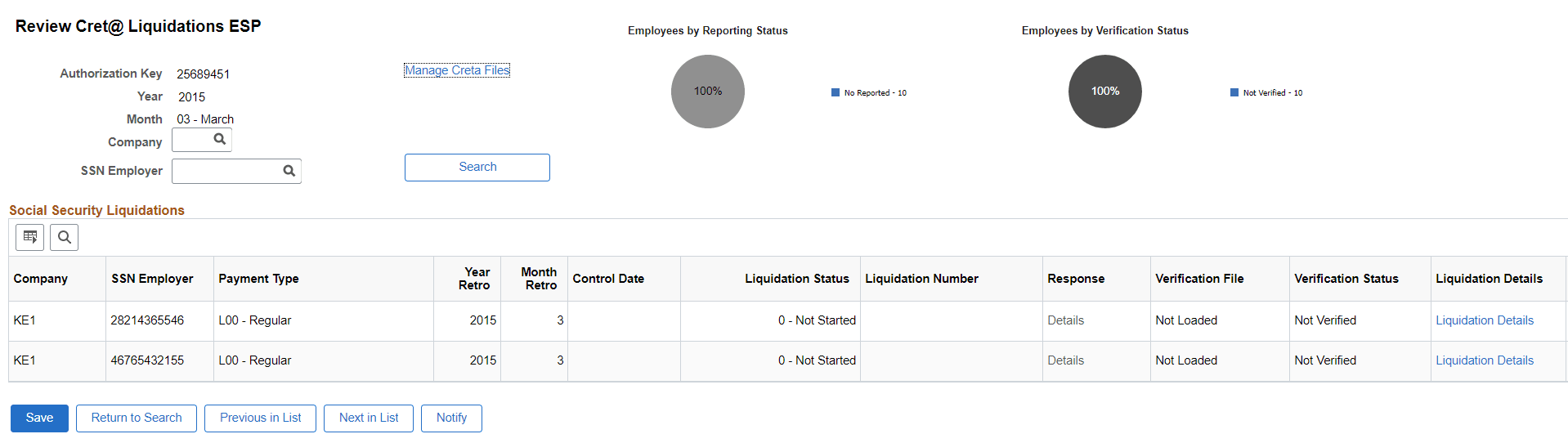

Review Cret@ Liquidations ESP Page
GPES_CRT_LQ_REVIEW
Monitor the liquidation status for a month.

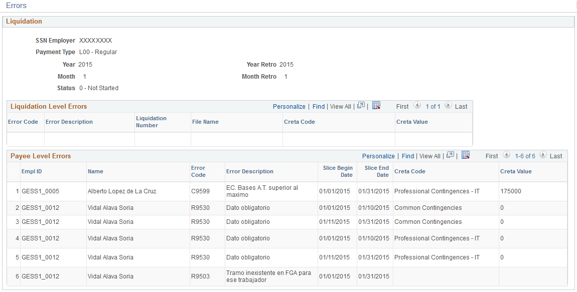

Errors Page
GPES_CRT_LQ_ERR
Review the list of errors that have been loaded in the system

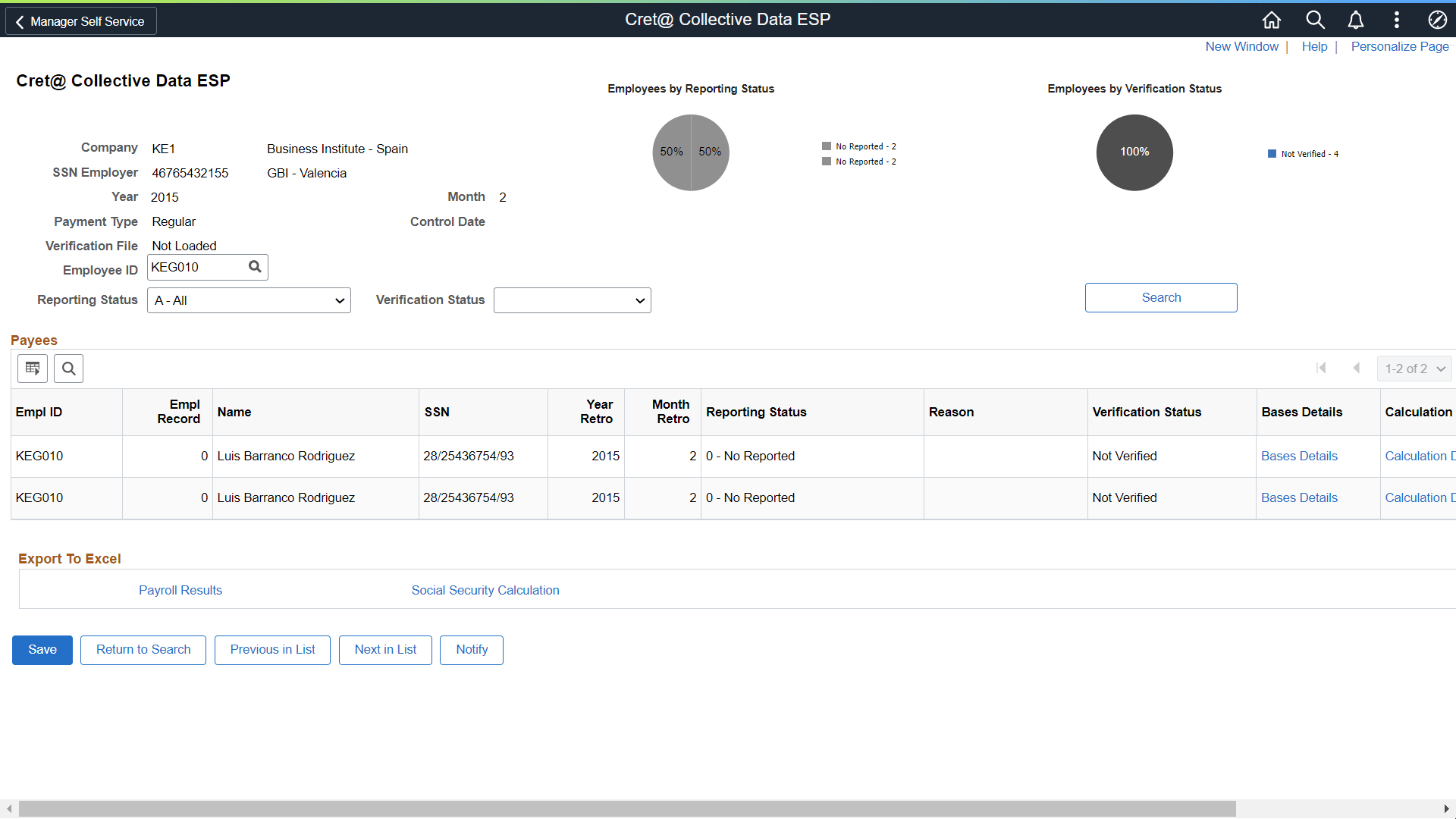

Cret@ Collective Data ESP Page
GPES_CRT_COL_DAT
View Cret@ results by Company, Employer Social Security Number, Month / Year, and Payment Type.

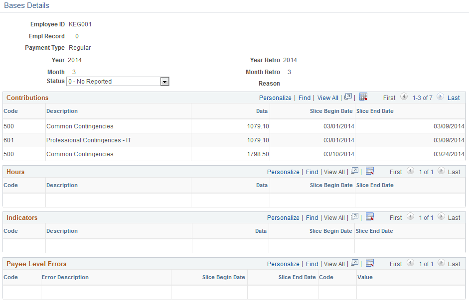

Bases Details Page
GPES_CRT_COL_EDL
View details of bases, hours and indicators of the employee for a slice.

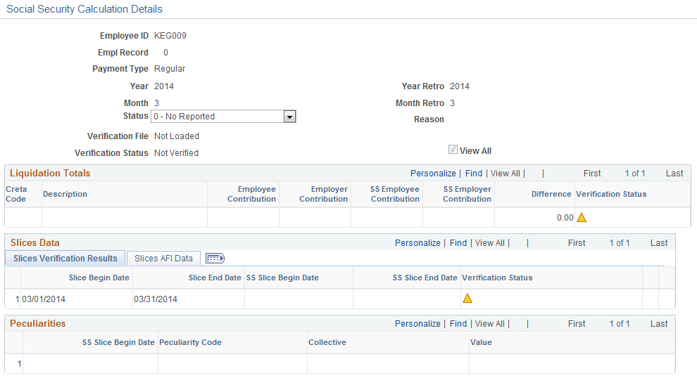

Social Security Calculation Details Page
GPES_CRT_COL_VRFY
View details about contribution data and slices.

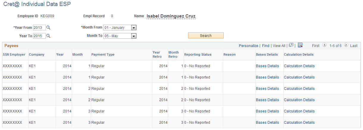

Cret@ Individual Data ESP Page
GPES_CRT_IND_DAT
View the Cret@ results for an employee.

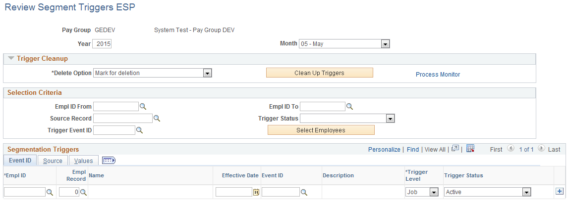

Review Segment Triggers ESP Page
Use the Review Segment Triggers ESP page (GPES_TRIGGER_SEG) to manage segmentation triggers that affect Global Payroll for Spain. Using this page, you can run the clean up process to remove obsolete triggers. We recommend you to run this clean-up process (optional, but highly recommended) before payroll process every month in order to clean the obsolete triggers. The process checks the existing triggers and the information in the source records, and in case they do not match, you can see the list to decide if you want to delete those triggers or not.
You should slice the social security calculation only in cases specified by Social Security. If you report contribution bases of an employee in a different way than what Social Security is expecting, they will not calculate contributions for that employee. That is, if you modify or delete data that results in segmentation, you need to update the segmentation trigger record accordingly.
Navigation:
Global Payroll & Absence Mgmt, and then Absence and Payroll Processing , and then Prepare Payroll, and then Review Segment Triggers ESP
This example illustrates the fields and controls on the Review Segment Triggers ESP page. You can find definitions for the fields and controls later on this page.
Trigger Cleanup
Use this group box to run a clean up process that deletes obsolete segmentation triggers. The process checks the existing triggers and the information in source records, and if they do not match, the process lists the triggers and allows you to delete them.
Field or Control Description
Delete Option
The values available are:
  • Mark for deletion: Update the trigger status to ‘D’. This does not delete the segmentation triggers, but the trigger will be ignored by the Payroll process.
  • Delete marked for deletion: Delete triggers with status ‘D’.
  • Clean Active: Delete obsolete triggers.
  • Delete cancelled: Delete cancelled triggers (triggers with status ‘C’).
Clean Up Triggers
Click this button to initiate the clean up process.
Process Monitor
Click this link to access the Process Monitor page where you can monitor the progress of the clean up process.
Selection Criteria
Empl ID From and Empl ID To
Select the range of employees for whom you want to search for triggers.
Source Record
Select the source of the trigger.
Trigger Status
Select the status of the trigger. Possible values are: Active. Cancelled, or Marked for Deletion.
Trigger Event ID
Select the trigger event to use. This determines the type of segmentation to use to process the segmentation events: Period or Element. In case of element segmentation, it also determines the elements to segment.
Select Employees
Click this button to display the employees based on the criteria you selected.

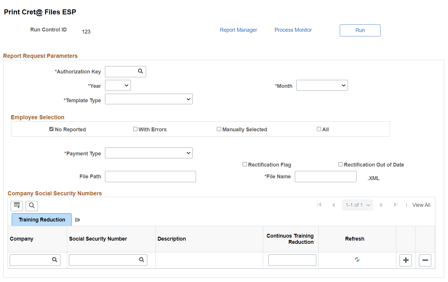

Print Cret@ Files ESP Page
Use the Print Cret@ Files ESP page (GPES_RC_CRT) to create Cret@ files for the electronic transmission to the Social Security agency.
Navigation:
Global Payroll & Absence Mgmt, and then Social Security/Insurance, and then Print Cret@ Files ESP
This example illustrates the fields and controls on the Print Cret@ Files ESP page.
Print Cret at Files ESP page
Authorization Key
Enter the authorization key for which the XML file is created. The same authorization can manage multiple companies in the same group.
Year and Month
Select the year and month for the XML file.
Template Type
The values are:
  • Request of Calculation Details: You can send this file to Social Security after liquidation has started, to request information about the calculation being run at Social Security side.
  • Request of Confirmation: You can send this file to Social Security to communicate your agreement on the liquidation.
  • Request of Employee Slices: You can send this file to Social Security to request information about the employees to be reported, in relation with the slices to be reported. You can request for this file just before the liquidation is initiated, either by sending ‘Request of a draft’ or ‘XML of Bases’.
  • Request of a draft: You can send this XML file to initiate a liquidation or to force a recalculation of a liquidation after it was open. For example, if you correct something in the affiliation side (FGA) through the AFI file, and you want Social Security to re-validate the information already sent, you can use this file. It contains just information about the Authorization key (to identify the sender company), CCC (Employer Social Security Number) and liquidation (month and liquidation type) that is being processed
  • XML of Bases: This file contains, in January, economical information (contribution bases) and other like hours or certain flags for all the employees. It also contains information for all the employees the first month sending Cret@ files. For any other month, it should contain just the information about the employees with changes with respect previous months Each month, you can decide if you want to include all employees, or just the ones with changes during the previous month. It can contain information for employees belonging to one or more CCC associated with the same authorization key.
Payment Type
Select the payment type for the report that you want to generate for a specific month for the Employer Social Security numbers that are selected. The possible values are:
  • Full: Includes everything that was calculated in the month, like regular contributions, contributions due to vacations, litigation salaries, and retroactivity.
  • Litigation Salary: Runs the report for deltas due to the litigation process. This is a legal process for resolving disputes between employers and terminated employees. Until this process is resolved, salary paid to the employee is identified as tramitation salary.
  • Regular: Refers to L00 liquidation.
  • Regular and Vacations: Includes the regular payroll and the contributions due for vacations that are paid at termination.
  • Retroactivity w/Surcharge: Runs the report for the deltas detected in previous months due to retroactivity, and includes a surcharge. This includes both L90 and L91 complementary liquidations.
    Note: For the FAN file, the code used for this type of liquidation is L09. When you move to Cret@ reporting, you need to start using either L90 or L91 code. To verify, please check the default value of variable SS VR RTR L03/L09
  • Retroactivity wo/Surcharge: Runs the report for the deltas detected in previous months due to retroactivity, but does not include a surcharge. (L03)
  • Vacations: Includes the contributions due for vacations that are paid at termination.
Break Down of Employees
Select this check box if you want Social Security to provide the calculations at an employee-level in the response file.
Note: This check box appears when you select Request of Calculation Details in the Template Type field.
Reuse Previous Month Bases
Select this check box if you want Social Security to load the bases reported for the previous month. This applies only to regular liquidation (L00).
Note: This check box appears when you select Request of a Draft or XML of Bases in the Template Type field. This check box is not available for the month of January.
Negative Bases
Using this field, you can define how to manage negative deltas in Cret@ reporting. The possible values are:
  • Exclude Full Employee: System removes the whole employee for the liquidation in which a negative value is encountered.
  • Exclude Only Negative: System removes only the negative base and prints any other delta existing for the employee and liquidation.
Rectification Flag
Select this check box to override an already confirmed liquidation.
Rectification Out of Date
Select this check box if you want to resend a liquidation upon request of Social Security for a rectification process. When this checkbox is selected, the system displays the field Liquidation Number in the grid for Company Social Security Numbers, allowing the user to select the liquidation being replaced.
File Path
Enter the directory in which to store the XML file. This is optional.
File Name
Enter the name of the file to be sent to Social Security. The file name needs to comply with the legal requirements. The file naming requirements state that the file extension must be .XML and the file name must have 8 characters. The system checks whether the file name follows the naming conventions, and shows an error message if it is not.
Employee Selection
This group box appears when you select XML of Bases in the Template Type field.
No Reported
Select this check box if you want to generate a XML of bases file just for those employees who were not reported previously.
With Errors
Select this check box to select employees who were identified to be in Error after loading a response file from Social Security.
Manually Selected
Select this check box to manually select employees. System allows you to modify the status of reporting at employee level, thereby forcing his inclusion in the XML of bases. For more details, see Bases Details Page section.
All
Select this check box to get a XML of Bases file that contains all employees, regardless of the status of their communication.
Company Social Security Numbers - CCC Data
Company and Social Security Number
Enter the Employer’s Social Security number (Código Cuenta Cotización) for which you want to generate the XML file.
Description and Social Security Number Type
Displays the description of the Social Security number selected.
Liquidation Number
Click the search icon corresponding to this field. The list of values displays all the liquidations reported for that CCC (Employer Social Security number). Select the required liquidation you want to replace or rectify. The system generates the new XML of bases just for that liquidation.
Note: This field is displayed only when the user select the ‘Rectification Out of Date’ field as mandatory.
Request RNT
Select this checkbox if you want to request RNT (“Releación Nominal de Trabajadores”) report to Social Security.
Company Social Security Numbers - Training Reduction
Continuous Training Reduction
Enter the reduction amount corresponding to the continuous training plan (Fundación Tripartita reduction). In case of companies that provide continuous training to their workers, you must enter reductions in Social Security training contributions for inclusion in the XML of Bases file.
Note: Enter contributions separately for each Employer Social Security number.
Refresh
Click to load the value of available training reduction based on what has been calculated by the Tripartite foundation feature.
Use the Review Cret@ Liquidations ESP page (GPES_CRT_LQ_REVIEW) to monitor the status of the liquidation for a month.
This is the primary review page from where you can check the status of all liquidations for a specific reporting month. In one shot, you can monitor all the CCC (Employer Social Security number) managed through the same authorization number. This page also gives a graphical representation of the status of liquidations for all the employees to be reported, and the status of the verifications processes that user can run to help during the liquidation business process.
Navigation:
Global Payroll & Absence Mgmt, and then Social Security/Insurance, and then Review Cret@ Liquidations ESP
This example illustrates the fields and controls on the Review Cret@ Liquidations ESP page. You can find definitions for the fields and controls later on this page.
Review Cret at Liquidation ESP page
Authorization Key
Displays the authorization key selected while searching.
Year and Month
Displays the year and month of reporting.
Company
You can select a company to filter the data in this page.
SSN Employer
You can select a specific CCC to filter the data in this page.
Manage Creta Files
Click this link to access the Manage Cret@ Files ESP page, where you can review and manage all the files (generated or received) linked to this liquidation.
Social Security Liquidations
Company
Displays the company to which this liquidation belongs to.
SSN Employer
Codigo Cuenta de Cotización or CCC to which this liquidation belongs to.
Payment Type
Displays the type of liquidation. The possible values are:
  • Regular: Includes the regular payroll contributions.
  • Litigation Salary: This is a legal process for resolving disputes between employers and terminated employees. Until this process is resolved, salary paid to the employee is identified as Litigation salary.
  • Retroactivity w/Surcharge base increase: Refers to the retroactivity calculations that involve a delta in the Social Security bases.
  • Retroactivity w/Surcharge new slices: Refers to the retroactivity calculations that involve new slices to be reported that were not reported at the time.
  • Retroactivity wo/Surcharge: Retroactivity calculation that do not include a surcharge. (L03)
Year Retro and Month Retro
In case of complementary reporting, these fields identify the recalculated period.
Control Date
This field displays the control date for complementary liquidations. For example, in case of retroactivity calculation due labor agreement change, this date will reflect the date of the signature of the agreement.
Liquidation Status
Displays the status of the specific liquidation. Possible values are:
  • Not Started: First status.
  • In Progress: System automatically updates to this status, when we run an ‘XML of bases’ or a ‘Request of a Draft’.
  • With Errors: System automatically updates to this status, when you load a response file that contains errors.
  • Validated: As soon as we load a response file with no errors or Error message R9529- Liquidacion procesada correctamente, system will update the status with this value.
  • Partially confirmed: As of now this status should be managed manually
  • Confirmed: System automatically updates to this status when you generate a Request of Confirmation XML file.
Liquidation Number
Displays the liquidation id reported for the corresponding Employer Social Security number. This field will be populated when the user loads a Response XML file. It will contain the number assigned to the liquidation by Social Security. You will use this number as the reference of the liquidation for example in case of rectification.
Response
Displays if the response file loaded into the system contains errors. The link opens to a secondary page where you can view the errors at liquidation level and the list of errors at employee level.
Verification File
Displays the type of response file (either Employee Slices or Calculation Details) that has been loaded and processed. The possible values are:
  • Not Loaded: Neither Employee Slices file and Calculation Details file have been loaded.
  • Employee Slices: Employee Slices file is loaded.
  • Calculation Details: Calculation Details file is loaded.
Verification Status
Displays the status of the verification processes at liquidation level. The possible values are:
  • Not Verified: None of the response files are loaded; therefore, none of the processes are run.
  • Matched: There are no discrepancies in data between the file loaded into the system and what was in the system.
  • Mismatch: There are discrepancies between the file loaded into the system and what is in the system.
Liquidation Details
Displays a hyperlink that opens up the Liquidation Details page where you can review contribution data at a liquidation level.
Employee Details
Displays a hyperlink that opens up the Cret@ Collective Data ESP page.
Verification Process
Displays a hyperlink that allows you to execute the verification process. You can re-run the verification process at any time, without needing to load it again.
Note: The link is available only when a file is loaded into the system.
Errors Page
Use the Errors page (GPES_CRT_LQ_ERR) to review the list of errors that have been loaded in the system. The page displays the list of errors at both liquidation level and employee level.
Navigation:
Click the Details link under the Response field.
This example illustrates the fields and controls on the Errors page. You can find definitions for the fields and controls later on this page.
Errors page
Liquidation Level Errors
This group box lists the list of errors at liquidation level.
Error Code and Error Description
Displays the code and description of the error reported.
Liquidation Number
Displays the liquidation against which the error is reported.
File Name
Displays the file name against which the error is reported.
Creta Code and Creta Value
Displays the Creta code and value.
Payee Level Errors
This group box lists the list of errors at employee level.
Empl ID and Name
Displays the ID and name of the employee against whom the error is reported.
Displays the code and description of the error being reported.
Slice Begin Date and Slice End Date
Displays the begin and end date of the slice which reported the error.
Use the Cret@ Collective Data ESP (GPES_CRT_COL_DAT) page to view Cret@ results by Company, Employer Social Security Number, Month / Year, and Payment Type.
The page displays the Cret@ results, but does not allow you to update, insert or delete data. Any change to the referred record needs to be done by re-running the payroll process.
Navigation:
  • Global Payroll and Absence Mgmt, and then Social Security / Insurance, and then Cret@ Collective Data ESP, and then Cret@ Collective Data ESP
  • Global Payroll and Absence Mgmt, and then Social Security / Insurance, and then Review Cret@ Liquidation ESPClick the Employee Details link.
This example illustrates the fields and controls on the Cret@ Collective Data ESP page.
Cret Collective Data ESP page
Employee ID
Use this filter field to check data for a specific employee.
Reporting Status
Use this filter to check data for specific status. Select the status of liquidation you want to review. The possible values are:
  • 0 - No Reported
  • 1 - Reported
  • A - All
  • E - With Errors
  • M - Manually Selected
  • V - Validated
  • X - Excluded
Verification Status
Use this field to filter the data by verification status..
Search
Click this button to search based on the selected filters.
Payees
Empl ID, Empl Record, Name and SSN
Displays the employee id, record, name and social security number that helps to identify the employee.
Displays the year and month of recalculation.
Reporting Status and Verification Status
Displays the status of reporting and the verification processes respectively.
Reason
In case of reporting status ‘Excluded’, this field displays the reason why the data was not included in the XML of bases.
Bases Details
Click this link to open the Bases Details page where you can view details of bases, hours and indicators of the employee for a slice. The Bases Details page also shows the errors contained in a response file, if any.
Calculation Details
Click this link to open the Social Security Calculation Details page where you can view details about contribution data and slices.

Bases Details Page
Use the Bases Details page (GPES_CRT_COL_EDL) to view details of bases, hours and indicators of the employee for a slice. The page also shows the errors contained in a response file, if any.
Navigation:
Click the Bases Details link.
This example illustrates the fields and controls on the Bases Details page. You can find definitions for the fields and controls later on this page.
Bases Details page
Status
Displays the status of reporting for the selected employee. You can modify the value based on your requirement. The possible values are:
  • 0 - No Reported
  • 1 - Reported
  • A - All
  • E - With Errors
  • V - Validated
  • X - Excluded
For example, changing status to M allows you to forcefully include the employee in the next XML of Bases.
Contributions
Displays the data type C and corresponds to calculated bases.
Hours
Displays the data type H and corresponds to the hours to be reported.
Indicators
Displays the data type I and corresponds to the flags to be reported.
Payee Level Errors
Displays the errors found for an employee (if any), after a response file is loaded into the system.
Use the Social Security Calculation Details page (GPES_CRT_COL_VRFY) to view details of contributions, slices and the affiliation peculiarities loaded into the system, either by using the Employee-Slices response file or the Calculation details response file.
Navigation:
Click the Calculation Details link.
This example illustrates the fields and controls on the Social Security Calculation Details page. You can find definitions for the fields and controls later on this page.
Liquidation Totals
This group box displays the liquidation totals for an employee. System calculates these values based on the data stored during payroll calculation for each employee; that is, the content of GPES_CRT_LQ_EE for data type ‘Q’.
Creta Code and Description
Displays the Cret@ code and description against which the liquidation totals are displayed.
Employee Contribution and Employer Contribution
Displays the Employee and Employer contribution calculated by the system via the Payroll process.
SS Employee Contribution and SS Employer Contribution
Displays the Employee and Employer contribution calculated by Social Security based on the Calculation Details response file loaded into the system.
Difference
Displays the difference between system data and social security data.
Verification Status: Not Verified Not Verified iconMatched Matched iconMismatch Mismatch icon
Displays the status of the verification process of calculations. Possible values are:
  • Not Verified: Calculation details file is not loaded into the system.
  • Matched: There are no discrepancies in the calculations.
  • Mismatch: There are discrepancies in the calculations. System lists the discrepancies and you can select the View All check box to see all results.
Slices Data
This group box displays the slices calculated by the system during the payroll process, along with the slices from Social Security (via Employee Slices file or Calculation Details file)
Displays the period for which the slice is calculated by the payroll process.
SS Slice Begin Date and SS Slice End Date
Displays the period for which the slice is calculated by Social Security.
Verification StatusNot VerifiedNot Verified iconMatchedMatched iconMismatchMismatch icon
  • Not Verified: Response file is not loaded into the system.
  • Matched: There are no discrepancies in the slices.
  • Mismatch: There are discrepancies in the slices.
The Slices AFI Data tab displays the affiliation data contained in the response file loaded into the system for each social security slice.
Peculiarities
This group box displays the affiliation peculiarities contained in the response file loaded into the system for each social security slice.
SS Slice Begin Date
Identifies the slice begin date included in the Social Security XML file (either Employee-Slices XML file or Calculation Details XML file).
Peculiarity Code, Collective, andValue
Identifies the contribution peculiarities of the specific employee-slice, if any.
Use the Cret@ Individual Data ESP page to view the Cret@ results for an employee, for a selected period.
Navigation:
Global Payroll and Absence Mgmt, and then Social Security / Insurance, and then Cret@ Individual Data ESP
This example illustrates the fields and controls on the Cret@ Individual Data ESP page. You can find definitions for the fields and controls later on this page.
The Cret@ Individual Data ESP page is very similar to the Cret@ Collective Data ESP page. The only difference is that you can use this page to search for an employee’s Cret@ results for a selected period of time. To read more about the page, see topic Cret@ Collective Data ESP Page.
Manage Cret@ Files ESP Page
Use the Manage Cret@ Files ESP page (GPES_CRT_LQ_DOC) to:
  • Review the XML files generated through the system for Cret@ reporting.
  • Load the response files from Social Security into the system.
Navigation:
Global Payroll and Absence Mgmt, and then Social Security / Insurance, and then Manage Cret@ Files ESP
