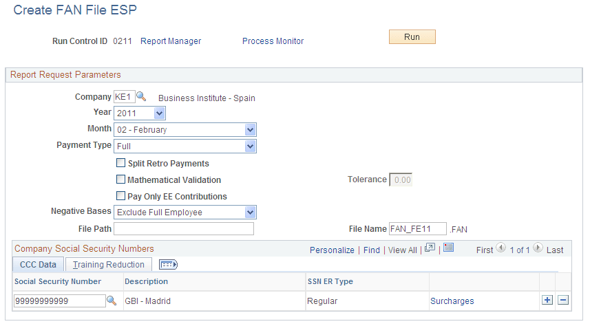

Create FAN File ESP Page
GPES_RC_SS_TC2
Enter the data that is needed to create the FAN file that is submitted to the social security agency.

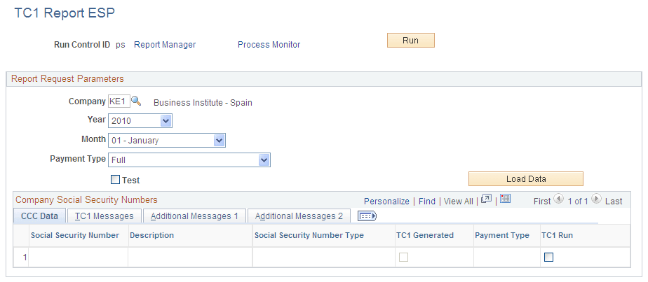

TC1 Report ESP Page
GPES_RC_SS1
Enter the data that is needed to process TCs.

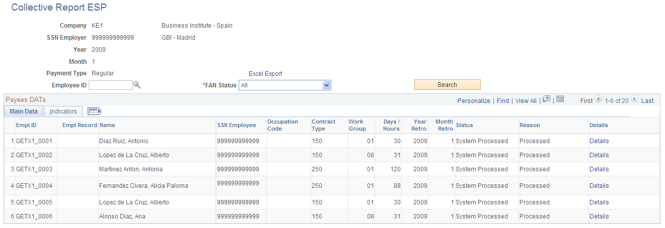

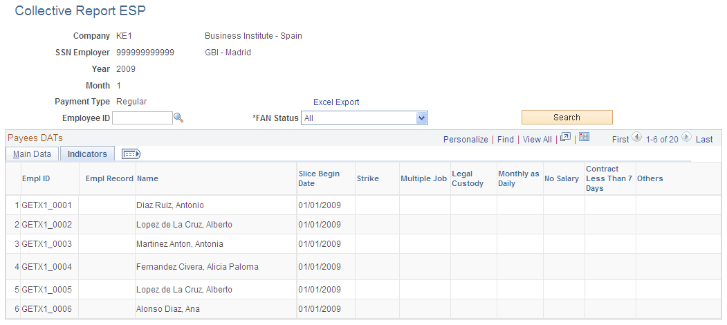

Collective Report ESP Page
Use the Collective Report ESP page (GPES_SSTC_COL_DAT) to view the social security contribution data that appears in the DAT (data) segment of the FAN file for multiple employees.
You can view data for employees within the social security number of a specific company for a specified month or year and payment type.
Navigation:
Global Payroll & Absence Mgmt, and then Social Security / Insurance, and then Collective Report ESP, and then Collective Report ESP
This example illustrates the fields and controls on the Collective Report ESP page. You can find definitions for the fields and controls later on this page.
Search Criteria
Field or Control Description
Empl ID
Enter the employee ID to narrow the search results to a specific employee. This field is available only for the Collective Report ESP page.
Search
Click to retrieve data for persons based on the search criteria. The system displays the data in the Detail of Payees (DAT Segment) grid.
Excel Export
Click to export the data in the Detail of Payees (DAT Segment) grid to an Excel spreadsheet.
Detail of Payees (DAT Segment) - Main Data
Use this grid to review the social security contribution data that appears in the DAT (data) segment of the FAN file for the employees that meet your search criteria. The Main Data tab displays the primary social security contribution information that is relevant to each of the employees. If multiple segments exist for the same employee, the system displays each segment on a different row.
Empl ID
Displays the ID of the person for which the data on a given row relates.
Name
The first and last name of the person.
SSN Employee
The social security number of the person.
Occupation Code
The social security occupational code if the employee's industrial activity is different from the one assigned to the company to which he belongs.
Contract Type
The contract code for social security.
Social Security Work Group
The social security work group.
Days / Hours
The days or hours of social security contributions.
Year Retro
Identifies the year of the recalculated month in case of retro calculation run from the selected month.
Month Retro
Identifies the recalculated month in case of a retro calculation from the selected month. For example, if you run a retro calculation in May for January, the system calculates delta contributions for January through April and displays this information on this page when filtering data by May. This field identifies the month to which the contributions belong.
Details
Click to access the Collective Report ESP - Details page, where you can view details of social security contributions for the selected employee.
Detail of Payees (DAT Segment) - Indicators
Use the Indicators tab of this grid to view additional employee information that appears in special situations on the DAT segment of the FAN file.
This example illustrates the fields and controls on the Collective Report ESP page: Indicators tab. You can find definitions for the fields and controls later on this page.
Strike
Indicates whether the period has been affected by a strike.
Multiple Job
Indicates that the employee has multiple jobs.
Legal Custody
Indicates that an absence or work schedule reduction exists due to child care (maternity, paternity, or legal custody).
Monthly as Daily
Indicates that although the employee has a social security work group that is daily, the employee is contributing as a monthly employee.
No Salary
Indicates that the period is not a paid period.
Contract Less Than 7 Days
A letter C in this column indicates that a surcharge was added because the employee had a contract with a duration of fewer than 7 days. This indicator appears only if the contract was temporary (not regular) and did not have a contract type of 410 or 510 (interim).
Others
Indicates other indicators that are not listed in the grid. Possible values are:
  • I: Deferred IT
  • R: Working reduction due to partial unemployment
  • P: Massive layoff, partial unemployment period
  • T: Massive layoff, unemployment period

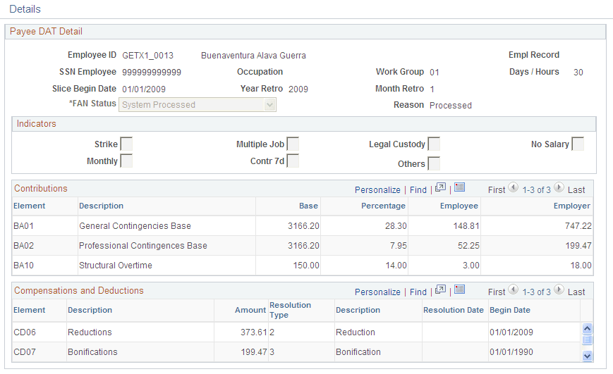

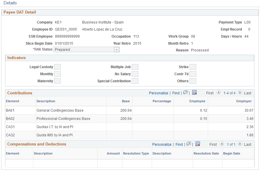

Collective Report ESP - Details Page
Use the Collective Report ESP - Details page (GPES_SSTC_COL_EDL) to view by element the data that appears in the EDL segment of the FAN file.
This data includes the contribution, compensation, and deduction details for the selected employee and specific year.
Navigation:
Global Payroll & Absence Mgmt, and then Social Security / Insurance, and then Collective Report ESP.
Click the Details link.
This example illustrates the fields and controls on the Collective Report ESP: Details page. You can find definitions for the fields and controls later on this page.
Contributions
Element
Displays the element code that appears in the FAN file for the contribution.
Description
The description of the contribution element that appears in the FAN file.
Base
The monetary value of the contribution element.
Percentage
The total contribution percentage that applies to each amount value. This percentage includes both employee and employer contribution percentages.
Employee
The amount that the employee pays for social security contributions for the given element.
Employer
The amount that the employer pays for social security contributions for the given element. Note that contribution amounts for certain elements are the exclusive responsibility of the employer.
Compensations and Deductions
Element
The element code that appears in the FAN file for the compensation or deduction.
Description
The description of the compensation or deduction element that appears in the FAN file.
Amount
The monetary value to subtract from the calculated contributions in order to obtain a net value to pay or appeal to social security.
Resolution Type
The resolution type refers to special situations that require an administrative resolution.
Resolution Date
The initial date for each detailed resolution type that appears in the FAN file.
Begin Date
The initial date for each deduction element.

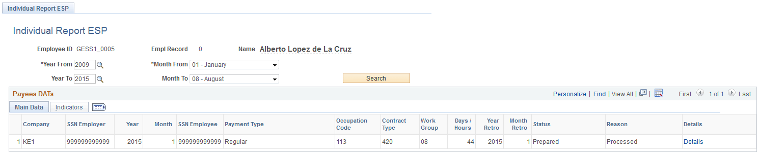

Individual Report ESP Page
Use the Individual Report ESP page (GPES_SSTC_IND_DAT) to view the social security contribution data that appears in the DAT (data) segment of the FAN file for an employee in a specific period.
Navigation:
Global Payroll and Absence Mgmt, and then Social Security / Insurance, and then Individual Report ESP
This example illustrates the fields and controls on the Individual Report ESP page. You can find definitions for the fields and controls later on this page.
Year From and Month From
Select the month and year from which you want to display the information.
Year To and Month To
Select the month and year up to which you want to display the information.
Search
Click this button to view the social security distribution data in the specified period.
Payees DATs
Use this grid to review the social security contribution data that appears in the DAT (data) segment of the FAN file for an employee. The Main Data tab displays the primary social security contribution information relevant to the employee. If multiple segments exist for the same employee, system displays each segment on a different row.
This page is similar to the Collective Report ESP page; the only difference is that this page displays details of a selected employee for a selected period of time. See Collective Report ESP Page topic to know more details about the fields on this page.
Individual Report ESP - Details Page
Use the Individual Report ESP - Details page (GPES_SSTC_IND_EDL) to view by element the data that appears in the DAT segment of the FAN file.
Navigation:
Global Payroll and Absence Mgmt, and then Social Security / Insurance, and then Individual Report ESPClick the Details link
This example illustrates the fields and controls on the Individual Report ESP - Details Page. You can find definitions for the fields and controls later on this page.
This page is very similar to Collective Report ESP - Details page. To know more details about the fields on this page, see Collective Report ESP - Details Page topic.
Use the Create FAN File ESP page (GPES_RC_SS_TC2) to enter the data that is needed to create the FAN file that is submitted to the social security agency.
Navigation:
Global Payroll & Absence Mgmt, and then Social Security/Insurance, and then Create FAN File ESP, and then Create FAN File ESP
This example illustrates the fields and controls on the Create FAN File ESP page. You can find definitions for the fields and controls later on this page.
Company
Enter the company for which the FAN file is created.
Year/Month
Enter the date parameters for the FAN file.
Split Retro Payments
Select to split the FAN file for L03 liquidation month by month.
Note: This is similar to what Social Security requires for L09.
Payment Type
Select the payment type for the report that you want to generate for a specific month for the Employer Social Security numbers that are selected. Values are:
Full: Includes everything that was calculated in the month: regular contributions, contributions due to vacations, litigation salaries, and retroactivity. If you select this value, the Complementary FAN Surcharge % field becomes available.
Litigation Salary: Runs the report for deltas due to the litigation process. This is a legal process for resolving disputes between employers and terminated employees. Until this process is resolved, salary paid to the employee is identified as tramitation salary and employers must indicate in the TC1 report that the contributions are made during the tramitation period.
Regular and Vacations: Includes the regular payroll and the contributions due for vacations that are paid at termination.
Retroactivity w/Surcharge: Runs the report for the deltas detected in previous months due to retroactivity, and includes a surcharge. If you select this value, the Complementary FAN Surcharge % field becomes available and required.
Retroactivity wo/Surcharge: Runs the report for the deltas detected in previous months due to retroactivity, but does not include a surcharge.
Vacations: Include the contributions due for vacations that are paid at termination.
Mathematical Validation
Select if you want the system to perform mathematical validation and update the results based on the value you enter in the Validation Tolerance field.
By default, the payroll process calculates and rounds to two decimal places for the contribution bases, employer contributions, and employee contributions for each employee. The FAN file generation process sums each base for all employees and sums each contribution for all employees separately. This calculation does not always match the result of multiplying the base by its contribution percentage and then rounding the final result to two decimal places. Mathematical validation enables you to check the FAN file records EDTCA01, EDTCA02, EDTCA11, EDTCA50, EDTCA57, EDTBA10 and EDTBA11 for total contribution aggregated amounts. If you select the Mathematical Validation check box and there is a delta between the sum of the employee/employer contributions and the result of multiplying the base by the contribution percentage is higher than the validation tolerance you specify, the system issues a warning message and overrides the aggregated contribution amount with the one calculated in FAN file.
Pay Only EE Contributions
Select to print only employee contributions in the FAN file.
Enter the amount that you want the system to consider as maximum tolerance for mathematical validation. This field accepts values greater than or equal to 0, but it represents an absolute value.
File Path
Enter the directory in which to store the FAN file.
File Name
Enter the file name to be sent to Social Security. The file name needs to comply with the legal requirements. The file naming requirements state that the file extension must be .FAN and the file name must have 8 characters. The system will check whether the file name follows the naming conventions, and show an error message if it's not named correctly.
Social Security Numbers to Process: CCC Data Tab
Enter a Employer Social Security number (Codigo Cuenta Cotizacion).
Surcharges
Click to access the FAN Payment Surcharges page for a Employer Social Security number.

TC1 Report ESP Page
Use the TC1 Report ESP page (GPES_RC_SS1) to enter the data that is needed to process TCs.
Navigation:
Global Payroll & Absence Mgmt, and then Social Security/Insurance, and then TC1 Report ESP, and then TC1 Report ESP
This example illustrates the fields and controls on the TC1 Report ESP page. You can find definitions for the fields and controls later on this page.
TC1 Report ESP page
Report Request Parameters
Company
Enter the company for which the TC1 report is created.
Year/Month
Enter the date parameters for the TC1 report.
Payment Type
Select the payment type.
Note: This field is the same as the Payment Type field defined on the Create FAN File ESP page.
See Create FAN File ESP Page.
Test
Select to run the report in test mode. When you select this check box, the report is printed and columns are completed with XXXX to show that it is a test.
Load Data
Click to retrieve the Social Security numbers for the selected company.
CCC Data Tab
The system populates this group box when you click the Load Data button.
Company Social Security Number
Displays the employer's Social Security number that was assigned to the establishment on the Establishment Address page.
Social Security Number Type
Defines the contract type for the selected Social Security number and can be one of these values: Regular, Trainee, or Apprentice. The social security number type is assigned to the establishment on the Establishment Address page in PeopleSoft HR.
TC1 Generated
The system automatically selects this check box if you already ran the TC1 report for the Social Security number.
Payment Type
Displays the payment type for the social security number.
TC1 Run
Select this check box for each social security number that you want to include in the report for the specified month.
TC1 Messages Tab, Additional Messages 1 Tab, and Additional Messages 2 Tab
Access the TC1 Messages, Additional Messages 1, and Additional Messages 2 tabs.
Report Date
Enter the reporting date of the TC1 report. The default value for this field is the last day of the month following the month and year you select in the Year/Month fields.
Line 1, Line 2, Line 3, Line 4, Line 5, and Line 6
Enter comments to include in the corresponding fields on the TC1 report.
