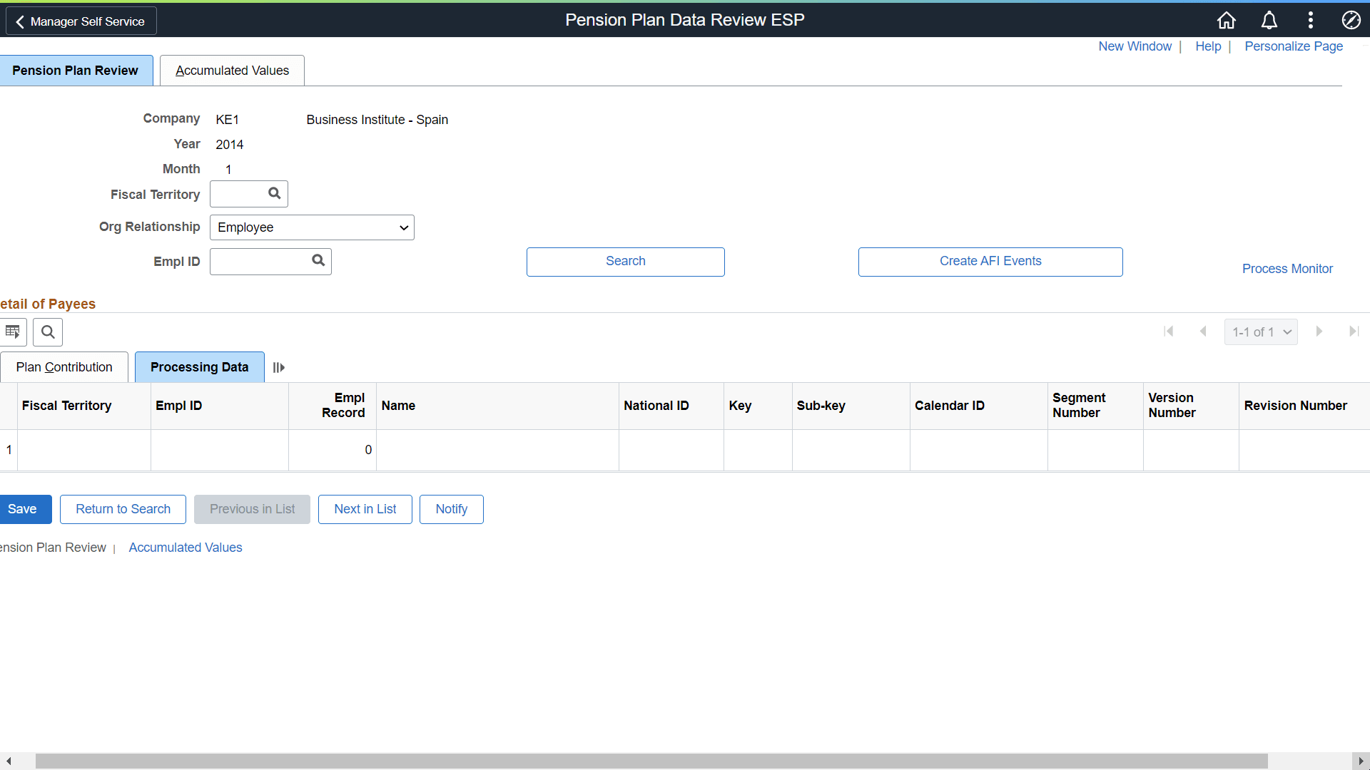

This example illustrates the fields and controls on the Pension Plan Data Review ESP page. You can find definitions for the fields and controls later on this page.
Pension Plan Review page
Pension Plan Review

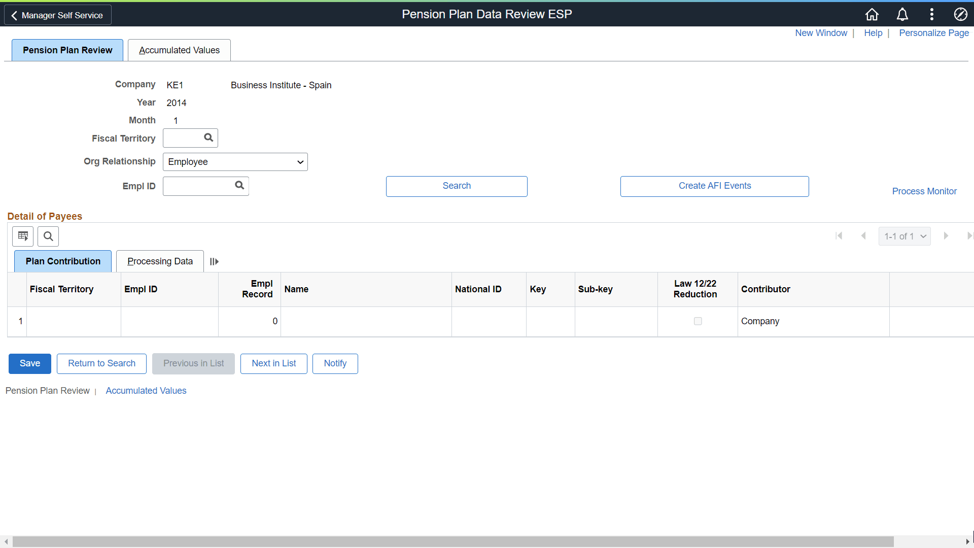

Use the Pension Plan Review tab to review Pension Plan related data for employees.
Plan Contribution
This tab displays the information that the payroll process generates. You are not allowed to edit the information on this tab.
Field or Control Description
Fiscal Territory
The fiscal territory the employee belongs to.
Empl ID (employee ID)
The person for which the data on a given row relates.
Empl Record (employee record number)
The person's employee record number.
Name
The first and last name of the person.
National ID
The national identification number or foreign identification number of the person.
Key and Sub-Key
The perception key and subkey that identifies the person's work relationship with the company. If a person has more than one combination of key and subkey, the system displays a separate row for each combination. You define keys and subkeys on the Perception Keys ESP page.
Law 12/22 Reduction
This check box identifies if the income corresponds to Pension Plan employer’s contribution that is eligible for the Reduction as specifies in the law 12/22.
Contributor
This field is used to identify whether the company or the employee is contributing to the employee's pension plan.
Amount
The amount corresponding to the Pension Plan contribution.
Processing Data
This tab displays the information corresponding to the payroll that calculates the pension plan contributions.
This example illustrates the fields and controls on the Processing Data tab.

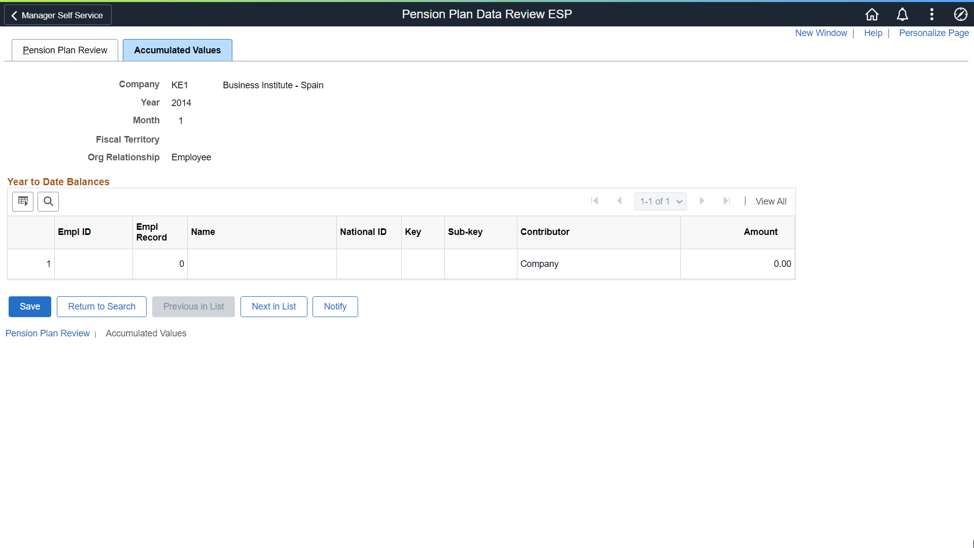

Accumulated Values
This page displays the year-to-date amounts for the pension plan contributions.
This example illustrates the fields and controls on the Accumulated Values page.

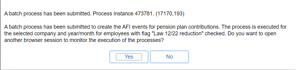

  1. Click the Create AFI Events button in the Pension Plan Review page. This displays the following message:
    AFI Event Message
    AFI message
  2. Click Yes to proceed.

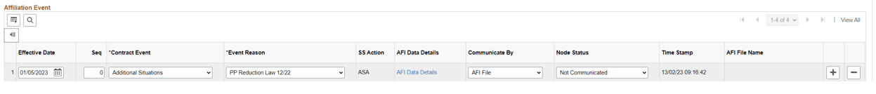

Once the process ends, then the user will have available through Update Contracts ESP, the AFI events (ASA action, type 439) needed to perform the required reporting to Social Security.
Affiliation Event
Affiliation Event
