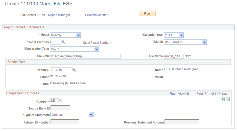

Create 111/110 Model File ESP Page
Use the Create 111/110 Model File ESP page (GPES_RC_TAX_111) to select the parameters with which the system generates the Model 111 or Model 110 report.
Use the Tax Process page to establish the reported elements.
Navigation:
Global Payroll & Absence Mgmt, and then Taxes, and then Create 111/110 Model File ESP, and then Create 111/110 Model File ESP
This example illustrates the fields and controls on the Create 111/110 Model File ESP page. You can find definitions for the fields and controls later on this page.
Only fields that are unique to the Model 111/110 report are discussed here.
Fields common to all tax reports are defined in Common Elements Used to Run Legal Reports.
For the state territory, the process generates a flat file that you can electronically import into the official program provided by the tax authorities. For historical territories, the process generates a free format file that contains a readable summary of the information that you need to report. You can then use this file as a reference when entering reporting data on the official website of the historical territory. The file name that the process generates for historical territories is the file name that you specify plus the letter S at the end.
Report Request Parameters
Field or Control Description
Model
Select the report that you want to run: Monthly or Quarterly. Your selection determines whether the system displays a Quarter or Month field.
Fiscal Territory
Select the fiscal territory for which you are generating the model file. The system prompts you to select from the available tax locations. Based on your selection, the process properly formats the files that it generates for the state or historical territory.
Note: If you select the HFA (Alava Fiscal Territory) value in this field, the Sender Data group box contains the fields Company, Description, and Fiscal Code.
Month
This field appears if you select Monthly. Select the year and reporting month.
Quarter
This field is appears if you select Quarterly. Select the year and the quarter for the report.
Declaration Type
Select the declaration type of the report for the state territory.
Values are:
  • Direct Debit: Select when the payment is by direct debit from a customer account.
    When you select this value, the Source Bank field becomes available.
  • Negative: Select when the reported amount is a negative value.
  • Pay In: Select when the payment will be done through deposit.
  • Tax Agency Account: Select when the payment is by bank transfer to a Tax Agency account.
Sender Data
Enter the ID of the company's primary point of contact in the Person ID field. The populates the other fields in this group box based on your selection.
If you select the HFA (Alava Fiscal Territory) value in the Fiscal territory field, the Company field replaces the Person ID field in this group box. It enables you to enter the company that manages the reporting for other companies. If you enter a value in the Company field, the system also prints the record Type C in the file (Registro del professional).
Companies to Process
Company
Enter the ID of the company for which the report is being submitted.
Source Bank ID
If you selected Direct Debit in the Declaration Type field, enter the company account to which the debit is charged.
Statement Type
Select whether the statement is Ordinary or Complementary. If you select the Complementary value, the Related ID# and Prev.Amount fields become available.
Note: If you select the HFA (Alava Fiscal Territory) value in the Fiscal territory field, the Substitute value becomes available for the Statement Type field. Select to indicate that the file you are generating should replace a previously delivered file related to the same period.
Related ID # (related ID number)
Enter the ID number of the previously reported file if you selected Complementary or Substitute in the Statement Type field.
Prev.Amount (previous amount)
Enter the amount previously liquidated.

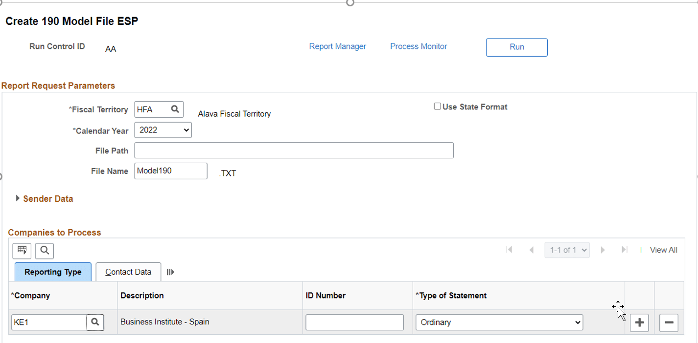

Create 190 Model File ESP Page
Use the Create 190 Model File ESP page (GPES_RC_TAX_190) to select the run control parameters to use to generate the 190 Model report.
Navigation:
Global Payroll & Absence Mgmt, and then Year-End Processing, and then Create 190 Model File ESP, and then Create 190 Model File ESP
This example illustrates the fields and controls on the Create 190 Model File ESP page.
Only fields that are unique to the Model 190 report are discussed here.
The process generates a flat file that you can electronically import into the official program provided by the tax authorities. The process uses different formats for the file depending on the selected fiscal territory.
Fiscal Territory
Note: If you select the HE (State Fiscal Territory) value in this field, the Sender Data group box becomes unavailable.
Calendar Year
Select the calendar year for which you are generating the model file.
Use State Format
In case of Historical territories, user can select to generate the report using the format of the State territory, by selecting the check box.
Sender Data
Companies can manage their own tax reporting or give that responsibility to another company. In cases in which one company is sending information for other companies, use this group box to enter contact data for the company that is sending the information. Then use the Contact Data tab in the Companies to Process group box to enter the contact information that is specific to each company. If you are sending data for your own company only, leave this group box blank and enter contact information only on the Contact Data tab.
Company
Enter the name of the company that is sending the model file.
Person ID
Enter the ID of the person who is sending the model file.
Name and Phone
Enter the name and contact phone number of the person who is sending the model file. The system displays these values when you select the person ID.
Companies to Process - Reporting Type
Company
Select the companies for which you are sending the model file. The process creates a report for each company that you specify.
Description
The system displays the name of the selected company.
ID Number
Enables you to manually enter the Número Identificativo de la Declaración for the report.
Type of Statement
Select the type of model statement that you want to generate. Values are:
  • Ordinary: Process all employees for the selected calendar year.
  • Complement: Process specific employees who were not included in the processing of the ordinary statement. The system displays an Employees link to select the specific employees to process, and a Related ID field to enter the ID of the related model file previously generated through ordinary processing.
  • Substitute: Generate a substitute model file to replace a previously generated file. Use this option when new information is available to send for employees of a previously generated file. The system displays a Related ID Number field to enter the ID of the related model file previously generated.
Related ID Number
The system displays this field when the statement type is either complement or substitute. Enter the ID of the previously generated model file that you want to complement with more employees or substitute with new data.
Employees
Click to access the Complementary File Selection page, where you can select the employees whom the system will process. The system displays this link only if you select to process a complementary type of statement. When your system displays the Complementary File Selection page, use the EmplID field to select the employees whom you want to include in the model file. The system enables you to select only the employees who are in the related reporting table for the selected year.
Companies to Process - Contact Data
Use this tab to enter the contact information for each of the companies for which you are sending the model file.
Employee ID
Enter the ID of the person who is the contact for the model file at the company.
Contact Name
Enter the name of the person who is the contact for the model file at the company.
Contact Phone
Enter the contact phone number of the person who is the contact for the model file at the company.
