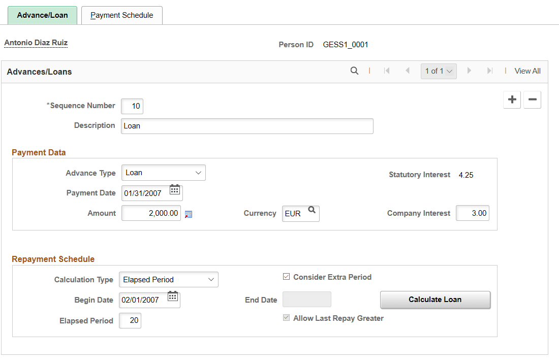

Use the Advance/Loan page to enter details of an employee's loan or advance, and the system displays the employee's repayments on the Payment Schedule page.
Advance/Loan Page
Use the Advance/Loan page (GPES_ADV_LOAN) to record the details of a loan or advance payment made to an employee.
Navigation:
Global Payroll & Absence Mgmt, and then Payee Data, and then Loans, and then Request Advances/Loans ESP, and then Advance/Loan
This example illustrates the fields and controls on the Advance/Loan page. You can find definitions for the fields and controls later on this page.
Advance/Loan page
Advances/Loans
Field or Control Description
Sequence number
Enter a sequence number for the advance/loan. (This number helps prevent duplicate key conditions; it does not control the processing sequence.)
Payment Data
Advance Type
Select the advance type that the employee is going to receive: Advance or Loan.
Statutory Interest
This field appears for loans only. The system displays the statutory interest rate that you defined on the Statutory Rates page.
Payment Date
Enter the date when the loan or advance is to be paid to the employee. The system generates an earning amount for the corresponding payroll period.
Note: If this field is left blank, the assumption is that the payment will be made in cash. The system does not generate the earning and pay it through payroll processing.
Amount
Enter the amount of the loan or advance.
Company Interest
This field appears for loans only. Enter the interest rate that applies to the loan from the employer.
Repayment Schedule
Calculation Type
Select a calculation type to determine the payment schedule. Values are:
Elapsed Period: Select if you want the system to calculate the end date and repayment amount for you, according to the number of periods that you specify in the Elapsed Period field. The End Date field becomes unavailable for edit.
End Date: Select if you want to specify the end date of the loan repayments. The Elapsed Period field becomes unavailable for edit.
Flat Amount: Select if you want to specify the flat amount that the employee is to repay each pay period. The system automatically calculates the number of repayment periods. The system displays the Repayment field instead of the Elapsed Period field. The End Date field becomes unavailable for edit.
Note: If you select the advance type Advance, the system automatically sets the calculation type to Elapsed Period.
Consider Extra Period
Select if you want the calculation to include extra period payments.
Begin Date
Enter the date when the employee begins making the loan or advance repayments.
For extra period advances, the begin date must fall within the extra period in which the repayment will be made.
End Date
Enter the date when the loan or advance repayments are due to end. (You can enter a value in this field only when you select End Date as the calculation type.)
Note: The system generates payments between the begin and end dates and calculates the necessary amount to be deducted.
Elapsed Period
Enter the number of pay periods over which the employee is to repay the loan. You can enter a value in this field only when you select Elapsed Period as the calculation type.
The system automatically calculates the end date for you. For example, if you enter the elapsed period as 13, the system calculates the end date as 13 pay periods after the begin date that you entered and the amount to repay.
Note: If you select the advance type Advance, the system automatically sets Elapsed Period to 1. This is because advances must be repaid in full in the next pay period.
Repayment
Enter the monthly loan repayment amount that the employee has requested to pay. This amount includes the principal amount of the loan and the interest payment. You can enter a value in this field only when you select Flat Amount as the calculation type.
Allow Last Repay Greater
Select to include any loan remainder less than the monthly repayment amount as part of the last scheduled payment. For example, if you assign a loan amount of 3500 EUR to a payee, with a Repayment value of 1000 EUR, the system would schedule three payments of 1000 EUR and one final payment of 500 EUR to repay the loan if the Allow Last Repay Greater check box were deselected. With the check box selected, the system would schedule two payments of 1000 EUR and one final payment of 1500 EUR.
This field is available only if you select Flat Amount as the calculation type.
Calculate Loan
This button appears for loans only. Click this button to automatically calculate the loan. The system checks the employee's labor agreement and takes into account the number of extra pay periods to which the employee is entitled.

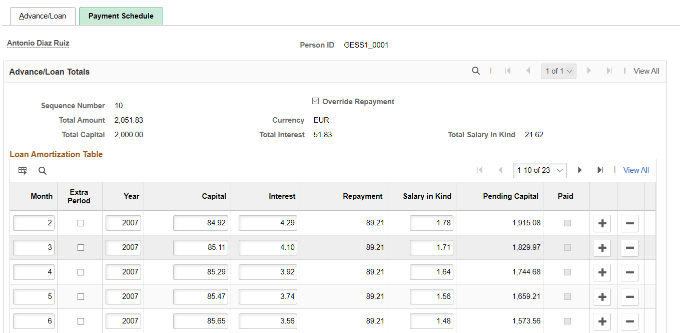

Payment Schedule Page
Use the Payment Schedule page (GPES_ADVLOAN_SCHED) to view the status of an employee's loan or advance, as well as the repayments that he or she have made.
The page displays the original amount of the loan and advance, the remaining amount to be repaid, and the loan amortization schedule.
Navigation:
Global Payroll & Absence Mgmt, and then Payee Data, and then Loans, and then Request Advances/Loans ESP, and then Payment Schedule
This example illustrates the fields and controls on the Payment Schedule page. You can find definitions for the fields and controls later on this page.
Advance/Loan Totals
Sequence Number
Displays the sequence number that you entered on the Advance/Loan page.
Override Repayment
Select to make the fields in the Loan Amortization Table group box editable. This check box is available only for loans, not advances.
Note: If you modify or delete existing repayment rows or add new repayment rows, you must manually calculate the corresponding values in the Interest and Salary In Kind columns that correspond to the amounts in the Capital columns. You must ensure that the sum of the amounts of the fields in the Capital column is equal to the value displayed in the Total Capital field. If it is not, you receive an error when you try to save the component. In addition, be aware that a change to an existing repayment row generates a retro trigger for the corresponding month.
Total Amount
Displays the total amount of the loan or advance, including interest, that was made to the employee. If an employee has several loans, the system displays the details of each loan and the total loan amount, and automatically calculates the remaining loan amount to be repaid.
Total Capital
Displays the sum of the values of the fields in the Capital column of the Loan Amortization Table group grid.
Total Interest
Displays the sum of the values of the fields in the Interest column of the Loan Amortization Table group grid.
Total Salary in Kind
Displays the sum of the values of the fields in the Salary in Kind column of the Loan Amortization Table group grid.
Month
Displays the month in which repayments must be made and wether they have been paid. If you selected 04/01/2004 as the begin date on the Advance/Loan page, for example, the system displays 4 as the first repayment. In other words, the first repayment is due in April, the fourth month of the year.
Extra Period
The system selects this check box automatically if a repayment is to be made in an extra pay period.
Year
The system automatically enters the year in which the repayment was paid.
Capital
Displays the capital amount of the loan repayment that the employee has to pay. This amount does not include the interest payment for the loan.
Interest
The system automatically calculates the interest payment that applies to the loan.
Repayment
The system automatically calculates the total loan or advance repayment for that month. This amount comprises the capital and the interest payments.
Salary in Kind
The system automatically calculates the difference between the cost of the loan at the statutory interest rate, and the interest rate that you defined on the Advance/Loan page. This information is used for tax purposes.
Paid
The system selects this check box automatically when a loan or advance amount has been repaid.
