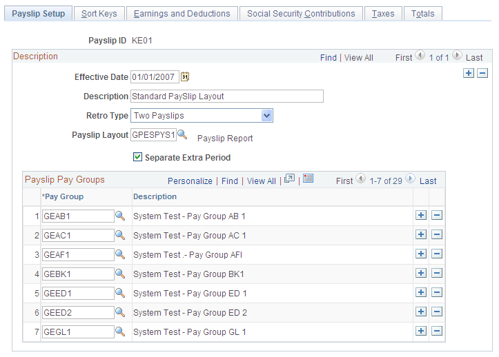

Payslip Setup Page
Use the Payslip Setup page (GPES_PSLIP_GRP) to set up a new payslip for the pay groups that you select.
This includes defining how retroactivity and extra periods are managed and selecting the SQR report (Structured Query Report) that defines the layout of the payslip.
Navigation:
Set Up HCM, and then Product Related, and then Global Payroll & Absence Mgmt, and then Payslips, and then Templates ESP, and then Payslip Setup
This example illustrates the fields and controls on the Payslip Setup page. You can find definitions for the fields and controls later on this page.
Payslip Setup page
Field or Control Description
Retro Type
Select from these values:
Multiple Payslips to generate a payslip for regular pay and separate payslips for each month that has retroactive pay.
Two Payslips to generate one payslip for regular pay and a second payslip that groups together all retroactive pay, if applicable.
Single Payslip to generate one payslip that includes both regular pay and any retroactive pay.
Payslip Layout
Select the SQR report that defines the layout of the payslip. The SQR report defines features of the layout such as lines and colors printed on the payslip. Oracle supplies sample SQR reports that you need to modify for your organization.
Separate Extra Period
Select to generate separate payslips for extra period payments. If you deselect this check box, the system includes extra period payments in the same payslip as regular pay, provided that the extra period and regular payroll are part of the same calendar group.
Pay Group
Select the pay groups that should receive the payslip.

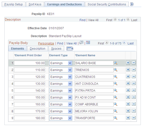

Earnings and Deductions Page
Use the Earnings and Deductions page (GPES_PAYSLIP_LINES) to select the earnings and deductions to display on the payslip and define the spacing between earnings and deductions printed on the payslip.
Navigation:
Set Up HCM, and then Product Related, and then Global Payroll & Absence Mgmt, and then Payslips, and then Templates ESP, and then Earnings and Deductions
This example illustrates the fields and controls on the Earnings and Deductions page. You can find definitions for the fields and controls later on this page.
The fields on this page are discussed in the below topic.
See Common Elements Used to Setup Payslips.

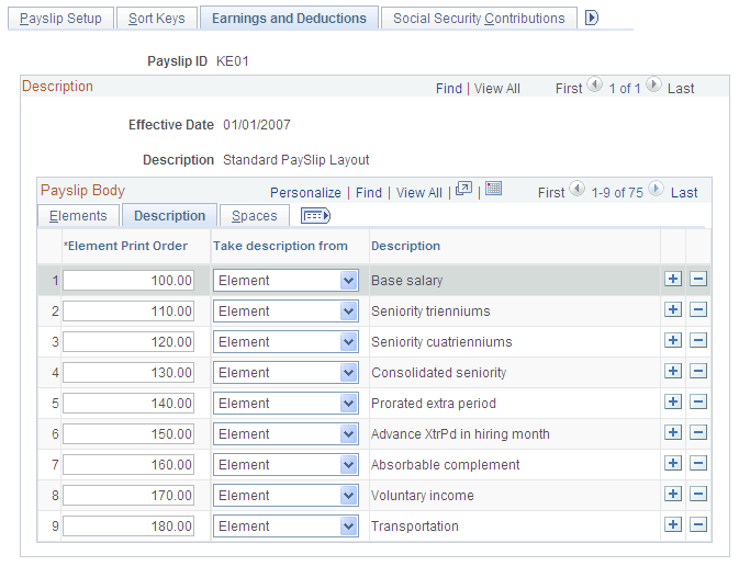

Earnings and Deductions Page: Description Tab
Access the Earnings and Deductions page: Description tab.
This example illustrates the fields and controls on the Earnings and Deductions page: Description tab. You can find definitions for the fields and controls later on this page.

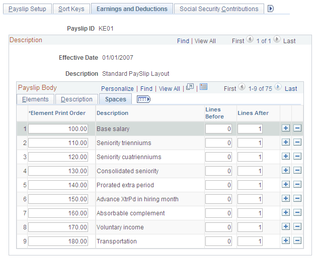

Earnings and Deductions Page: Spaces Tab
Access the Earnings and Deductions page: Spaces tab.
This example illustrates the fields and controls on the Earnings and Deductions page: Spaces tab. You can find definitions for the fields and controls later on this page.

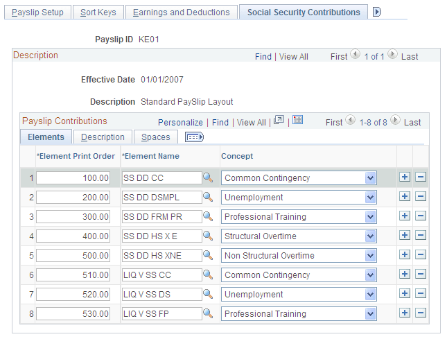

Social Security Contributions Page
Use the Social Security Contributions page (GPES_PAYSLIP_APORT) to select the social security contributions to display on the payslip and define the spacing between the contributions printed on the payslip.
Navigation:
Set Up HCM, and then Product Related, and then Global Payroll & Absence Mgmt, and then Payslips, and then Templates ESP, and then Social Security Contribution
This example illustrates the fields and controls on the Social Security Contributions page. You can find definitions for the fields and controls later on this page.
Most of the fields on this page are discussed in the below topic.
Concept
Select the contribution type that is associated with the element. Values are: Common Contingency, FOGASA, Nonstructural Overtime, Permanent Disability D&S, Professional Training, Structural Overtime, Temporary Disability,and Unemployment.

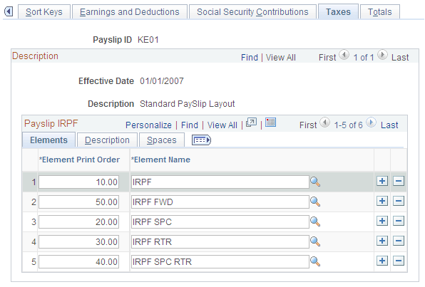

Taxes Page
Use the Taxes page (GPES_PAYSLIP_IRPF) to select the tax deductions to display on the payslip and define the spacing between the taxes printed on the payslip.
Navigation:
Set Up HCM, and then Product Related, and then Global Payroll & Absence Mgmt, and then Payslips, and then Templates ESP, and then Taxes
This example illustrates the fields and controls on the Taxes page. You can find definitions for the fields and controls later on this page.
Taxes page

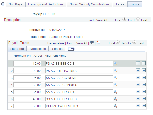

Totals Page
Use the Totals page (GPES_PAYSLIP_TOTAL) to select the accumulators to print at the bottom of the payslip and define the spacing between the accumulators printed on the payslip.
Navigation:
Set Up HCM, and then Product Related, and then Global Payroll & Absence Mgmt, and then Payslips, and then Templates ESP, and then Totals
This example illustrates the fields and controls on the Totals page. You can find definitions for the fields and controls later on this page.
Totals page
