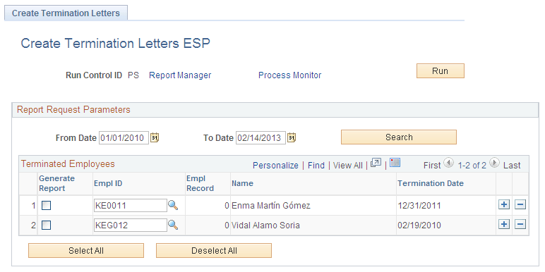

Create Termination Letters Page
GPES_RC_FNQ2
Run the Create Termination Letters report (GPESFNQ2) that generates a termination letter for the employees listed.

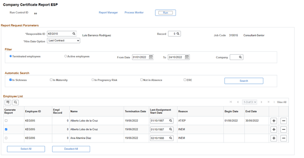

Company Certificate Report ESP Page
Use the Company Certificate Report ESP page (GPES_RC_FNQ1) to run the Company Certificate (GPESFNQ1) report.
This report shows the monthly social security contributions for the last 180 days. This report is sent to the government unemployment office to calculate the unemployment benefit.
Navigation:
Global Payroll & Absence Mgmt, and then Termination Processing, and then Company Certificate Report ESP, and then Company Certificate Report ESP
This example illustrates the fields and controls on the Company Certificate Report ESP page.

Filter
Field or Control Description
Terminated employees
Select to generate the report for terminated employees.
Note: When you select this option, the system generates the report in both PDF and XML format.
Active employees
Select to generate the report for active employees.
From Date, To
Select the period for which you wish to search for employees.
In the case of terminated employees, the system will search for those whose termination date falls within the period.
For active employees with any absence option selected, the system will look for employees with absence begin dates falling within the period.
Prior to Image#45, the system searched for active employees with absences at 'As of date' for those with absences.
Currently, ‘As of date’ feature is not supported in PeopleSoft.
Company
Enter the ID of the company you want to filter. System will search for employees belonging to that company. If this field is left blank, system will search for all the employees independently of the company they belong to.
Hire Date Option
Select how the system determines the starting date of the periods to be included in the report for each selected employee. Options are:
  • First Hire: The system includes all employment periods beginning with the employees' first hire date.
  • Last Contract: The system includes only the data associated with the employees' last contract number.
  • Last Rehire: The system includes all employment periods beginning with the employees' the last rehire date.
You can use this group box to filter for either terminated or active employees, not both.
Automatic Search
The fields in this group box enable to you search for employees that meet certain criteria. The employees that the search retrieves depends on the selections you made in the Filter group box. The following table lists the possible search results:
Filter Selection Automatic Search Selection Search Results
In Sickness
Retrieves terminated employees in the entered period and with IT or AT/EP absence events occurring at the time of termination.
Maternity
Retrieves terminated employees in the entered period and with a maternity or paternity absence event occurring at the time of termination.
In Pregnancy Risk
Retrieves terminated employees in the entered period and with an in pregnancy or lactancy risk absence event occurring at the time of termination.
Not in Absence
Retrieves terminated employees in the entered period who were healthy at the time of termination.
Note: This is also the combination of filter and automatic search selections that you would typically use when generating a company certificate report for employees affected by permanent ERE.
See PeopleSoft Human Resources Administer Workforce: Completing the ERE Procedure.
ERE
Retrieves employees in the entered period who are also affected by temporary ERE (suspension or work schedule reduction).
Note: This combination of filter and automatic search selections represents an unusual case and would not typically be used.
Active employees
In Sickness
Retrieves active employees who had an IT or AT/EP absence event with begin date falling into the range of dates being selected.
Active employees
Maternity
Retrieves active employees who had a maternity or paternity absence event with begin date falling into the range of dates being selected.
Active employees
In Pregnancy Risk
Retrieves active employees who had an in pregnancy or lactancy risk absence event with begin date falling into the range of dates being selected.
Active employees
Not in Absence
Retrieves active employees who were healthy on the selected period.
Active employees
ERE
Retrieves active employees who are affected by temporary ERE (suspension or work schedule reduction) with begin date falling into the range of dates being selected.
Search
Click to search employees using the specified criteria.
Employee List
The system displays the employees that match the search criteria in this group box, assigning by default the report that corresponds to their situations. This page, however, provides some flexibility when selecting the report to be printed for each employee. If you want to run a different report than the one that the system automatically selects, you can add a new row for the employee and select the desired report. The available options are:
  • The reports that match the status of the employee.
  • The Company Certificate report (INEM).
  • The Company Certificate report on demand (INSS).
Generate Report
Select next to the employees for which you want to run the report.
Employee ID
Enter the ID for the employee for which you want to run the report. The system displays the employee name.
Note: The system allows you to enter the ID of employees who match the criteria you specify in the Filter group box.
If you use the Automatic Search group box to search for employees, the system populates this field automatically, and you cannot edit it.
Employment Record Number
Select the employee record number for which you want to run the report.
Termination Date
This field appears only if you select the Terminated employees option in the Filter group box. The system populates this field automatically with the termination date for the selected employee, and you cannot edit it.
As Of Date
Enter the date on which you want the system to base the report results. This field is available only if you select the Active employees option in the Filter group box.
If you use the Automatic Search group box to search for employees, the system populates this field automatically, and you cannot edit it. For active employees in absence, this field will be populated with the absence begin date.
Last Assignment Start Date
Use this field to override the starting date determined by the system based on your selection in the Hire Date Option field.
Reason
Enter the reason for the report generation. This reason determines the type of report that the system generates.
Values are:
  • AT/EP (Accidentes de Trabajo y Enfermedades Professionales): Results in the generation of the Company Certificate report for temporary disability.
    Note: This report includes termination information for terminated payees.
  • INEM (Instituto Nacional del Empleo): Results in the generation of the INEM Company Certificate report.
  • INSS (Instituto Nacional de la Seguridad Social): Results in the generation of the INSS Company Certificate report.
  • IT (Incapacidad Temporal): Results in the generation of the Company Certificate report for temporary disability.
  • In Maternity: Results in the generation of the Company Certificate report for maternity or paternity.
  • In Pregnancy Risk: Results in the generation of the Company Certificate report for risk during pregnancy or lactancy.
Use the Create Termination Letters page (GPES_RC_FNQ2) to run the Create Termination Letters report (GPESFNQ2) that generates a termination letter for the employees listed.
Navigation:
Global Payroll & Absence Mgmt, and then Termination Processing, and then Create Termination Letters ESP, and then Create Termination Letters ESP
This example illustrates the fields and controls on the Create Termination Letters page. You can find definitions for the fields and controls later on this page.
From Date and To Date
Enter a date range within which you want to search for terminated payees.
Search
Click to search for payees that were terminated within the date range you specified.
Generate Report
Select next to the payees for which you want to generate termination letters.
Empl ID (employee ID)
Enter the ID of the employee for whom a termination letter will be created.
Select All
Click to select the Generate Report check box next to all payees listed in the Terminated Employees group box.
Deselect All
Click to deselect the Generate Report check box next to all payees listed in the Terminated Employees group box.
