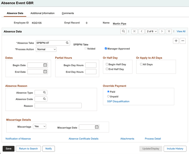

Absence Data Page
Use the Absence Data page (GPGB_ABS_EVENT_1) to record general information about an employee's absence from work.
Use this page to record the absence take and the absence begin and end date.
Navigation:
Global Payroll & Absence Mgmt, and then Payee Data, and then Maintain Absences, and then Absence Event GBR, and then Absence Data
absence event gbr
Some of the fields on this page are identical to those on the Absence Event Entry Detail page. You'll find documentation for these fields in thePeopleSoft Global Payroll product documentation.
Field or Control Description
Absence Take
Select the type of absence that you require. These are the delivered take elements for UK statutory absences:
SSP AT1 for SSP.
SMP AT1 for SMP where the EWC is before April 6, 2003.
SMP AT2 for SMP where the EWC is on or after April 6, 2003.
SPPB AT for SPP (birth).
SPPA AT for SPP (adoption).
SAP AT for SAP.
Begin Date, End Date
Enter the dates of the employee absence. For SPP, employees are entitled to 2 weeks paid leave. If you enter a period spanning more than 2 weeks, only the first 2 weeks are processed as paid absence.
Partial Hours
For the statutory absence takes if you enter any partial hours during an employee's absence, then the absence won't be paid for that day. This applies regardless of the number of hours entered in the Partial Hours field.
Or Half Day
For the statutory absence takes if you select this check box, then the absence won't be paid for that day.
Or Apply to All Days
Absence Type
Select an absence type that you defined on the Absence Reasons GBR page. Absence types are informational only and don't affect statutory absence processing.
Absence Code
Select an absence code that you defined on the Absence Reasons GBR page. Absence codes are informational only and don't affect statutory absence processing.
Reason
Enter an additional reason why an employee was absent from work. Absence reasons are informational only and don't affect statutory absence processing.
Paid, Unpaid
The system sets the payment to Paid. This field doesn't affect the calculation of the statutory absences delivered as part of Global Payroll for the UK. You might want to use this field when setting up your own absence schemes, to determine whether an absence is paid or unpaid.
SSP Disqualification
Click to access the SSP Disqualification Details page.
Notification of Absence
Click to access the Notification of Absence page.
Absence Certificate Details
Click to access the Absence Certificate Details page.
Click to add attachments. An administrator can add, view, modify or delete attachments for the selected employee through Absence Event GBR in support of leave taken by the employee.
Note: The absence takes must be enabled at Maintain Definition component by either selecting all PIN Number or the PIN Number of the desired absence take.
Process Detail
Click to access the Process Details page.
Miscarriage
Select Yes or No to indicate whether the case is a miscarriage.
Miscarriage Date
Enter or select the date of the miscarriage.

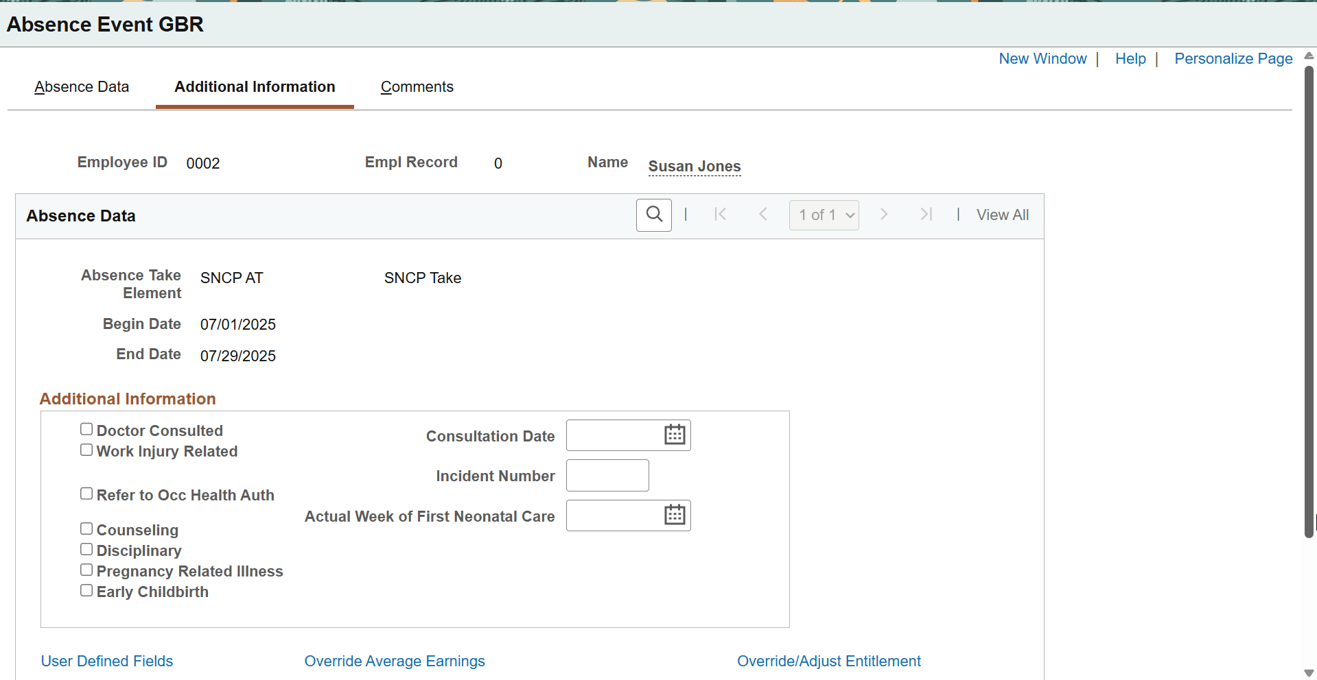

Additional Information Page
Use the Additional Information page (GPGB_ABS_EVENT_2) to record additional information about an employee's absence.
Navigation:
Global Payroll & Absence Mgmt, and then Payee Data, and then Maintain Absences, and then Absence Event GBR, and then Additional Information
This example illustrates the fields and controls on the Additional Information page.
Absence Event GBR page
Doctor Consulted
Select this check box if the employee has consulted his or her doctor.
Consultation Date
Select the date when the employee consulted his or her doctor.
Work Injury Related
Select this check box if it applies to the employee's absence.
Incident Number
Enter the incident number if an employee has a work related injury.
Actual Week of First Neonatal Care
Enter the starting date for the neonatal care.
This field is applicable to employees who do not qualify for statutory absences such as Statutory Maternity Pay (SMP), Statutory Adoption Pay (SAP), or Statutory Paternity Pay (SPP) related to birth and adoption, yet are eligible for neonatal care.
For details on statutory absences, see Understanding Absence Schemes.
Refer to Occ. Health Auth. (refer to occupational health authority), Counselling, Disciplinary
Select the check boxes that apply to the employee's absence.
Pregnancy Related Illness
Select this check box if the employee has an illness related to her pregnancy.
If you select this check box for an SSP absence, when you run the payroll process the system checks whether the absence is within the four week period before the EWC. If it is within this four week period, the system generates a warning and you should instead enter an SMP absence (SMP AT2). According to UK legislation, the MPP starts on the day after the first day of absence with a pregnancy-related illness within four weeks of the EWC.
If the MPP is triggered by a pregnancy-related illness, SMP can start on any day of the week (normally SMP is paid weekly starting with a Sunday start date).
Early Childbirth
Select this check box if the absence is due to early birth of the child.
If the MPP is triggered by an early birth, SMP can start on any day of the week (normally SMP is paid weekly with a Sunday start date).
Note: This check box is for SMP AT2 absences only. It does not apply to SMP AT1. Prior to April 6, 2003, SMP always started on a Sunday.
User Defined Fields
Click to access the User Defined Fields page.
Override/Adjust Entitlement
Click to access the Override/Adjust Entitlement page.
Override Average Earnings
Click to access the Override Average Earnings page.
Birth Dates
Click to access the Birth Dates page. Use this page to enter the EWC and the actual week of child birth. This is required for SMP and SPP (birth).
Adoption Dates
Click to access the Adoption Dates page. Use this page to enter the matching date, which is required for SAP and SPP (adoption).
Override/Adjust Entitlement for Mapped to Scheme
Click to access the Override/Adjust Entitlement for Mapped to Scheme page.

Use the Override Average Earnings page (GPGB_ABS_ERNS_SEC) to override an employee's average earnings.
For statutory absences, the system calculates an employee's average weekly earnings. Employees below the lower earnings limit are not entitled to paid absence. You may need to override an employee's average earnings if the system does not have sufficient earnings history for that employee.
Navigation:
Click the Override Average Earnings link on the Additional Information page.
This example illustrates the fields and controls on the Override Average Earnings page.
Statutory Average Earnings
Enter the amount that you want to apply as the statutory average earnings. For example, if you have a new starter with no earnings, enter the contractual amount that was calculated.
Occupational Average Earnings
Enter the amount that you want to apply as the occupational average earnings.
Note: Because you may require your occupational average earnings to be different from your statutory average earnings, Global Payroll for the UK provides you with two fields. You may use them for OSP schemes where the amount of pay depends on past earnings. For example, a shift worker is usually paid a combination of basic pay and overtime. If that employee is off sick, you can use the Occupational Average Earnings field to enter the employee's overtime payments. This ensures that SSP compensates for both the employee's basic pay and the overtime that he or she would normally have worked.
