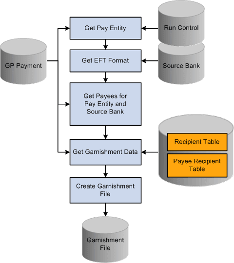

During the garnishment file process, the system performs these steps:
  1. Gets data from the GP_PAYMENT table.
  2. Runs the CTX EFT process.
  3. Creates a CTX001.txt file.
If you select data that includes multiple source banks, multiple CTX files are created, one CTX file for each source bank. The CTX files are named CTX001.TXT, CTX002.TXT, and so forth.
A transmittal report for child support garnishment payments is automatically generated after the CTX file process. After the CTX file is successfully generated, the transmittal report is created based on the data selected from the Create Garnishment File USA page.
This diagram shows the garnishment file process:
This diagram shows the garnishment file process.
Garnishment file process
