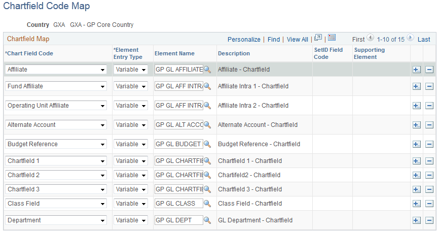

Chartfield Code Map Page
Use the Chartfield Code Map page (GP_CHART_ELEM) to map standard GL chartfields that are defined in payroll to chartfield variables that are defined in Global Payroll.
Navigation:
Set Up HCM, and then Product Related, and then Global Payroll & Absence Mgmt, and then Integration, and then Define Chartfield Code Mapping, and then Chartfield Code Map
This example illustrates the fields and controls on the Chartfield Code Map page.
Global Payroll delivers variables to represent each of the chartfields:
  • GP GL PRODUCT
  • GP GL PROJECT
  • GP GL DEPT
  • GP GL FUND
  • GP GL PROGRAM
  • GP GL CLASS
  • GP GL AFFILIATE
  • GP GL ALT_ACCOUNT
  • GP GL BUDGET_REF
  • GP GL CHARTFIELD1
  • GP GL CHARTFIELD2
  • GP GL CHARTFIELD3
  • GP GL AFF_INTRA1
  • GP GL AFF_INTRA2
  • GP GLBU PC
  • GP GL ACTIVITY
  • GP GL SOURCE TYPE
  • GP GL CATEGORY
  • GP GL SUBCATEGORY
This page enables you to map the PeopleSoft standard configuration chartfields to these delivered chartfield variables. This mapping enables Global Payroll to receive chartfield information for payable time. You can create a separate mapping scheme for each country in which your organization operates.
The system can send a maximum of 21 mapped chartfields to PeopleSoft General Ledger. Therefore, we recommend that you add no more than 21 chartfields to each mapping scheme.
Field or Control Description
Chartfield Code
Enter the GL chartfield to map to a variable.
Element Entry Type
Select the type of element to which the chartfield is mapped. Values are:
Variable: User-created variable. For example, you may decide to rename GP GL CHARTFIELD1 so that the name matches the information contained in the field.
SystemElem (system element): PeopleSoft standard configuration chartfields.
Element Name
Select the name of the variable to which you are mapping the chartfield.
SetID Field Code and Supporting Element
Displays the set ID fields associated with the variable or system element.
