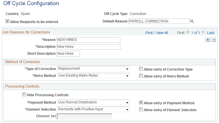

This example illustrates the fields and controls on the Off Cycle Configuration page.

Transaction Type and Reasons
Field or Control Description
Country
Displays the country for which you are configuring the off cycle request page.
Off-Cycle Type
Select the off cycle transaction type for which you want to configure the request page. Values are Additional payment, Advance, Correction, and Manual payment.
Allow Requests to be entered
Select to allow off cycle requests to be entered for specific off cycle types for a specific country. The default is selected. If this check box is deselected, you will not be able to enter any off cycle requests for the type and country that is specified.
Default Reason
Enter a default reason that will populate the off cycle request. This reason can be overridden when the request is being created.
List Reasons for Additional Payments
This section is titled based on the Off Cycle Type that is entered. The titles are List Reasons for Additional Payments, List Reasons for Advance Payments, List Reasons for Corrections, and List Reasons for Manual Checks.
Reason
Enter all valid reasons for the off cycle type that can be entered on the Off Cycle Request page. These reasons will be the only ones that can be entered.
When a new reason is added all the attributes selected are available on the Off Cycle request page.
Description
Enter a description for the reason.
Short Description
Enter a short description for the reason.
Calendar Controls
Hide Calendar Controls
Select to hide all calendar controls on the Off Cycle Request page.
Allow entry of Begin Date
Select to allow a begin date to be entered for an off cycle request.
Allow entry of End Date
Select to allow an end date to be entered for an off cycle request.
Method of Correction
This section is available for entry only when the Off Cycle Type is Correction.
Type of Correction
Select the types of correction that are valid. Values are:
  • Forced Reversal causes the payment or absence calendar to be reversed regardless of whether the system finds the payee still eligible for processing or not.
  • Replacement causes the system to recalculate or remove elements based on whether payee is eligible. This is the same as normal retroactive processing.
Allow entry of Correction Type
Select if you want the user of the off cycle request to be able to enter a correction type.
Retro Method
Select a retro method to use with the type of correction that is selected. Values are Forced Corrective and Use Existing Retro Rules.
Allow entry of Retro Method
Select if you want the user of the off cycle request to be able to enter a retro method.
Processing Controls
Hide Processing Controls
Select to hide all processing controls on the Off Cycle Request page.
Allow entry of Payment Keys
Select if you want the user of the off cycle request to be able to enter payment keys.
Run Type
Enter the run type to use for this off cycle type.
Allow entry of Run Type
Select if you want the user of the off cycle request to be able to enter a run type.
Payment Method
Select the payment method to use for the off cycle type and reason. Values are Cash, Check, Postal Order, Pay Primary Account Only, and Use Normal Distribution.
Allow entry of Payment Method
Select if you want the user of the off cycle request to be able to enter a payment method.
Allow Partial Period Advances
This option is available only when the off cycle type is advance payment. Select if you will advance part of a pay period.
Element Selection
Select the element selection for the off cycle request. Values are All, Elements with Positive Input, and Limited Element Set.
Allow entry of Element Selection
Select if you want the user of the off cycle request to be able to enter an element selection.
Element Set
You can enter a value in this field when the Element Selection value is Limited Element Set. An element set defines (limits) the earnings and deductions found on the process list to process.
