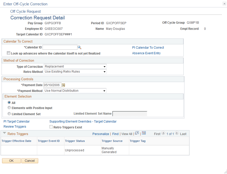

Correction Request Detail Page
Use the Correction Request Detail page (GP_OFFCYCLE_C_SEC) to enter instructions for processing payroll corrections.
Navigation:
Click the Correction Details icon in the Calendars to Correct section of the Off Cycle Request page.
This example illustrates the fields and controls on the Correction Request Detail page.
The fields that are available for entry on this page depend on the configuration settings that were created for this type of off cycle transaction.
This page shot displays the page as it will be presented when no configuration exists.
See Understanding Off Cycle Configurations.
| Field or Control | Description |
Calendar ID |
Select the calendar that needs a correction made to it. |
Look up advances where the calendar itself is not yet finalized |
Select this field in order to select and correct a calendar where the on cycle calendar itself has not yet been finalized, but the calendar has been processed for this payee already as an advance. |
P.I. Calendar to Correct |
Click to access the Positive Input page. |
Absence Event Entry |
Click to access the Absence Event Entry page. |
Type of Correction |
Enter the type of correction. Values are Replacement and Forced Reversal. Note: When processing reversals, you need to void the payment, which you can do using the Review Payments by Cal Group component after banking has been finalized; or for reconciliation purposes on the Manual Payment Reconciliation page. This is not an automatic process. See Understanding Banking, Manual Payment Reconciliation Page. |
Retro Method |
Enter the retro method to use for this correction type. Values are Use Existing Retro Rules and Forced Corrective. |
Payment Date |
The default value comes from the Off Cycle Request page if a value was entered on that page. This date drives the selection of date-effective rules and the allocation of results to the appropriate time period (month-to-date, quarter-to-date and year-to-date balances). |
Payment Method |
Select the payment method for the correction. |
Element Selection |
Select the elements to process for this correction. Note: For a forced reversal correction, element selection is unavailable for entry. |
P.I. Target Calendar |
Supporting Element Overrides – Target Calendar |
Click to access the Payee Calendar SOVR page. |
Review Triggers |
Click to view, edit, and add retroactive triggers. |
Retro Triggers Exist (retroactive triggers exist) |
This system will select this check box if a trigger exists that falls on or before the period end date of the calendar to be corrected, and if the trigger represents the same country as the country associated with the pay group of the off cycle group. If the check box is deselected, you must manually create the trigger or make the correction to data that will cause the trigger to be generated. |
Retro Triggers |
Displays a list of retro triggers associated with the same country as the correction. |
