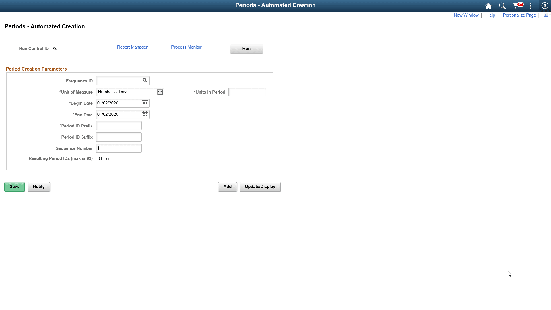

This example illustrates the fields and controls on the Periods - Automated Creation page.
Enter the period creation parameters and click the Run button.
Field or Control Description
Frequency ID
Enter the calendar period frequency. This field can be used to generate the period description.
Note: The system doesn't edit your entry to ensure it's consistent with the values in the Unit of Measure and Units in Period fields.
See Periods Page.
Unit of Measure
Select the unit of measure for the periods.
The Number of Days and Number of Months values, used in conjunction with the Units in Period field determine the number of days or months in a period.
The Semimonthly value represents 15 days. The first semimonthly period always includes days 1 to 15. The second period includes days 16 to 28, 29, 30, or 31, depending on the month. When you select this value, the Units in Period becomes unavailable.
Units in Period
Enter the number of units in each generated period.
Begin Date and End Date
Enter the first day of the first period being generated and the last date through which the system should generate periods.
The system generates all periods for which the end date is before or equal to the end date that you enter.
Period ID Prefix
Enter a prefix of up to seven alphanumeric characters. The system creates a unique period ID for each period it creates, by adding the period frequency suffix and a consecutive sequence number to the prefix.
Period ID Suffix
Enter the period suffix that's added to the period ID. The default value is the first letter of the selected frequency ID.
Sequence Number
Enter for the first period. The system assigns a sequential number to each following period that you create.
This is useful when you create periods for the same year in separate runs. Suppose that you want to generate six periods for a monthly payroll. You enter 1 in this field, and the process creates periods 1 to 6. Later, when you generate periods for the remaining months, you enter 7 here.
Resulting Period IDs (max is 99)
This field combines the period ID prefix, period frequency suffix, and sequence number to show you what periods the process will create. For example, if you enter a period ID prefix of PAY2001, a period frequency suffix of M, and a sequence number of 1, the periods generated are PAY2001M01 - PAY2001Mnn where nn represents the number of the last period created.
