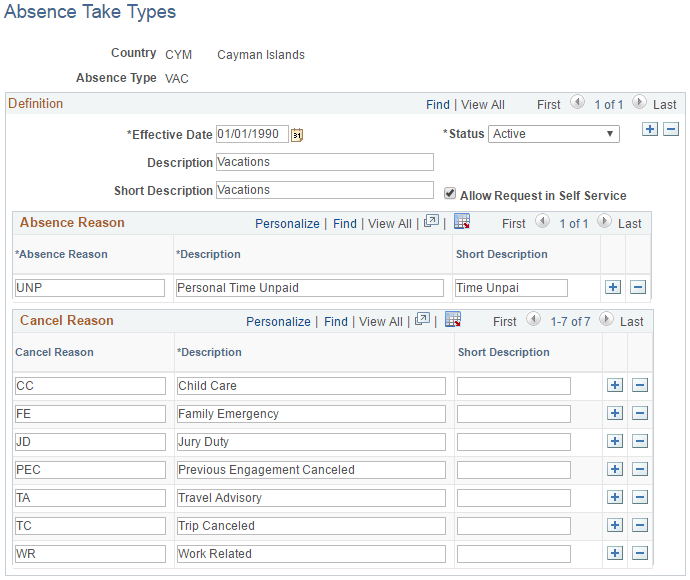

This example illustrates the fields and controls on the Absence Take Types page.
Field or Control Description
Allow Request in Self Service
Selecting this check box enables you to configure all associated take elements for self service absence functionality.
Absence Reason
Enter up to three alphanumeric characters for the Absence Reason code.
Cancel Reason
Use this grid to enter the reasons users can cancel absences associated with the take type. The values that you enter in the Description field appear as values that users can select in the Cancel Reason field on the Cancel Absence self-service pages.
