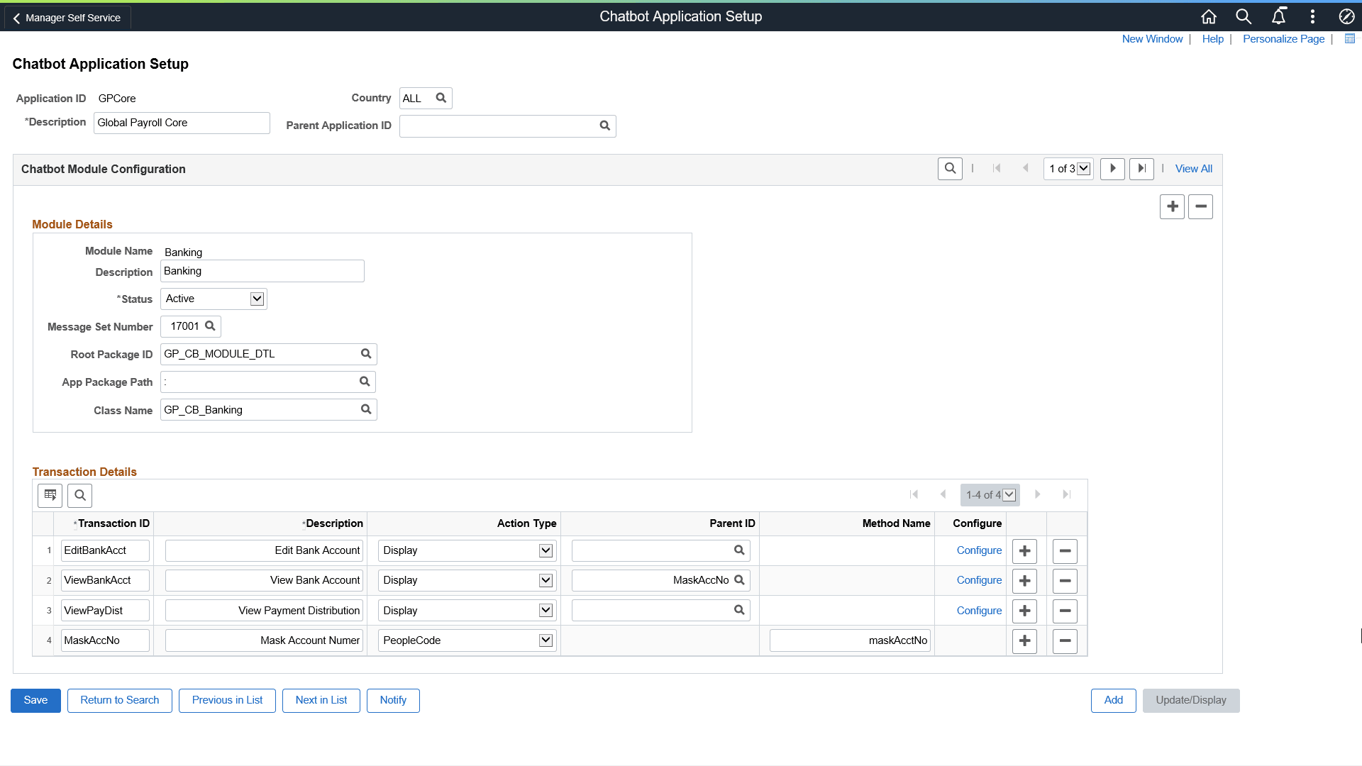

Defining Chatbot Application Setup
To define chatbot using GP Core Chatbot Framework, use the HCB_BOT_APP_SETUP component.
Pages Used to Define Chatbot Application Setup
Chatbot Application Setup Page
HCB_BOT_APP_SETUP
To configure chatbot using the GP Core Chatbot Framework.
Use the Chatbot Application Setup page (HCB_BOT_APP_SETUP) to configure chatbot using the GP Core Chatbot Framework. This setup works in tandem with the Oracle Digital Assistant (ODA) Skill.
Navigation:
Setup HCM, and then Product Related, and then Global Payroll & Absence Mgmt, and then Chatbot Setup, and then Chatbot Application Setup
This example illustrates the fields and controls on the Chatbot Application Setup page for GP Core.
This example illustrates the fields and controls on the Chatbot Application Setup page for a specific country. Here, GP Australia is shown as an example.
Chat Application Setup AUS page.
Field or Control Description
Application ID
Unique ID of the application setup. This should be a meaningful ID that denotes the country; for example, GPUK, GPMEX, etc.
Country
Defines the country where the Application ID belongs.
Description
Meaningful description for the application ID. The description should be used to Identify the application.

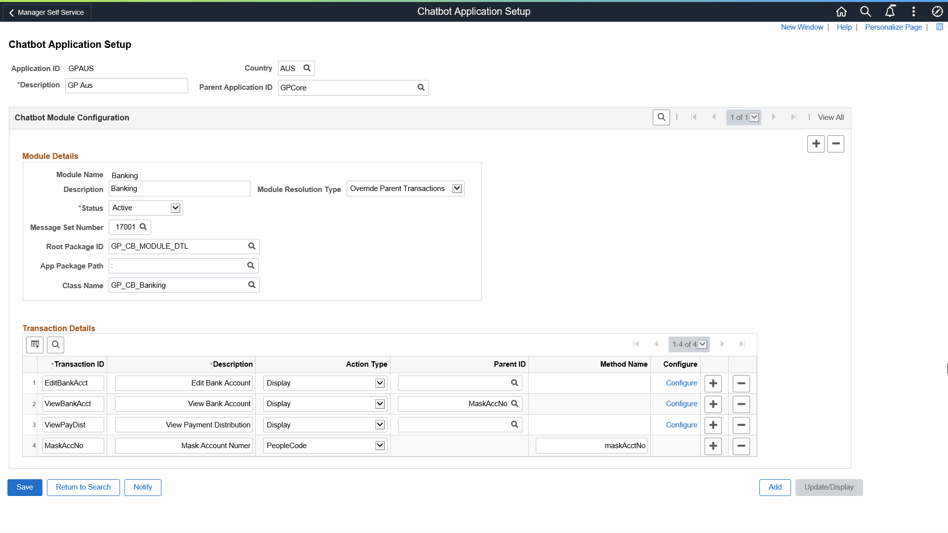

Parent Application ID
Parent Application ID is primarily used to create an application ID which can inherit properties of another already existing application ID. For example, for an Application ID called GP Core, one or more country extensions can have this GP Core Application ID as their Parent Application.
Note: It is recommended for all Country Extensions to use GP Core Application ID as the Parent Application ID. This allows to use the predefined setup for frequent use cases such as payslip, banking inquires and forms.

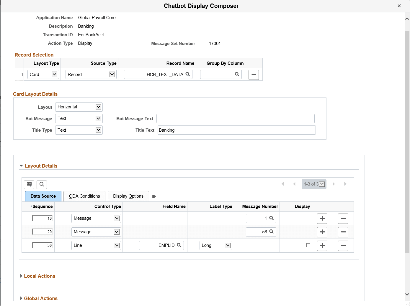

The Configure link opens the Chatbot Display Composer modal window as shown:
This example illustrates the Chatbot Display Composer modal window.
Layout Type
The layout type to be used to display data on the chatbot.
Values in the list are:
  • Card: The Card layout allows to create a Card display on the chatbot. When Card is selected, the page allows you to configure the content with the following sections:
    1. Card Layout Details
    2. Layout Details
    3. Local Actions
    4. Global Actions
  • List: The List layout allows to create a list display on the chatbot. When List is selected, the page allows you to configure the content with the following sections:
    1. Layout Details
    2. Local Actions
    3. Global Actions
Source Type
Specifies from where the data will be extracted.
  • Record: You can specify a record or a view.
  • PS Query: You can specify a PS Query. You can build custom PS Query as per business requirements. For details, see Building PS Query for Global Payroll Assistant section.
Record Name
This field is dependent on the Source Type field. If Source Type is Record, the field title becomes record name and displays only the record values. If Source Type is PS Query, the field title becomes query name and prompts only PS Query.
Group By Column
Used to group data based on the field specified. If Group By Column is selected then all results will be displayed in a single card otherwise they will be displayed in multiple cards.
Card Layout Details Grid
This grid allows you to set certain properties for the card layout.
Layout
Specifies the orientation of the field.
  • Horizontal
  • Vertical
Bot Message
Allows the display of message in the top section of the card. You can configure the bot message in two ways:
  • Text: You can directly type the text message.
  • Message Catalog: Displays the message from the Message catalog. The message number will be from the defined message set number.
Title Type
To configure a title after the bot messages.
  • Text: Used to provide the description as free text, that will be displayed when the bot responds as part of layout header.
  • Field: Used to map the field from a particular record, it will display the description based on the field properties.
  • Message Catalog: Used to display the description.

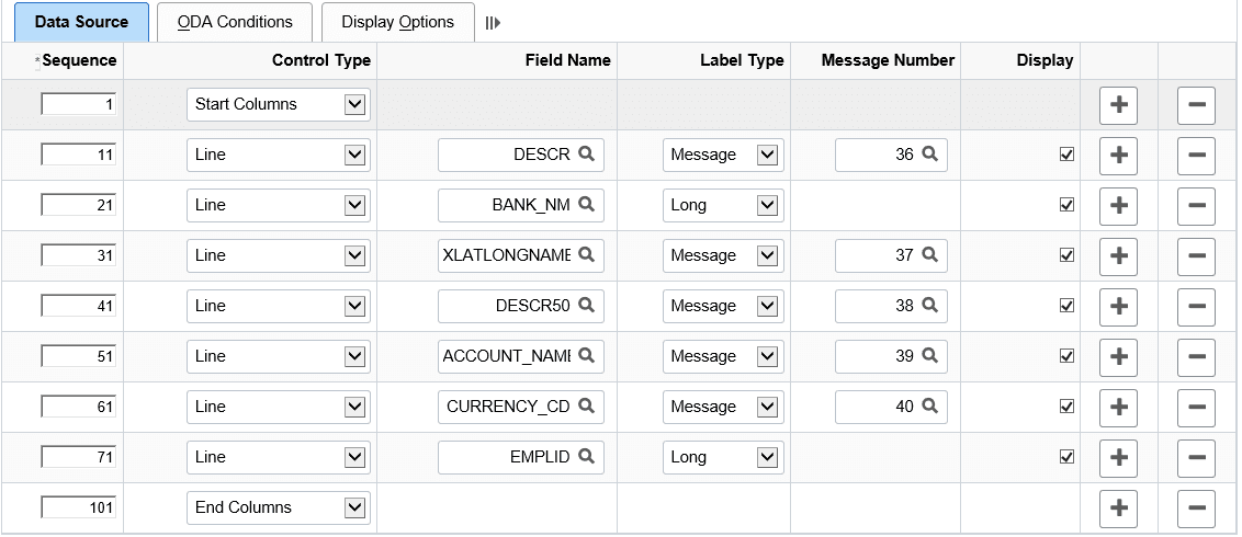

Data Source Tab
Use the Data Source tab to map control type to the field.
This example illustrates the fields and controls on the Data Source tab.
Data Source tab
Sequence
Used to control the sequence of the fields.
Control Type
This allows the user to control what type of display it should be on the chatbot.
  • Message: Allows the user to display a message using Message catalog. It enables the Message Number field.
  • Text: Allows you to set up Free Text, that can be displayed on the chatbot.
  • Line: Allows the setup of a data mapping, where a field value and label can be displayed.
  • Display Column: Allows to display the fields in a column format.
  • End Column: End column stops the column display.
Field Name
Prompts the field name from the record specified in the record selection.
Label Type
Label type to be displayed for the field. Label types can be Long, Short or Text.
Message Number
Allows the user to select the message number corresponding to the message set number of the Application setup. This field is enabled when the Message Catalog option is specified.
Display
Allows the user to control whether the line should be displayed or not.

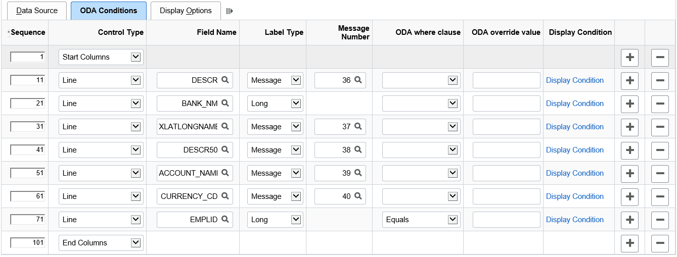

ODA Conditions Tab
Use ODA Conditions tab to specify any conditions on the ODA.
This example illustrates the fields and controls on the ODA Conditions tab.
ODA Conditions tab
ODA where clause
This field is used to select a 'where clause' operation. PeopleSoft extracts field information from the table selected with a 'where clause' condition and fetch data from ODA.
ODA override value
This field is used to override or hardcode a value to be considered as the where-condition in the query.
Display Condition
This link is used to control the display of information based on criteria.
The Display Condition link opens the Conditional Formula modal window as shown:
This example illustrates the fields and controls on the Conditional Formula modal window.
Field Name1
The field for which the condition to be applied.
Operator
Operator used to define the condition.
Value Type
Type of data value associated with the field.

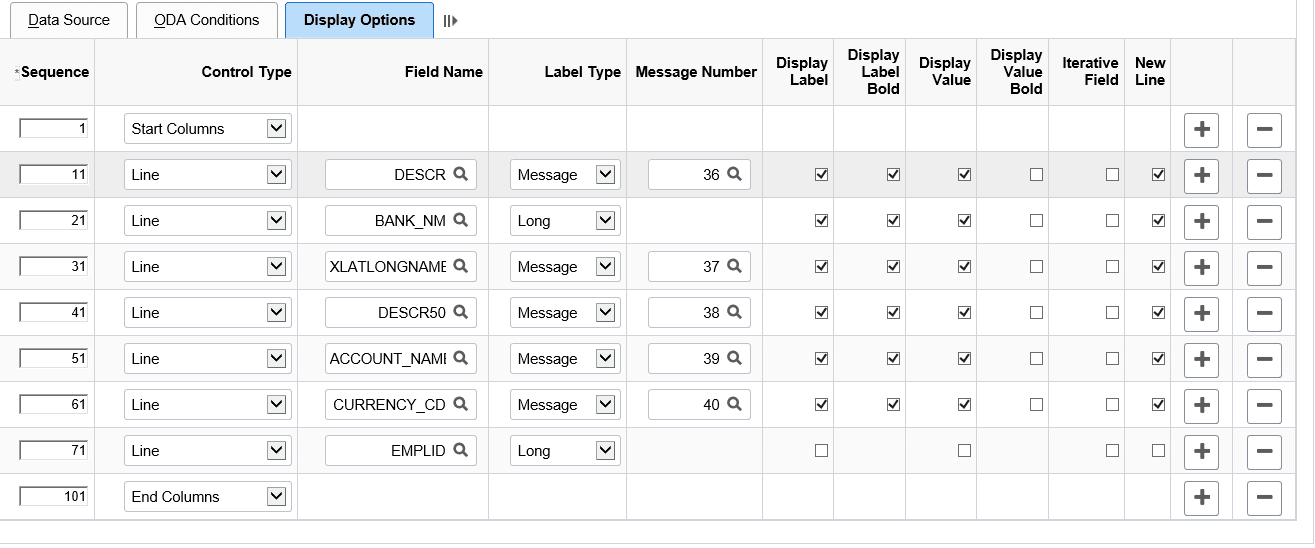

Display Options Tab
Use the Display Options tab to control the display.
This example illustrates the Display Options tab.
Display Options tab
Display Label
Select the check box if you need to display the field label.
Display Label Bold
Select this check box to make the field label bold.
Display Value
Select this check box to display the value of the field.
Display Value Bold
Select this check box to make the field value bold.
Iterative Field
This field is used to repeat the field till data is available. The Group By Field in the Record Selection is used for the iteration.
New Line
Select this check box to display the field on a new line.

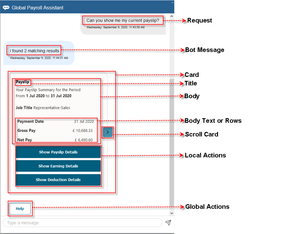

Below image/visual representation illustrates the chatbot card layout, depict the control/section of the setup.
Chatbot Card Layout
Global Payroll Assistant allows the users to build PS Query as per business requirements.
Prior to building a PS Query, you must take care of the following:
  • Global Payroll Assistant requires that PS Query must be public.
  • Global Payroll Assistant requires that PS Query must have EMPLID as part of their structure, it can be either in a subquery or a regular query, but it should be tied to top level records.
If the PS Query has ‘Where’ condition or clause and EMPLID is not used, then Global Payroll Assistant displays confidential information or the said query can return multiple rows.
Currently, Global Payroll Assistant supports the following PS query options:
  • Query
  • Expressions
  • Prompts
  • Fields
  • Criteria
  • Having
For detailed information on each PS query option, refer to Global Payroll Chatbot Application Red Paper.
For more details on PS Query, refer PeopleTools: PeopleSoft Query Overview section.
