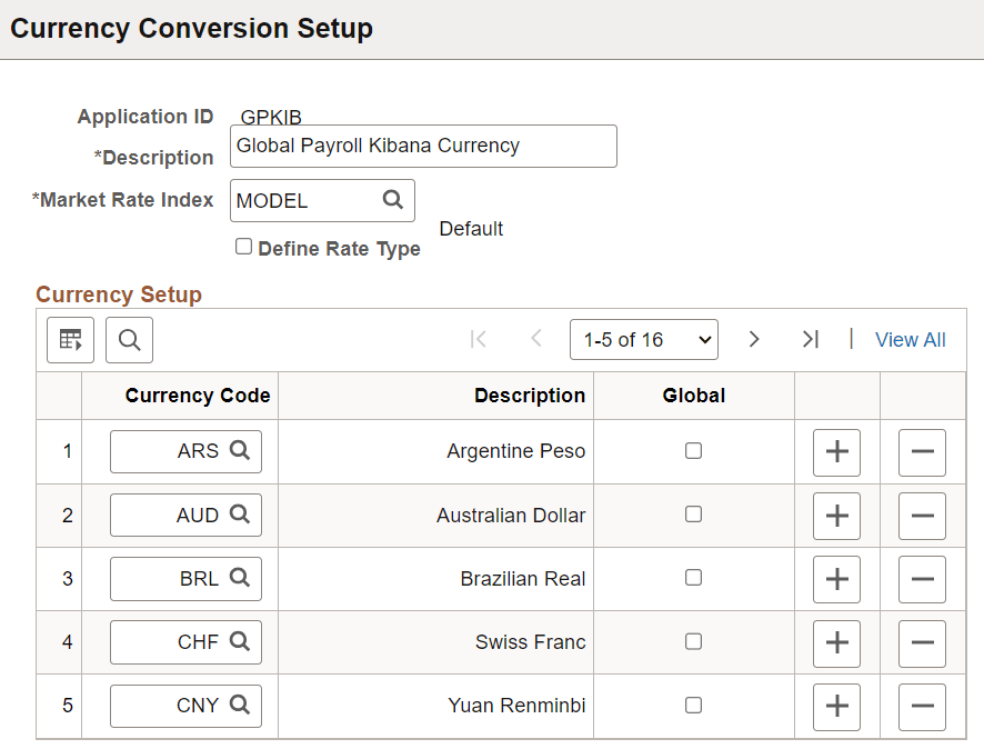

This example illustrates the fields and controls on the Currency Conversion Setup page.
Currency conversion setup page
Field or Control Description
Application ID
Displays the application ID for which the currency conversion is defined.
Description
Meaningful description for currency conversion setup.
Market Rate Index
Displays the key term for the highest level of organization for market rates in the application. By default, MODEL is selected in this field.
Define Rate Type
Select this checkbox if you want to select specific rate types.
By selecting this checkbox, the Rate Type field is displayed.
Rate Type
Select the required category within a market rate index.
For details on market rate types, see Defining Market Rates.
Currency Code
Select the local currency so that the transactions which match that currency will be viewed in the visualizations.
Ensure to enter your local currency in this field so that the data will be displayed in Insights dashboard.
Description
Meaningful description for the currency code.
Global
Select the checkbox, if you want to make the selected currency as Global.All local currencies are converted to global currency. For converted values to be displayed in Insights, market conversion rate should be defined for Local to Global currency. For details on market rate, see Defining Market Rates.
Note: By default, the global payroll visualizations are displayed in global currency.
