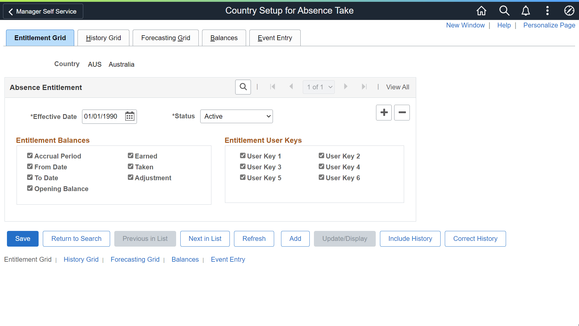

Entitlement Grid Page
Use the Entitlement Grid page (GP_ABS_SS_CNTRY1) to select the entitlement fields that appear on the View Absence Balances page.
Navigation:
Set Up HCM, and then Product Related, and then Global Payroll & Absence Mgmt, and then Absence Management, and then Country Setup for Absence Take, and then Entitlement Grid
This example illustrates the fields and controls on the Entitlement Grid page.
Entitlement grid
The fields on this page control what appears on the View Absence Balances page.
Field or Control Description
Accrual Period
Select to have the system display the accumulator period for each entitlement balance, for example, year-to-date or month-to-date. (Define the period for an entitlement accumulator on the Accumulator Periods for Element <element name> page. Select the entitlement accumulators on the Balances page. )
From Date and To Date
Select to display the begin and end dates of the accrual period.
Opening Balance
Select to display the balance details such as opening, accrued, taken, adjustment and closing balances.
Earned
Taken
Adjustment
User Key 1...6
Select to display the values of up to six user keys that are associated with the entitlement accumulator. (Define user key values on an entitlement element's Auto Generated Accumulators page.)

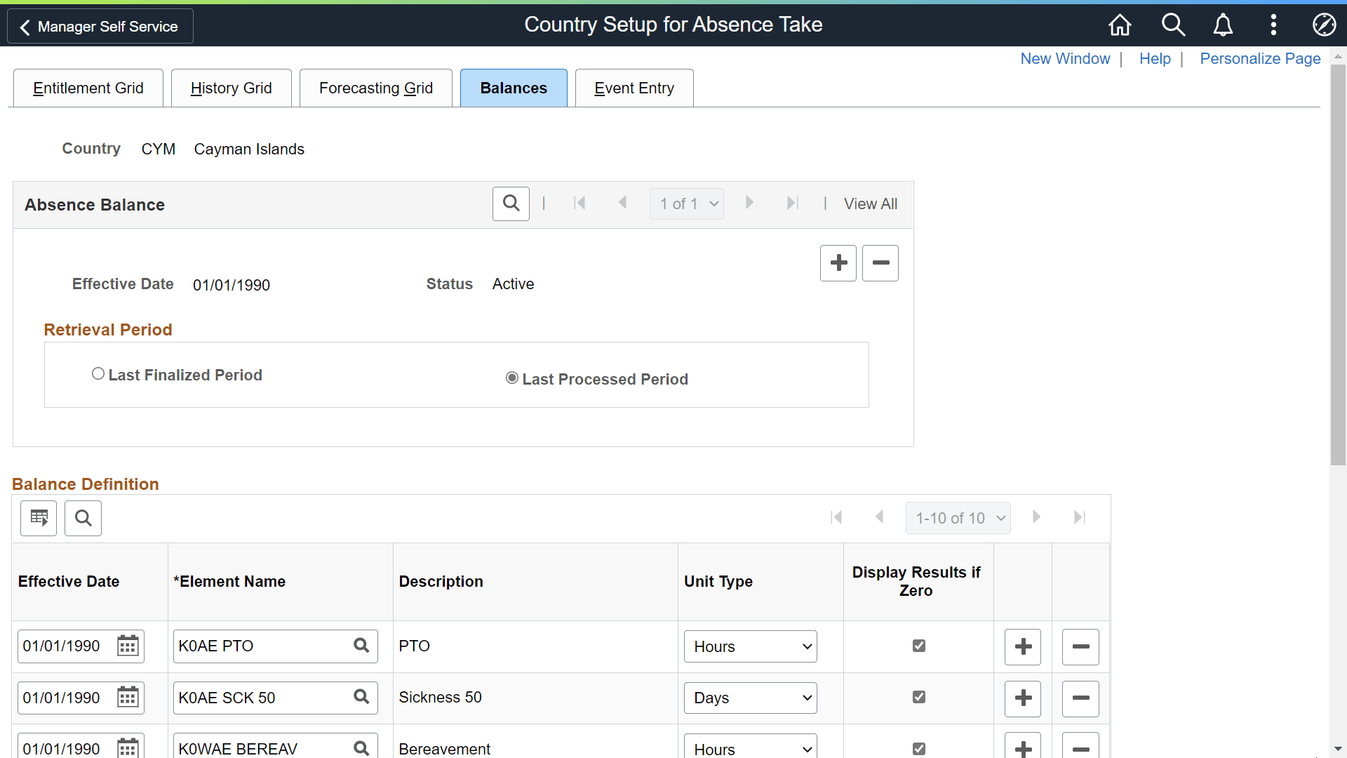

Balances Page
Use the Balances page (GP_BAL_ELIG_SS) to enter balance elements and select display options on the View Absence Entitlement Balance page.
Navigation:
Set Up HCM, and then Product Related, and then Global Payroll & Absence Mgmt, and then Absence Management, and then Country Setup for Absence Take, and then Balances
This example illustrates the fields and controls on the Balances page.
Balances page
The fields on this page control what appears on the View Absence Entitlement Balances page in the Self Service component.
Last Finalized Period
Select this field to show the balances as of your last finalized calendar.
Last Processed Period
Select this field to show the balances as of your last processed or calculated calendar.
Effective Date
The date that the balance accumulator will appear on the View Absence Entitlement Balances page.
Element Name
Select the accumulator element for the entitlement balance you want to display.
Unit Type
Select Days or Hours as the units to display on the self service pages. These are units that users see when viewing absence entitlement balances.
Note: The selected unit type should match the unit type defined for the take element.
Display Results if Zero
Select to display the element on the View Absence Entitlement Balances page when there is no balance for that accumulator. The system displays the balances as of the most recent run of the Entitlement process for the employee.

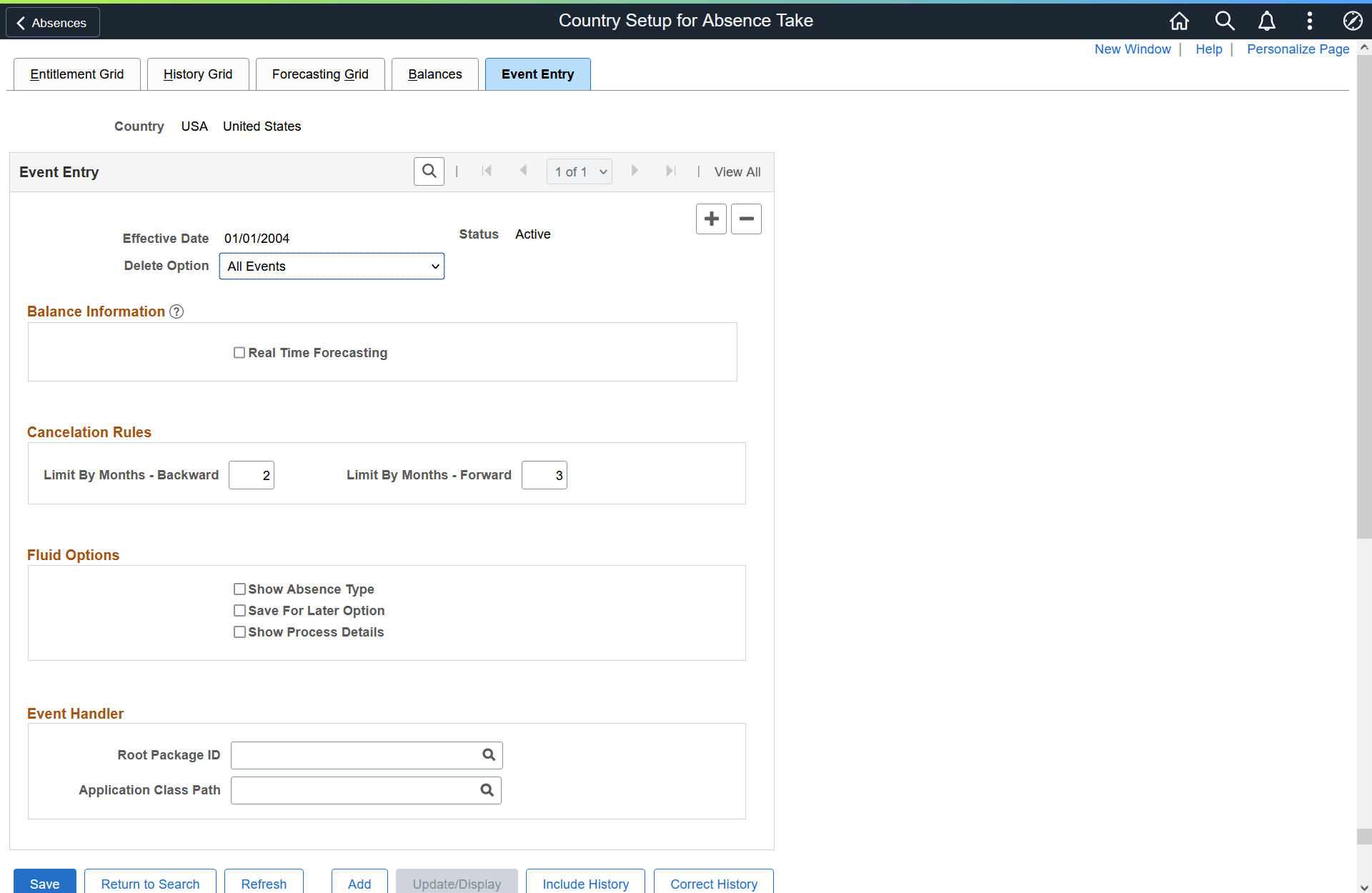

Event Entry Page
Use the Event Entry page (GP_ABS_EVT_ENTRY) to select deletion options to allow absent entries to be deleted on the Absence Event Entry page.
Navigation:
Set Up HCM, and then Product Related, and then Global Payroll & Absence Mgmt, and then Absence Management, and then Country Setup for Absence Take, and then Event Entry
This example illustrates the fields and controls on the Event Entry page.
Event Entry page
The fields on this page control real time balance calculation, deletion, cancellation, and Fluid options for absence requests.
Delete Option
Select a value to determine which absence events can be deleted on the Absence Event Entry page. Valid values are All Events, All Events Except Finalized, and All Events Except Processed. The delete button is disabled on the Absence Event Entry page for all rows that do not meet the criteria indicated by the Delete Option.
Balance Information
Real Time Forecasting
Select this option to enable real time calculation of balances as of today. When you request a leave of absence, the system calculates your current balance as of today and recalculates it based on the number of hours or days you are requesting.
Cancelation Rules
Limit By Months - Backward and Limit By Months - Forward
Define the range of months before and after the current date in which submitted absence requests must fall to be eligible for cancellation. For example, let us say that the Limit By Months - Backward is set to 2 and the Limit by Months - Forward is set to 3. In this case, on March 18 users would be able to cancel absence requests submitted for January 1 through June 30.
Fluid Options
Show Absence Type
Select to display the type of absence for absence requests submitted using the PeopleSoft Fluid user interface.
Save for Later Option
Select to provide a Save for Later button for users submitting absence requests using the PeopleSoft Fluid user interface.
Show Process Details
Select to allow the employees to view the absence process details in the View Request Page from Self Service.
Note: By default, this option is not enabled.
Event Handler
While approving or cancelling absences, you can define an app package and class and execute any country specific logic using these options. The context of the absence event is set by absence code while calling the country extension event handler.
Root Package ID
Search and select root package ID, for approving or canceling absence.
Application Class Path
Search and select the application class path.
The Country Specific app class needs to extend the core app class HGA_COUNTRY_SPECIFIC:CountrySpecific and implement the method ExecuteCECode() in their app class.
The record object for GP_ABS_SS_DAT and Action are passed as context and will be available for the country extension event handler app class.
This helps country extension code to identify the absence event and execute any country specific logic.
