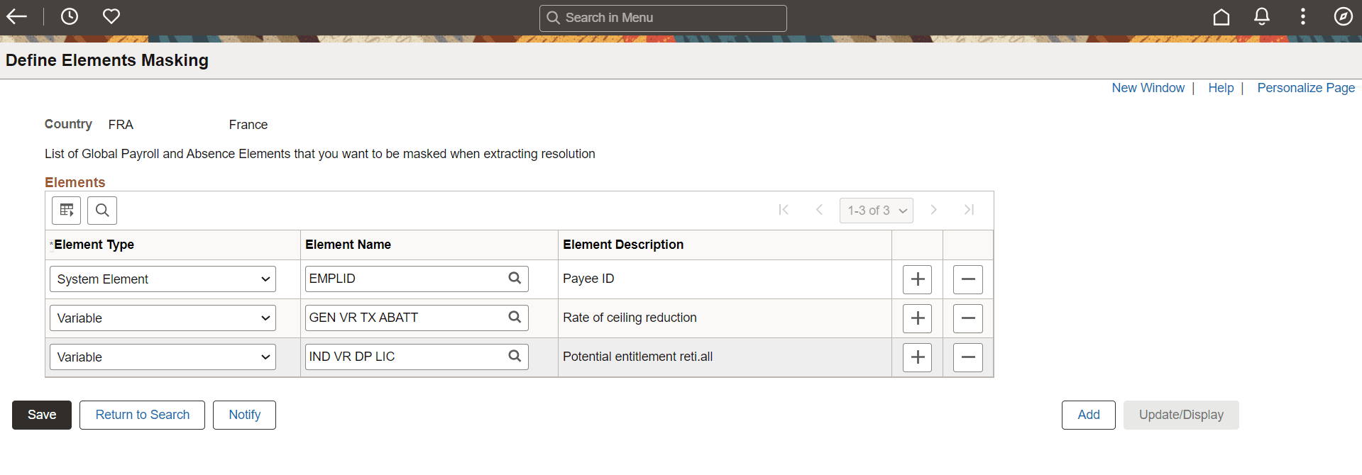

Define Elements Masking Page
Use the Define Elements Masking page (GP_ERC_ELM_MSK) to define global payroll and absence elements which contain sensitive data that need to be masked during element trace extraction process.
Content of this setup is used when exporting data from GP_AUDIT_TBL to mask the content of the listed elements.
Navigation:
Global Payroll & Absence Mgmt, and then Absence and Payroll Processing, and then Prepare Payroll, and then Define Elements Masking
This example illustrates the fields and controls on the Define Elements Masking page.
Field or Control Description
Element Type
Type of element which need to be masked during element trace extraction process.
Element Name
Name of element.
Element Description
Meaningful description of the element.
