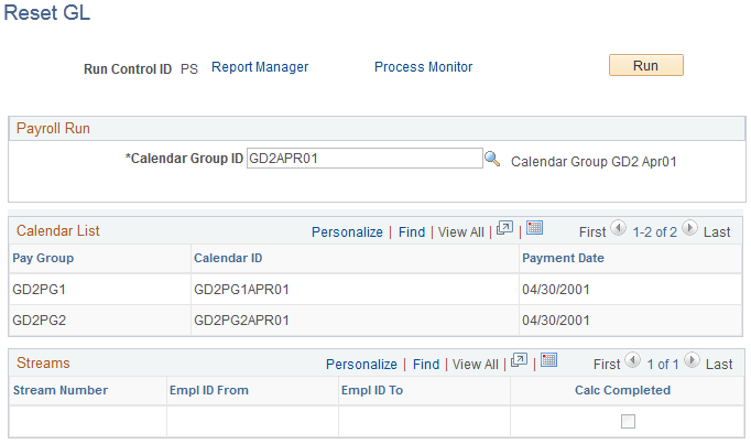

Reset GL Page
GP_GL_RESET
Run the GL Reset process before rerunning the GL Transaction Creation process when reposting is necessary due to errors.

Reset Process Description
If the transactions sent to General Ledger are later found to have errors, you might have to run the GL Reset process and repost the transactions.
The GL Reset process:
  • Deletes all rows on the Global Payroll Accounting Line Staging table (PS_GP_ACC_LINE_STG), which is invoked during the Finalize Costs for GL process and is the source record for the posting process.
  • Resets the GL Finalized indicator fields to not finalized on both the Completed GL Stream table (PS_GP_GL_PREP_STRM) and the Calendar Run Definition table (PS_GP_CAL_RUN).
    You must run the GL Reset process before rerunning the GL Transaction Creation process and reposting for the calendar group ID.

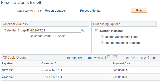

Finalize Costs for GL Page
Use the Finalize Costs for GL page (HPIP_GP_FINALIZE) to prepare the accounting lines for posting and post them to General Ledger.
Navigation:
Global Payroll & Absence Mgmt, and then Time and Labor / GL Costs, and then Finalize Costs for GL
This example illustrates the fields and controls on the Finalize Costs for GL page.
Field or Control Description
Override Indicator
Select to override the default balance options set for the target product on the Configure Target System page. The other fields in this group box are available for entry only if Override Indicator is selected.
Balance Accounting Lines
Select this check box if you want the system to calculate whether the debits equal the credits for each general ledger business unit.
Book to Suspense Account
This field is available for entry if you select Balance Accounting Lines.
Select Book to Suspense Account to post unbalanced amounts to a suspense account when the credits do not equal debits. If selected, you must specify a suspense account number on the Configure GL Business Unit page.

Reset GL Page
Use the Reset GL page (GP_GL_RESET) to run the GL Reset process before rerunning the GL Transaction Creation process when reposting is necessary due to errors.
Navigation:
Global Payroll & Absence Mgmt, and then Time and Labor / GL Costs, and then Reset GL
This example illustrates the fields and controls on the Reset GL page .
Reset GL page
Use this process only if it is necessary to repost the transactions because they were originally sent with errors. After resetting, correct the data errors and repeat GL processing.
Calendar Group ID
Select the calendar group for which you want to reset the GP GL interface processing. Resetting applies to the entire calendar group.
The remaining fields on the page are for information only; you cannot enter or alter the data.
