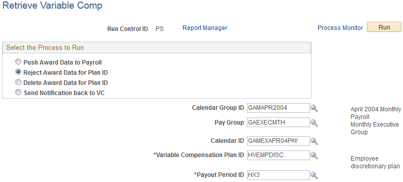

This example illustrates the fields and controls on the Retrieve Variable Comp page.

To retrieve award data:
  1. Select Push Award Data to Payroll.
  2. Select the calendar group ID, pay group, and calendar ID.
  3. Click the Run button.
