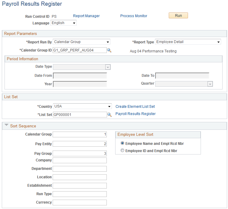

This example illustrates the fields and controls on the Payroll Results Register page.

Report Parameters
Field or Control Description
Report Run By
Specify whether you are generating a report by Calendar Group or Period.
If you select Calendar Group, the fields in the Period Information group box becomes unavailable. If you select Period, the Calendar Group ID field becomes unavailable.
Note: Make sure that at least one of the sections associated with the calendar group or period that you select contains the writable array GP WA GUIDE. Otherwise, the GP_RGST_EXT Application Engine program will not extract results correctly.
Report Type
Select the type of report you want to generate. Valid values are:
  • Employee Detail: This report provides segment detail for each employee and includes both an Earnings and Deductions section and an Accumulator and Arrears section.
  • Employee Summary: This report summarizes all segments and does not include an Accumulator and Arrears section.
  • Organizational Summary: This report does not include any employee detail. It lists totals summarizing the earnings and deductions within an organization.
Calendar Group ID
Enter the calendar group ID for which you are generating payroll results.

List Set
The Payroll Results Register report requires that you select a list set. A list set represents groups of elements and corresponding element attributes associated with a specific application. The list set that you select determines which earnings, deductions, and accumulators the system uses to extract report data for the Payroll Results Register. It also determines the sections and titles of the printed report.
See Understanding Applications and List Sets.
Country
The country you select here determines which list sets are available for you to select.
Create Element List Set
Click to access the Define List Set page in Add mode.
List Set
Select the list set you want to use for the report. When you select a list set, a link next to the List Set field appears enabling you to access the selected list set on the Define List Set page in Update/Display mode.
Sort Sequence
There are nine sort sequence fields, you can define up to seven sort sequencing fields for any one report definition. Enter a number for each field by which you want to sort payroll results for the report. Fields that are blank or have a value of zero are not used in the report.
Employee Level Sort
Select whether the report sorts employees by Employee Name and Employee Rcd Nbr or Employee ID and Employee Rcd Nbr.
