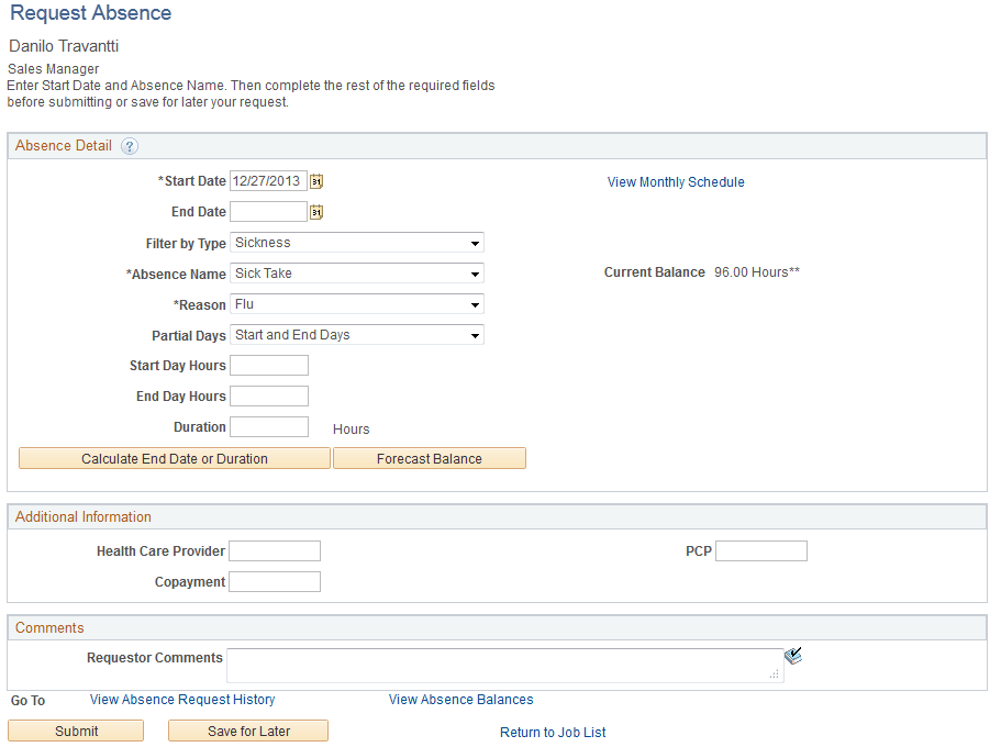

This example illustrates the fields and controls on the Request Absence page.
The Request Absence page consists of three group boxes: Absence Detail, Additional Information, and Comments. The available fields in the Additional Information group box depend on how your organization sets up self-service for Absence Management.
