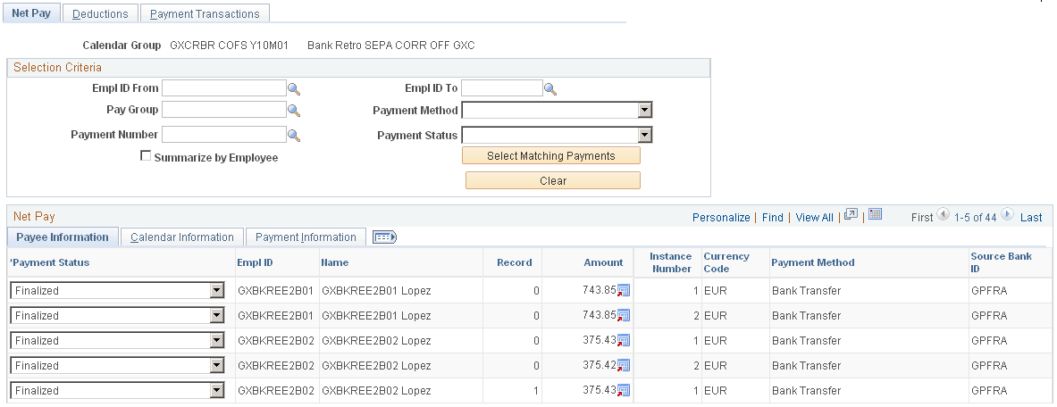

Net Pay Page
Use the Net Pay page (GP_PMT_NP_VIEW) to view payee net pay by calendar group.
Navigation:
Global Payroll & Absence Mgmt, and then Payment Processing, and then Review Payments by Cal Group, and then Net Pay
This example illustrates the fields and controls on the Net Pay page.
Net Pay page
If there are more than 300 rows of data, a message will appear indicating that if you want to view more records for the calendar group, you need to enter specific criteria.

Payee Information
Select the Payee Information tab.
This tab displays the payment status, employee ID, name, record number, instance number, amount, currency code, payment method, and source bank ID that is associated with each payment.
Field or Control Description
Payment Status
Displays the payment status. You can change the payment status only when the banking process has been finalized and you have not selected the Summarize (by Employee) check box. Options are:
Hold: Use this status to stop a payment from being transferred to the bank. When you want to make the payment, change the status from Hold to Finalized. You cannot change the status to Hold after a payment has been transferred.
Manually Paid: You cannot change the status of manual payments.
Prepared: The system sets this status when you run the banking process and payments are first allocated.
Payment Transferred: Indicates that the payment has been transferred to the bank. During local country processing, the system changes the status from Prepared to Payment Transferred.
No Active Allocations: Indicates that no net pay elections are defined for the payee on the Net Pay Elections page.
Finalized: The payment has been created and finalized. You can change the status of finalized payments to Void, or Hold.
Void: Use this status to cancel a payment. Once you void a payment, you cannot unvoid it.
Note: When you void a payment, the system voids the net pay and deductions that make up the payment.
Note: If you are voiding a payment because you are using an off-cycle to correct or reverse a payment, setting it to void doesn't automatically create a recalculation of the payroll. You need to run the off-cycle for this to occur.

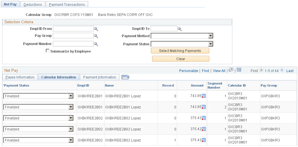

Calendar Information
Select the Calendar Information tab.
This example illustrates the fields and controls on the Net Pay page: Calendar Information tab.
This tab displays the segment number, calendar ID, and pay group that is associated with each payment.

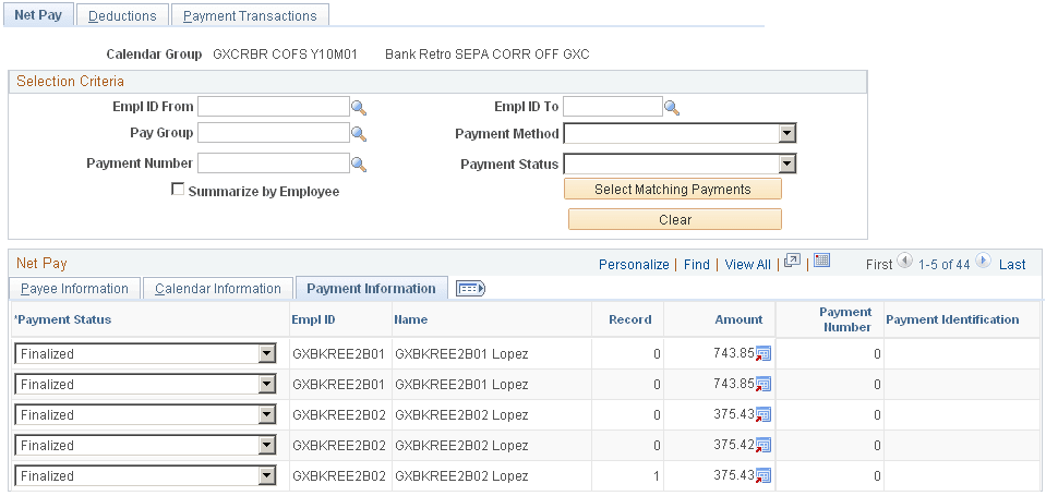

Payment Information
Select the Payment Information tab.
This example illustrates the fields and controls on the Net Pay page: Payment Information tab.
This tab displays the payment number and payment identification that is associated with each payment. These fields are blank except for manual payments entered in an off-cycle payroll for the core process.
Some country extensions use payment numbers and payment identification for their regular banking processes and not only for manual payments.

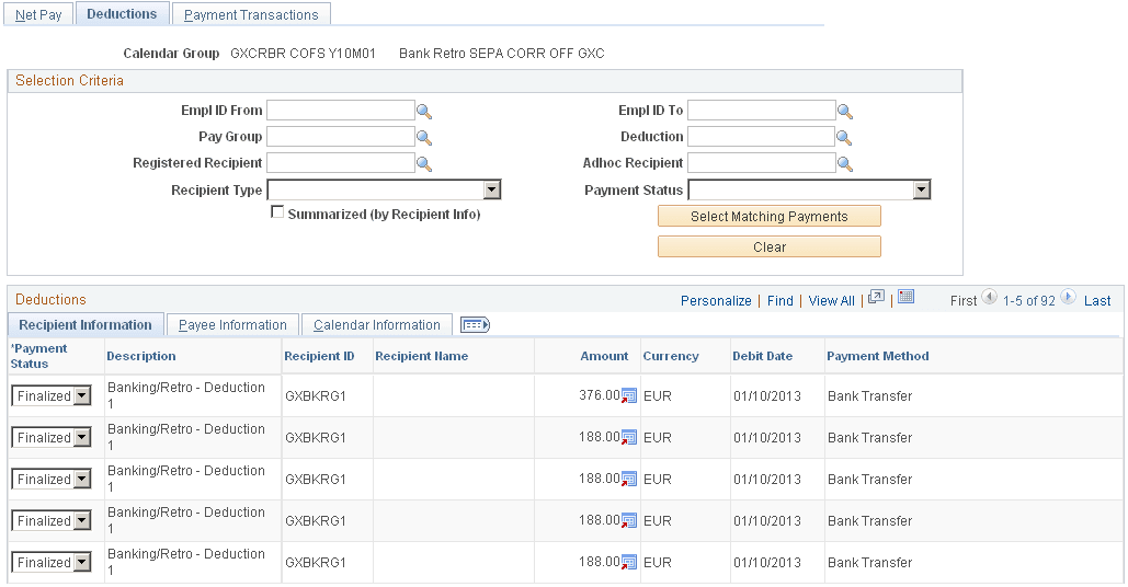

This example illustrates the fields and controls on the Deductions page.
Deductions page
Many of the fields on the Selection Criteria group box on the Deductions page are similar to the fields on the Net Pay page. These common fields are documented with the Net Pay page. Fields unique to the Deductions page are documented below.
See Net Pay Page.
Registered Recipient
Select the recipient ID to view deductions for recipients defined on the Define Deduction Recipients page.
Adhoc Recipient
Select a recipient in this field if you want to view deductions for recipients defined on the Assign Deduction Recipients page.
Recipient Type
Select General Recipient Deduction or Individual Recipient Deduction.
Summarized (by Recipient Info)
Select this check box to display the total amounts paid to recipients. If you leave this check box deselected, the system lists the amounts paid to recipients for each payee.

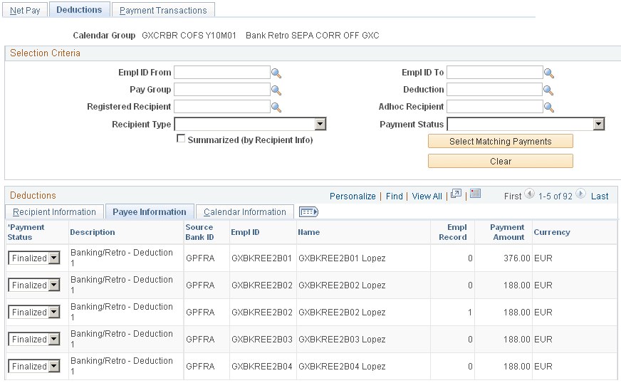

Payee Information
Deductions page: Payee Information tab
This tab displays information about the payee.

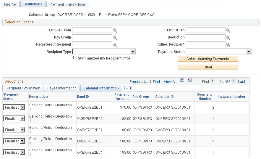

This example illustrates the fields and controls on the Deductions page: Calendar Information tab.
This tab displays information about the calendar.

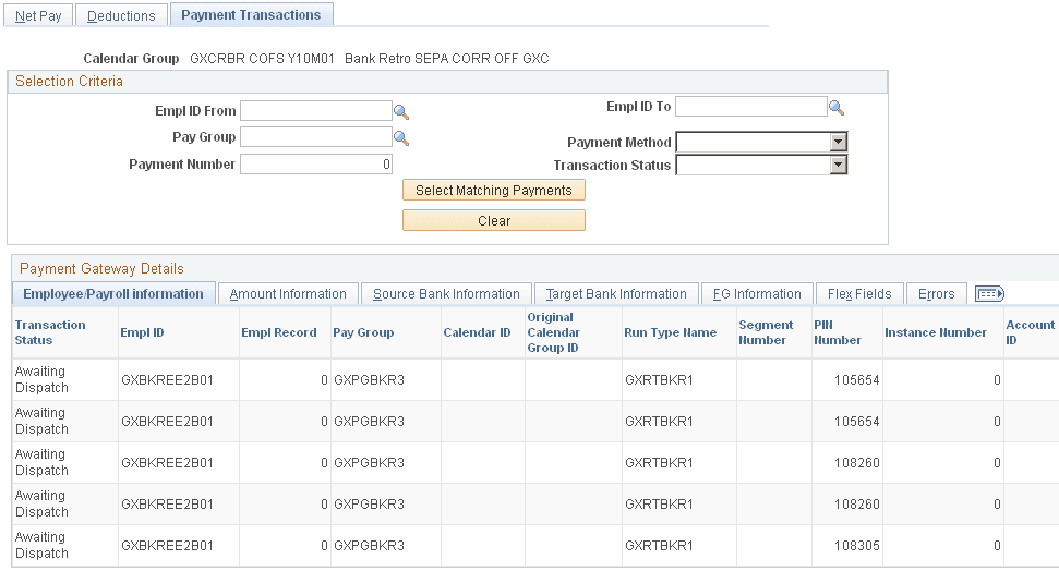

This example illustrates the fields and controls on the Payment Transactions page.
This page displays the payment processing results loaded to the GP_PAYMENT_FG record for a specific calendar group.
This page appears in the Review Payments by Cal Group component only for calendar run IDs associated with countries that have an application package defined on the Banking Country Setup page with a status of Active.
Selection Criteria
Use this group box to filter the results displayed in the Payment Gateway Details scroll area. You can filter by Empl ID (employee ID), Pay Group, Payment Method, Payment Number, and Transaction Status.
Select Matching Payments
Click to display the payment details that match your selection criteria.
Clear
Click to clear the results displayed in the Payment Gateway Details scroll area.
Payment Gateway Details: Payee Information Tab
This tab displays the values of the standard payment field values.
This tab also displays the Transaction Status for each row. This status indicates where the payment is in the process of sending it to Financial Gateway and dispatching it to external banks. It is updated by both the Payment for FG (GP_PMT_FG) process and the PAYMENT_RESPONSE message received from Financial Gateway.
