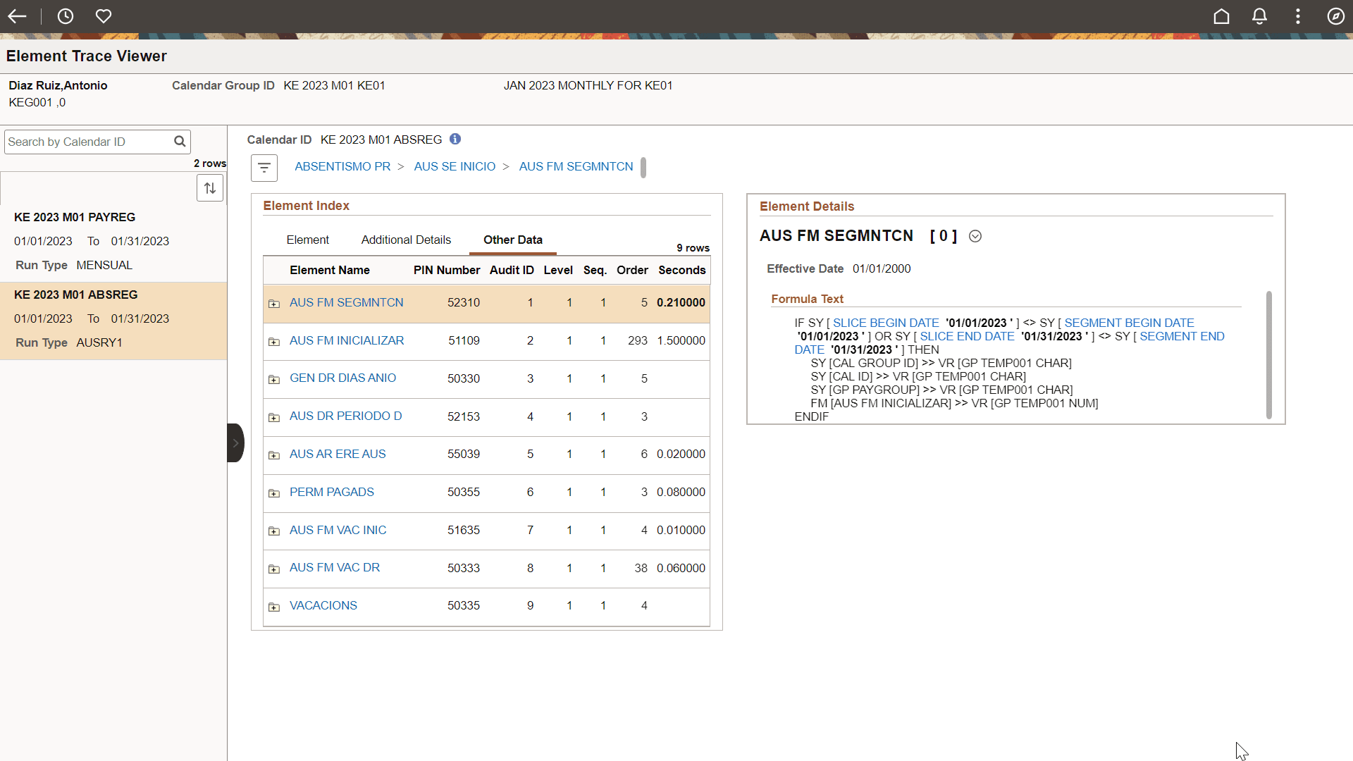

Element Index
The Element Index section includes three tabs: Element, Additional Details and Other Data. The Element tab displays the content of GP Audit table (Element Resolution Chain). By default, the elements displayed are the ones listed in the sections of the process list, however the user can drill down to get details of the elements used to resolve the element. The Additional Details tab displays the details of the elements, including the section in which the element was executed, and slice begin and end dates. You can view the Pin Number, Audit ID, Level, Sequence, Order and Time Execution in the Other Data tab.

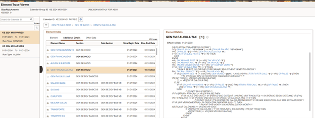

Click the Additional Details tab to view the Element Index - Additional Details page.
This example illustrates the fields and controls on the Element Index - Additional Details page.
Element Index Additional Details

Element Name
Click to access the Detail Audit Chain page where you can view the order in which the element resolved.
Section
The section in which the element has been executed.
Sub-Section
The sub-section in which the element has been executed
Slice Begin Date
and
Slice End Date
Displays the begin and end dates of the slice in which the element was processed.
Click the Other Data tab to view the Element Index - Other Data page.
This example illustrates the fields and controls on the Element Index – Other Data page.
Other Data page

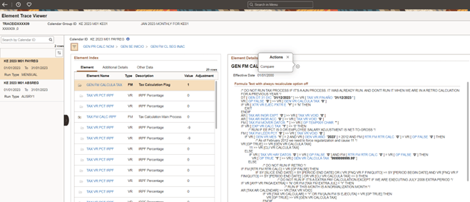

Related Action icon
Click this icon to either edit the element, compare it or export the trace into an excel. The Edit link takes you to the corresponding set up page in a new browser tab where you can modify the element definition as needed. This option is available when the Element Resolution Chain has been generated in the environment.
The 'Compare' option is available when Element trace is loaded into the environment (target) from a file that was generated in a different environment (source) using the Element Trace Extraction tool. By selecting this option, you will be able to compare the definition of the element between the two environments.

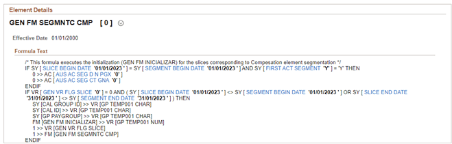

This example illustrates the details of a formula element.
Formula Element
System displays the text of the formula together with the resolved amounts of the used elements, which makes much easier to understand the calculation. By clicking on the formula text, users can also navigate directly to the executed elements.

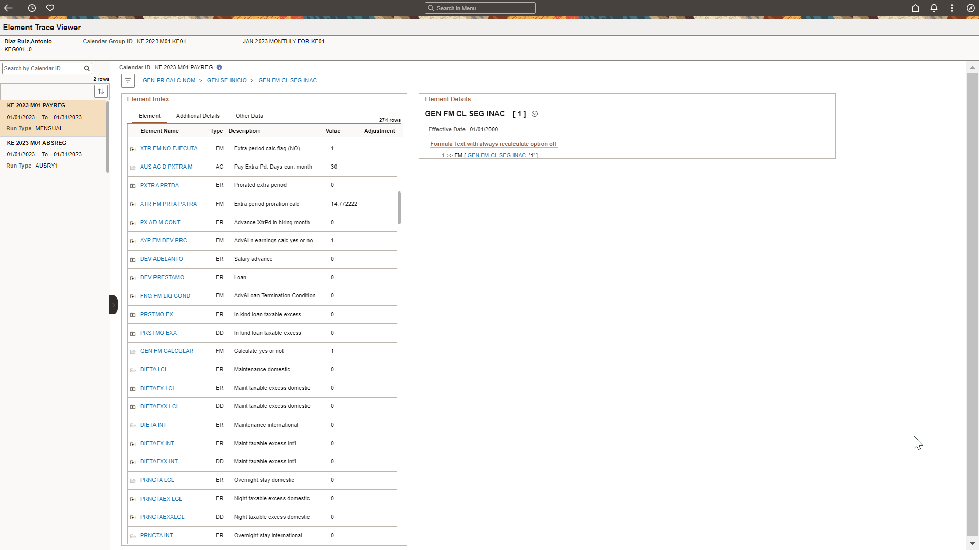

If a user selects an element that has previously been executed and has the option Always recalculate OFF, the system displays the following message: Formula Text with the Always Recalculate option off. There is no possibility to drill down into other elements because the element is not resolved while processing the parent element, the parent element uses its value but the child element is not re-calculated.
This example illustrates the Element Details with Always Recalculate option turned OFF.
Element Details_Recalculate OFF

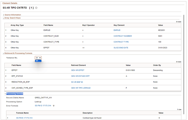

This example illustrates details of array execution.
Array Execution page
The user can navigate to the various rows returned by the array using field instance number.
Element Trace Loaded from File
Element Trace Viewer can be used to display the information of a Trace that has been loaded using the Element Trace Extraction Tool.
Example of Trace being loaded
Trace_example

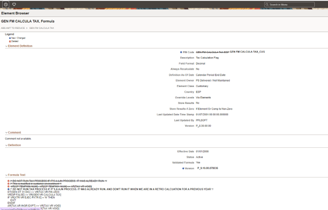

In this case system provides the possibility to Compare the setup of the selected element as it come in the file and as it is in the database where the trace has been loaded.
Result of the Compare
Compare Results
