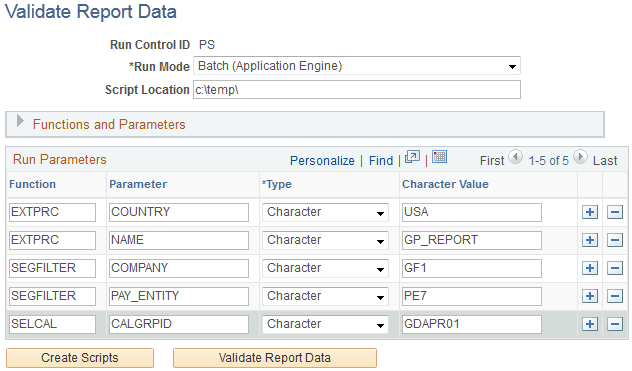

Use the Validate Report Data page (GP_RC_RPT) to enter report data parameters.
Run the report data generation process in batch mode or real time. Generate SQL requests.
Navigation:
Set Up HCM, and then Product Related, and then Global Payroll & Absence Mgmt, and then Reports, and then Validate Report Data
This example illustrates the fields and controls on the Validate Report Data page.
The Validate Report Data page enables you to test a defined report with specific parameters so that you can validate the results. With this page you can:
  • Run the report data generation process in batch mode.
  • Run the report data generation process in real time.
  • Generate SQL requests.
  • View generated report data.
Field or Control Description
Run Mode
Select one of three options:
  • Batch (Application Engine).
  • Real Time (PeopleCode).
  • Script (Data Mover).
The Run Mode determines how the SQL statements are applied.
Script Location
Enter the location of the script. Data Mover can execute the script only if you selected Script (Data Mover) in Run Mode. Otherwise the generated scripts can be used to debug the SQL statements.
Function and Parameter
Enter the functions and parameter that the system will use to select data for the report. For example, by entering SELCAL/CALGRPID you can then select which calendar group ID data to use in the report. Defined values are listed in the expandable Functions and Parameters group box.
Note: You can also create user-defined functions and parameters to use in the input filter.
Type
Indicate the field type of the Parameter. Select either Char, Date, Numeric, or SQL.
Character Value
Enter the value of the Function or Parameter.
Create Scripts
Click to create a .dms containing the SQL statements and to display them on the page. The script includes a list of parameters used to generate the statements. If a parameter is not used in the process (because of a syntax error or a missing definition) the words "Not used" appear in the list.
Select this option to validate the report data. The process used depends on your Run Mode selection:
  • Batch (Application Engine): The system launches an Application Engine that runs the process in batch mode via process scheduler.
  • Real Time (PeopleCode): The system launches a PeopleCode function that runs the process in real-time.
  • Script (Data Mover): The system launches a Data Mover process that runs the process in batch mode via process scheduler.
