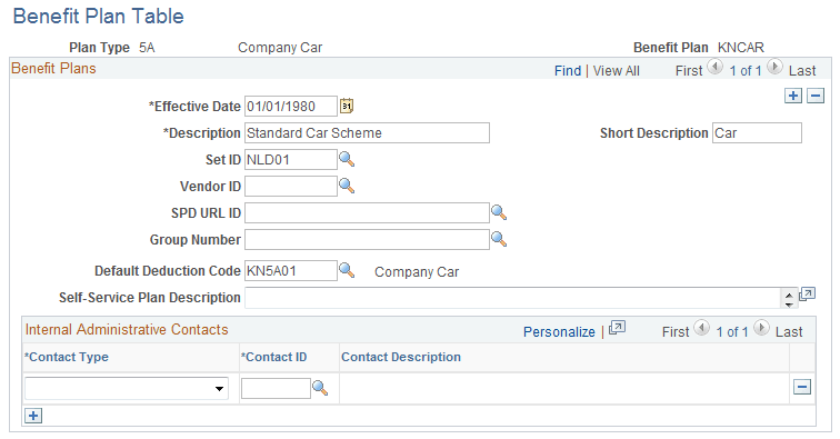

Benefit Plan Table Page
Use the Benefit Plan Table page (BENEFIT_PLAN_TABLE) to create and name company car benefit plans.
Navigation:
Set Up HCM, and then Product Related, and then Workforce Administration, and then Company Cars, and then Benefit Plan Table, and then Benefit Plan Table
This example illustrates the fields and controls on the Benefit Plan Table page.
Field or Control Description
Plan Type andBenefit Plan
Displays the plan type and benefit plan that you entered. Leave the remaining fields blank.
