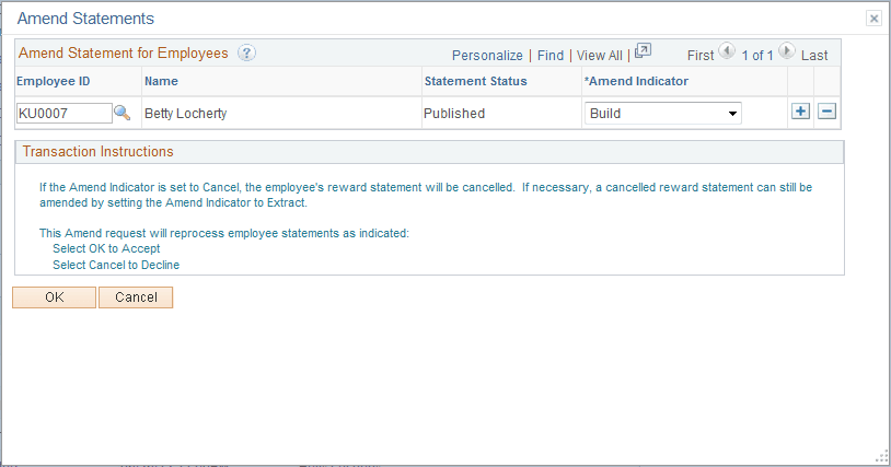

Amend Statements Page
TRW_STMT_AMEND
Amend or cancel individual employee total rewards statements.

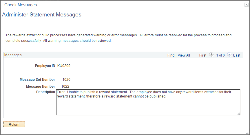

Administer Statement Messages Page
TRW_STMT_MESSAGES
Display any warnings or errors generated by the Rewards Extract and Rewards Build processes.
The compensation administrator is expected to review warnings and error messages and cancel the statement to make any adjustments to the configuration or data to correct the problem.

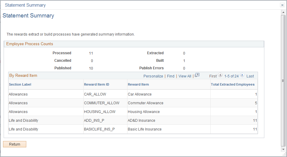

Statement Summary Page
TRW_STMT_SUMMARY
Display statistical summary information on what has been processed to date for the statement.

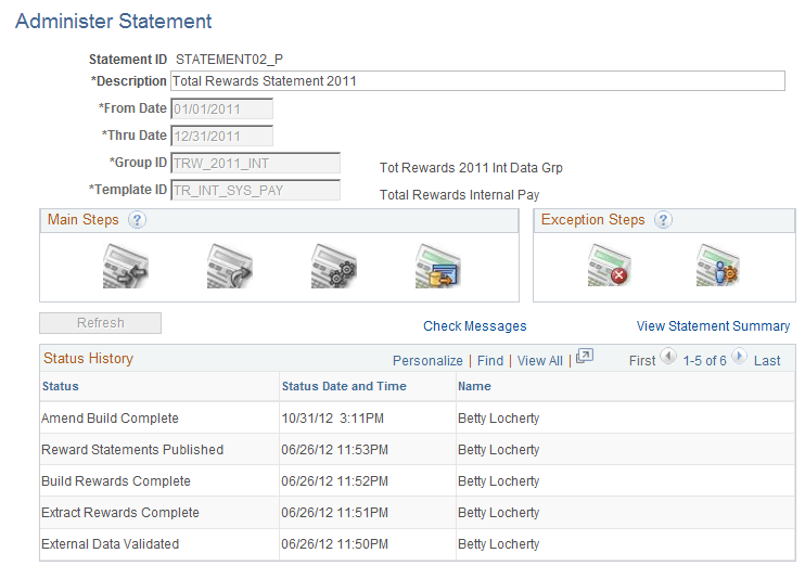

Administer Statement Page
Use the Administer Statement page (TRW_ADM_STMT) to define and process a total rewards statement.
As the compensation administrator performs the main process steps to generate a total rewards statement, the statement status is updated and certain data fields and buttons are enabled or disabled based on the status.
Navigation:
  • (Classic) Compensation, and then Total Rewards, and then Administer Statement , and then Administer Statement
  • (Fluid) Select the Workforce Administrator home page and click the Compensation Administration tile. On the left navigation, select Total Rewards, and then Administer Total Rewards
This example illustrates the fields and controls on the Administer Statement page.
The Compensation Administrator can add a new Statement ID and specify the following fields:
Field or Control Description
Statement ID
An abbreviation that uniquely identifies the total rewards statement to be generated.
Description
A description of the total rewards statement.
From Date and Thru Date
These fields are enabled if the Status field is Defined or External Data Validated. The From and Thru Date fields identify the period use by the Rewards Extract process to extract rewards information that will be displayed on the total rewards statement.
Group ID
Group ID defines the population of employee who will be processed for the My Total Rewards statement.
Template ID
This field identifies the structures of the total rewards statement; specifically, the reward items that will be extracted and displayed on the total rewards statement.
Statement Status
This is a display-only field. As the rewards statement is processed, the Status field will change to one of the following:
  • Defined - Initial status after the Statement ID has been saved.
  • External Data Validated - Assigned when the compensation administrator confirms all external data has been loaded into PeopleSoft.
  • Extract Rewards Complete - Assigned when the Rewards Extract process has completed.
  • Extract Rewards Error - Assigned when the Rewards Extract process encounters an error that requires the compensation administrator to correct a problem.
  • Build Reward Complete - Assigned when the Rewards Build process has completed.
  • Build Reward Error - Assigned when the Rewards Build process encounters an error that requires the compensation administrator to correct a problem.
  • Reward Statement Published - Assigned when the compensation administrator publishes the total rewards statements to the employee self service My Total Rewards.
  • Statement Cancelled - Assigned when the compensation administrator decides to cancel a statement.
  • Amend Extract Complete - Assigned when the Rewards Extract process completes extracting reward data for amended employees.
  • Amend Extract Error - Assigned when the Reward Extract encounters an error extracting reward data for an amended employee and requires the compensation administrator to correct the problem.
  • Amend Build Complete - Assigned when the Reward Build process completes the building of a total reward statement for an amended employee.
  • Amend Build Error - Assigned when the Reward Build process encounters an error building a total reward statement for an amended employee and requires the compensation administrator to correct the problem.
Refresh
Displayed, when the Rewards Extract or Rewards Build process is running. The compensation administrator can click this link to see if the process has completed.
Check Message
Displayed if the Reward Extract or Rewards Build process generated a Warning/Error message. The system transfers the compensation administrator to the Statement Messages page, which displays any warning or error messages that require the attention of the compensation administrator.
Error messages have to be resolved before the process can move forward. Warning messages provide insight into potential issues with the total rewards statement processing.

Amend Amend
The Amend icon is enabled if the statement status is Rewards Statement Published. The system transfers the compensation administrator to a page, which will enable the compensation administrator to cancel and reprocess an employee’s total rewards statement.

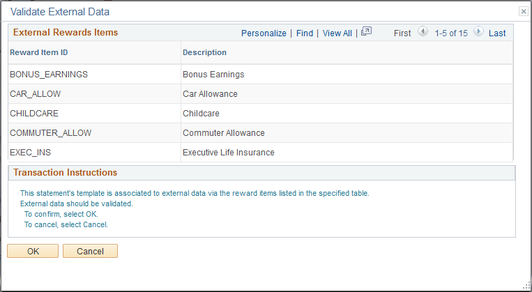

Validate External Data Page
Use the Validate External Data page (TRW_STMT_VAL_EDATA) to identify any external reward items associated with the specified template ID.
An external reward item is defined as any reward item associated to a reward data source that has the data source category set to EXT for External Rewards.
Navigation:
Click the Validate button on the Administer Statement page.
This example illustrates the fields and controls on the Validate External Data page.
This page serves as a reminder to the compensation administrator that external reward items are associated to the template being used to generate a total reward statement and to verify that external rewards data has been loaded into PeopleSoft.
External Reward Items
Reward Item ID
Description
Use the Amend Statements page (TRW_STMT_AMEND) to this page enables the compensation administrator to amend or cancel individual employee total rewards statements.
Navigation:
Click the Amend button on the Administer Statement page. The button is available when the statement has reached the Published status stage.
This example illustrates the fields and controls on the Amend Statements page.
This page enables the compensation administrator to amend or cancel individual employee total rewards statements.
Amend Statement for Employees
Employee ID
Edit field that allows the Compensation Administrator to select the employee they want to amend.
Name
Displays the name of the Employee.
Statement Status
Displays the current status of the Employee’s total reward statement.
Amend Indicator
Based on the statement status, this drop down menu displays the valid Amend Indictor that can be selected. For example, if the employee’s statement is Built, the Amend Indicator can only be set to Extract, Publish, or Cancel. Listed below are the Amend Indicators:
  • Extract
  • Build
  • Publish
  • Cancel
If an employee’s statement is set to the Amend Indicator of Cancel, then the total reward statement status will be set to Statement Cancelled and it will no longer be accessible. A canceled reward statement can be set to the Amend Indicator of Extract to process it and make it accessible again. Note: When a reward statement is being amended, it will not be accessible.
Use the Administer Statement Messages page (TRW_STMT_MESSAGES) to display any warnings or errors generated by the Rewards Extract and Rewards Build processes.
Navigation:
Click the Check Messages link on the Administer Statement page.
This example illustrates the fields and controls on the Administer Statement Messages page.
Messages
Employee ID
Display-only field that identifies the Employee ID to which the message refers. Note: The employee ID field is hidden if no employee ID is populated.
Message Set Number
Display-only field that displays the Message Set Number of the message.
Message Number
Display-only field that displays the Message Number of the message.
Description
Display-only field that displays the long description of the Message Catalog entry for the Message Set Number and Message Number displayed.
Use the Statement Summary page (TRW_STMT_SUMMARY) to display statistical summary information on what has been processed to date for the statement.
Navigation:
Click the View Statement Summary link on the Administer Statement page.
This example illustrates the fields and controls on the Statement Summary page.
Employee Process Counts
Processed
Displays the total number of employees who have a row in the Employee Statement record for the statement ID displayed.
Extracted
Displays the total number of employees who have the reward extract date populated in the Employee Statement record for the statement ID displayed.
Built
Displays the total number of employees who have the statement build date populated in the Employee Statement record for the statement ID displayed.
Published
Displays the total number of employees who have the statement published date populated in the Employee Statement record for the statement ID displayed.
Cancelled
Displays the total number of employees who have an employee statement status set to CAN for Canceled for the statement ID displayed.
By Reward Item
Section Label
Description of the section.
Reward Item ID
ID of the reward item.
Reward Item
Description of the reward item.
Total Extracted Employees
Displays the total number of distinct employees who have extracted data for the reward item.
