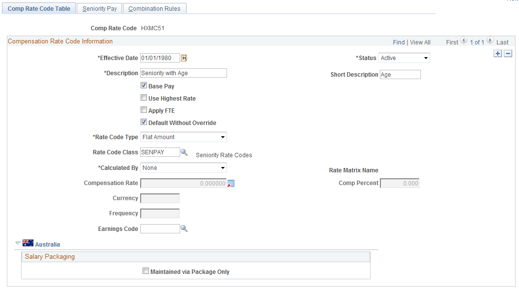

Comp Rate Code Table Page
Use the Comp Rate Code Table (compensation rate code table) page (COMP_RATECD_TBL) to define rate codes.
Navigation:
Set Up HCM, and then Foundation Tables, and then Compensation Rules, and then Comp Rate Code Table, and then Comp Rate Code Table
This example illustrates the fields and controls on the Comp Rate Code Table page.
Field or Control Description
Use Highest Rate
Select to use the highest rate of pay for this rate code. Use this option when a worker is temporarily placed in another job that is paid at a higher rate. This field does not affect human resources processing.
For Payroll for North America: When you assign rate code at the job level, you can enter a compensation rate that differs from the rate defined on the rate code table. If you deselect this check box, the rate that you specify at the job level overrides this rate.
Apply FTE (apply full-time equivalency)
Select for the rate code to be calculated as part of FTE. FTE is the percentage of full time that a worker normally works in the corresponding job. Full time is defined in the Standard Hours and Standard Work Period fields on the Salary Plan table. Alternatively, it can be defined in the default Standard Hours and Standard Work Period fields on the Installation table.
For Payroll for North America: Select to include full time equivalency in the job in the calculation of a base pay rate. You can select this check box only when the rate code type is Flat Amount or Hourly Rate. This check box does not apply to non-base-pay rates; it is unavailable for entry if you deselect the Base Pay check box.
Default Without Override
Select to ensure that compensation rate of the workers assigned to this rate code cannot be manually updated on the Compensation page of the Job Data component. You must select this check box for seniority rate codes.
Note: We do not recommend deselecting this check box for a rate code used as an absorbable premium on the Salary Plan table after the rate code has been added to worker compensation packages.
Rate Code Type
Select a compensation rate type. Depending on the type you select, certain fields become available for entry. Values are:
  • Flat Amount: A fixed (or flat) amount.
  • Hourly Rate + Flat Amount: A flat amount that is paid in addition to the hourly rate that is specified on a worker's timesheet. Enter the flat amount in the Compensation Rate field. This type cannot be a base-pay component.
  • Hourly Rate: An hourly rate of pay.
  • Percent: A percentage for use in defining compensation.
  • Points: This type of rate code is paid using salary points instead of currency. The monetary value of each point is set up on the Company Table page.
Note: To use points, select the Salary Points check box on the Installation Table - HCM Options page.
See Application Fundamentals: Setting Up Implementation Defaults.
Rate Code Class
Select a rate code class to associate with the rate code. Values include:
  • Elements of Base Salary (BASSAL): Used in salary forecasting.
  • Defined Range Rate Codes (DFRPAY): Used for pay components that are based on grade ranges within salary plans.
  • Regular Bonus (REGBON): Used in salary forecasting.
  • Seniority (SENPAY): Enables you to create seniority pay components, associate them with levels of pay increase, and update them according to changing seniority status.
Note: If you have created additional rate code classes, you can select one of the delivered values described previously or one of the values you created.
Calculated By
Select a value to determine how the rate for this rate code will be derived. Values are:
  • None: The rate on the rate code table itself is used.
    This value uses the current functionality.
  • Rate Matrix: The value will be derived dynamically from a rate matrix associated with the rate code.
    The rate matrix may have multiple criteria that determine different rates to be used.
Note: You can switch between None and Rate Matrix without having to create a new effective-dated row.
Rate Matrix
Select the specific rate matrix to be used.
This field becomes available when the Rate Matrix value is selected in the Calculated By field.
Note: You can only select a rate matrix whose output is compatible with the definition of the rate code. For example, if the rate code has a rate code type of Flat, (which implies a dollar amount), then the rate matrix must have an output of type amount, it cannot have an output that is a percentage, or a string of characters. When selecting a matrix, PeopleCode makes sure that it returns a result that matches the Rate Code Type. For example, DEFAULT_AMOUNT and AMOUNT are Flat Amount result types that are valid for a Rate Code with a type of Flat Amount. If the only Result ID specified was DEFAULT_PERCENTAGE, the system would display an error message because it is not valid. To resolve this issue, you would need to add another Result ID to the Matrix setup with a type of DEFAULT_AMOUNT or AMOUNT.
See PeopleSoft Human Resources Manage Base Compensation and Budgeting: Understanding Configurable Matrices.
Compensation Rate
Enter the standard compensation rate for this rate code.
This field is available when you select the value of None in the Calculated By field.
Comp Percent (compensation percentage)
Enter the percentage that will be applied to all base pay components, or a rate code group when new compensation rates for a worker are being derived.
Currency
Enter the currency for each value pertaining to the Calculated By field.
Frequency
Select a compensation frequency. You cannot select Hourly if the rate code type is Flat Amount. You must select Hourly if the rate code type is Hourly or Flat Amount & Hourly.
Earnings Code
If you use PeopleSoft Payroll for North America and enter an earnings code here for a nonbase pay rate code, the system automatically enters the earnings code when you select the comp rate code on the paysheet.
(AUS) Australia
When implementing PeopleSoft Salary Packaging for Australia, use this page to define and review the compensation rate codes you will use to package your workers. Compensation rate codes represent the IDs that you use for your pay components throughout your Salary Packaging system.
When defining your salary package components and additional components, you can link them to compensation rate codes to help you enter expenditures for the appropriate components. If you link compensation rate codes to salary package components, you must have a unique rate code for each package component or additional component (identified as an expense payroll type). This enables you to reconcile the package expenditure.
Maintained via Package Only
Select to create a link between a salary package component and the compensation rate code.
If you select this check box, a warning message appears if you manually change a worker's compensation rate code.
This check box, combined with other information on the worker's Job record, is used to maintain salary package integrity.
Using Rate Codes – Example

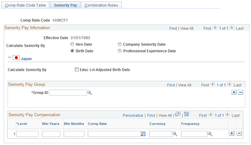

Creating Seniority Rate Codes
To administer seniority pay, you must create seniority rate codes.
To create a seniority rate code:
  1. Associate a rate code with the predefined seniority rate code class SENPAY.
  2. Associate the rate code with levels of seniority compensation increase.
  3. (Optional) Associate the rate code with one or more groups that you define using Group Build.
Important:
You cannot associate configurable rate matrices to seniority rate codes.
Comp Rate Code Table - Seniority Pay Page
Use the Comp Rate Code Table - Seniority Pay page (SENIORITY_PAY) to associate a seniority rate code with either levels of compensation increases or one or more groups that you define using Group Build.
Navigation:
Set Up HCM, and then Foundation Tables, and then Compensation Rules, and then Comp Rate Code Table, and then Comp Rate Code Table - Seniority Pay
This example illustrates the fields and controls on the Comp Rate Code Table - Seniority Pay page.
Calculate Seniority By
Select the type of date on which to base seniority. Values are:
  • Hire Date.
  • Company Seniority Date: This date tracks the amount of time that a worker has been with a particular company in the organization.
    The default date is the hire date, but you can override it.
  • Birth Date.
  • Professional Experience Date: The date that the worker began working in a job requiring skills that are directly related to the current position.
(JPN) Japan
Educ Lvl-Adjsted Birth Date (education level-adjusted birth date)
Select to calculate education level age-related pay, a type of seniority pay commonly paid by Japanese organizations.
Seniority Pay Group
Group ID
Enter one or more group IDs to associate the seniority rate code with groups that you define using the Group Build business process. The system issues a warning if the ID that you enter is associated with another seniority rate code. When you move out of this field, the name of the group ID appears.
Note: If you do not enter a group ID, the system associates the seniority rate code with every worker's compensation package.
Seniority Pay Compensation
Level
Enter a seniority level
Min Years (minimum years) and Min Months (minimum months)
Enter the minimum years and months of service that are necessary to qualify for the seniority level. If you enter both Min. Years and Min. Months, the system uses the total of those years and months in its calculation.
Comp Rate (compensation rate)
This option appears if you select Flat Amount, Hourly Rate, or Hourly Rate + Flat Amount as the rate code type. Enter a compensation rate to associate with this seniority level.
Comp Percent (compensation percent)
This option appears if you select Percent as the rate code type. Enter the compensation percentage to associate with this seniority level.
Points
This option appears if you select Points as the rate code type. Enter the salary points to associate with this seniority level.

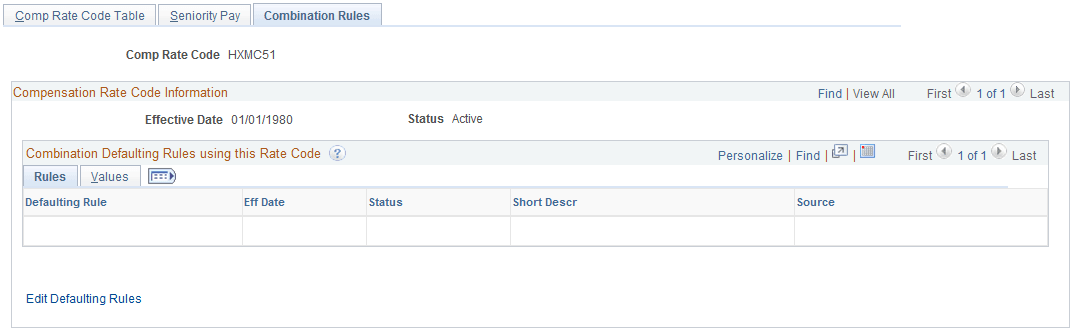

Comp Rate Code Table - Combination Rules Page
Use the Comp Rate Code Table - Combination Rules page (COMP_RATECD_RULES) to view defaulting rules associated with a compensation rate code.
Navigation:
Set Up HCM, and then Foundation Tables, and then Compensation Rules, and then Comp Rate Code Table, and then Combination Rules
This example illustrates the fields and controls on the Comp Rate Code Table - Combination Rules page.
Comp Rate Code Table - Combination Rules page: Rules tab
This page displays the combination defaulting rules that use this rate code.
Edit Defaulting Rules
Click to access the Rate Code Defaulting Rules - Rate Codes page, where you edit the information for the defaulting rules.
Values tab
Access the Comp Rate Code Table - Combination Rules page: Values tab.
This example illustrates the fields and controls on the Comp Rate Code Table - Combination Rules page: Values tab.
This page displays the compensation rate, currency and frequency as defined on the defaulting rule.
This page only displays combination defaulting rules, not salary step and job code defaulting rules.
