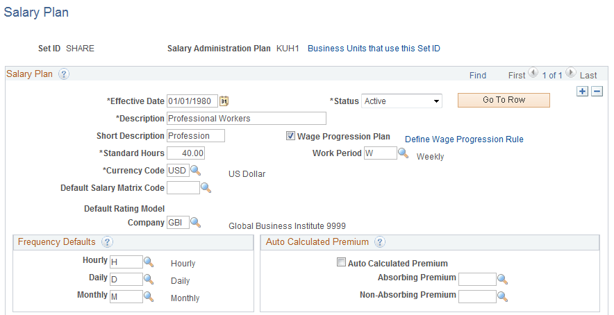

Salary Plan Page
Use the Salary Plan page (SALARY_PLAN_TABLE) to define salary plan basics.
Navigation:
  • Set Up HCM, and then Product Related, and then Compensation, and then Base Compensation, and then Salary Plan
  • Compensation, and then Base Compensation, and then Maintain Plans, and then Define Salary Plan
This example illustrates the fields and controls on the Salary Plan page (1 of 2).
This example illustrates the fields and controls on the Salary Plan page (2 of 2).
Salary Plan
Field or Control Description
Wage Progression Plan
Select this check box if you want to associate a wage progression rule to this salary administration plan.
The other fields on this page are discussed in the PeopleSoft Human Resources Manage Base Compensation and Budgeting: Define Salary Plan Page topic.

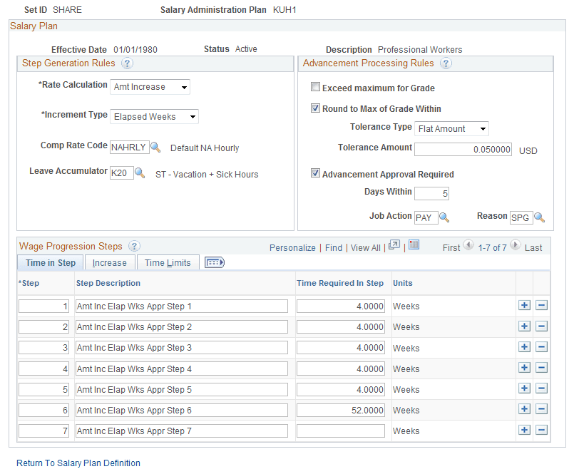

Define Wage Progression Rule Page
Use the Define Wage Progression Rule page (SALARY_PLAN_TABLE2) to define wage progression rules associated with a salary plan.
Navigation:
    Select the Wage Progression Plan check box. The system displays the Define Wage Progression link. Click this link to display the page.
This example illustrates the fields and controls on the Define Wage Progression Rules page.
Step Generation Rules
Rate Calculation
Select the method to calculate rates. These values are used during the generation of rate codes and values that appear on the Salary Grade Step Components page. Values are:
  • % Grade Max: Step rate will be the specified percentage of the grade's maximum rate.
  • % Grade Min: Step rate will be the specified percentage of the grade's minimum rate.
  • % Increase: A percentage-based increase will be added to the pay rate of the worker's previous step.
  • Amt Increase: A specific amount for the increase to be added to the pay rate of the worker's previous step.
    Note: For incremental calculation methods, the step generation process will store a step rate code value based on the grade's minimum rate. However, during the wage advancement process of calculating the worker's new step rate, incremental percentage or incremental amounts will be applied to the worker's actual rate for the rate code designated in the wage progression rule. For the Percentage of Maximum or Minimum and the User Defined types, the worker's new rate value comes from the stored grade step rate codes.
  • User Defined: Select this value if the step rates do not match the criteria of any of the other calculation methods.
    Rates must be manually entered on the Grade Step Components page.
Increment Type
Select the method required by your labor agreement to determine the manner in which a new hire or new-in-job worker is evaluated for advancement to the next pay step. Values are:
  • Elapsed Months: Select this method if you want to advance the worker based on a number of months since they entered their step.
  • Elapsed Weeks: Select this method if you to advance the worker based on a number of weeks since they entered their step.
  • Hours Worked: Select this method if you want to advance based on the worker's actual hours worked.
    An interface to Payroll for North America is delivered, however staging tables can accept data extracted from other time sources. Time can also be entered manually into the Review Wage Progression page.
Comp Rate Code (compensation rate code)
This rate code is inserted on the grade step during step generation and will store the calculated rate.
Hours Accumulator
Only available if you select an Increment Type of Hours Worked. Select the Payroll for North America Payroll special accumulator to use in order to capture the hours worked for this wage progression rule.
Leave Accumulator
(Optional) This field is only available if you select an Increment Type of Elapsed Months or Elapsed Weeks. This Payroll for North America special accumulator can capture reported leave hours. This is only required if your progression rule has a secondary qualifier to make sure a worker has not exceeded the specified number of leave hours during the required elapsed time in the step.
Advancement Processing Rules
Exceed maximum for Grade
(Optional) This field is only available if the calculation method is an increase type. Select this check box if it is acceptable for the worker's new step rate to exceed the maximum for the grade.
Round to Max of Grade Within (round to maximum of grade)
(Optional) This field is only available if the calculation method is an increase type. Select this check box if you want to round the calculated new rate value to the grade maximum value when it is within the specified tolerance.
Tolerance Type
This field indicates the closeness unit that you want the rounding rule to evaluate. Select one of these values:
  • Percent: Enter the percent for the tolerance.
    If you select this option, the Tolerance Percent field becomes available.
  • Flat: Enter the amount of the tolerance.
    If you select this option, the Tolerance Amount field becomes available.
Tolerance Percent
Enter the percent for rounding purposes. This field is available if you select Percent as a Tolerance Type.
Tolerance Amount
Enter the amount for rounding purposes. This field is available if you select Flat as a Tolerance Type.
Advancement Approval Required
(Optional) Select this check box if approval is necessary before step increases are awarded. When selected you must review and manually approve workers in order for the step advancement batch process to pick them up and perform the step and compensation updates.
To manually approve the advancement, use the Approve Employees to Advance page (Workforce Administration, and then Labor Administration, and then Wage Progression)., and then Approve Wage Advancement
If you select this check box, the Days Within: field becomes available.
Days Within
To present workers for approval prior to their estimated advancement date, enter the number of days prior to that date. The workers will be set to Almost Qualified status during the Update Wage Progression Qualification sub-process. You can then approve them early, if appropriate. This can facilitate timely processing of the step and rate increase and its recognition by payroll.
Job Action
Select a job action to be assigned by the advancement process when it inserts a new job row. Values come from the Actions page.
Reason
Select a related reason code from the values which come from Action Reason page.
Once workers have reached or exceeded the maximum rate for the grade, they are considered at parity for their job wage rate. When this occurs, the worker's step will be incriminated to the highest step for the grade and they will be placed on Stop Wage Progression and will no longer be processed by any of the wage progression processes.
Since the number of hours worked are accumulated in pay period increments, hours worked based rules assign the worker's advancement date as the start of their next pay period. Elapsed time based rules will assign the advancement date based on adding the required time in the step to the worker's step entry date.
Wage Progression Steps - Time in Step tab
Step
Enter the numerical value for the Step IDs in the order in which the wage progression rules should be generated.
Step Description
Enter a description for the step in this free form field.
Time Required in Step
Enter the amount of time that the worker must remain in the step before they can be advanced.
Units
The values are display only and are automatically generated depending on the Increment Type field.
Wage Progression Steps - Increase tab
Increase Amount
Enter the amount for the rate increase for this wage progression rule. The increase parameter will vary depending on the calculation method. For example, if the method is percent of grade maximum, the value will be a percent or if the method is incremental amount, the value will be an amount. The currency code of the Salary Plan applies.
Wage Progression Steps - Time Limits tab
(Optional) These limits are secondary rules that can be applied in addition to the primary time in the step requirements.
Time Limit
For Hour-based rules: Enter a numerical value for the calendar time limit associated with the time in step requirement.
Time Limit Units
Select the increment used for the time limit. Values are Days, Months, Weeks, and Years.
Maximum Leave Hours
For Elapsed Time based rules: Enter the maximum number of leave hours that are allowed at each step.
You must also define and associate a Payroll for North America Special Accumulator in the Leave Accumulator field.

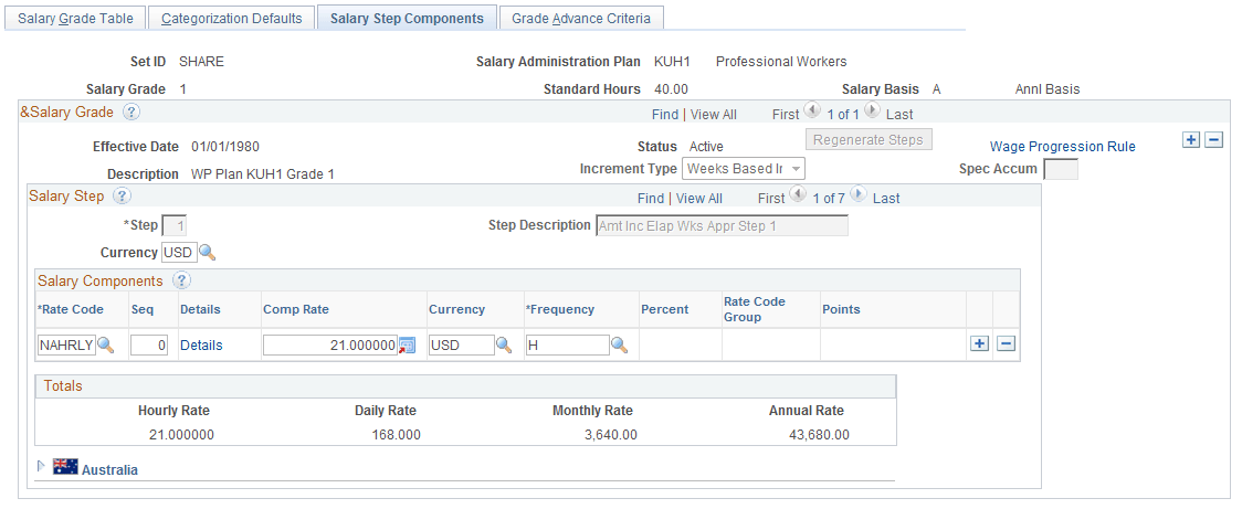

Salary Step Components Page
Use the Salary Step Components page (SALARY_GRADE_T3GBL) to generate salary steps using wage progression rules.
Navigation:
Compensation, and then Base Compensation, and then Maintain Plans, and then Define Salary Grades, and then Salary Step Components
This example illustrates the fields and controls on the Salary Step Components page.
Important:
You must include ranges for the minimum, midpoint, and maximum salary ranges on the Salary Grade Table page prior to generating steps.
Salary Grade
Spec Accum (special accumulator)
Displays the Hours Accumulator value which reflects the Hours Worked accumulator from the wage progression rule defined for the salary plan. Only applicable when Payroll for North America is used.
Generate Steps or Regenerate Steps
Click this button to calculate or recalculate the salary steps per the salary plan's wage progression rules. Click the View All in the Salary Step group box to review the generated step details.
The button changes to Regenerate Steps once you have saved the page.
Note: You should regenerate steps when you change the wage progression rule.
Click this link to access the Wage Progression Rules page where you can view wage progression rules associated with this salary grade.
Salary Step
You can manually add Salary Component rate codes if the step requires rate codes in addition to those defined on the wage progression rule.
Hours to Next Step Increment
Displays the number of hours that the worker must accumulate in this step before being eligible for the next step increment.
