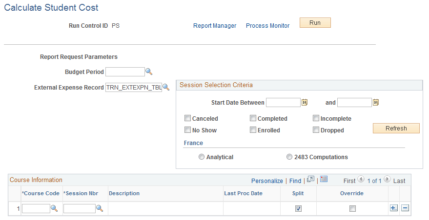

Calculate Student Cost Page
Use the Calculate Student Cost page (RUNCTL_TRN013) to run the Calculate Student Costs process before you review or update actual training costs at the employee level.
This process computes student costs by budget period for the course sessions that you specify as part of the process parameters.
Navigation:
Administer Training, and then Cost Analysis, and then Calculate Student Cost, and then Calculate Student Cost
This example illustrates the fields and controls on the Calculate Student Cost page. You can find definitions for the fields and controls later on this page.
Field or Control Description
External Expense Record
Students' travel and lodging expenses.
Note: When training expenses are managed by another system other than PeopleSoft, it is possible to import costs from the external system via a table. The table that is used as the interface between PeopleSoft and the other system should be filled with costs to be imported. When running the process, costs specified into this interface table are imported into TRN_EEEXPN_COST.
Session Selection Criteria
Start Date Between and and
Select the session start and end dates. When you select a budget period, these dates are populated with values from the Budget Information Table page.
Refresh
Click to populate all the sessions with a similar session start date into the specified dates.
Cancelled, Completed, Incomplete, No Show, Enrolled, and Dropped
Select to include students with each status for the selected course and session.
France
Select either the Analytical button or the 2483 Computations button.
Select Analytical to view all the crtieria available.
When 2483 Computations is selected, those criteria that are unavailable are greyed out .
Course Information
Course Code
The system displays courses that have completed sessions for the selected budget period only.
Session Nbr (session number)
Select from the list of completed sessions.
Last Proc Date (last process date)
Displays the date that you last ran the Compute Student Cost process for the specified course session and budget.
Split
Select to proceed with the process and populate the Track Student Cost pages with the process calculation results.
Override
The process does not automatically alter costs entered manually into the Track Student Costs page (when the Data Override check box is selected on that page). To force the process to store computed costs into the Trainees Salary Costs page, select this check box.

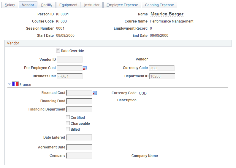

(FRA) Maintain Student Costs - Vendor Page
Use the Maintain Student Costs - Vendor page (TRN_EE_SESSN_CST3) to review and update the vendor costs resulting from the Compute Student Costs process.
Navigation:
Administer Training, and then Cost Analysis, and then Maintain Student Costs, and then Vendor
This example illustrates the fields and controls on the Maintain Student Costs - Vendor page. You can find definitions for the fields and controls later on this page.
Define additional vendor information to be tracked for legal reporting.
Certified, Chargeable and Billed,
For legal reports, select any check box that is applicable.
Date Entered
Enter date that the invoice was entered for the vendor.
Note: The Date Entered field is activated when the Billed date is activated. This is 2483 specific. To be chargeable, a vendor should be certified, chargeable, have an invoice with the Billed date included within the declaring year and a valid agreement number should be specified if the Vendor Type is Consulting Firm or Training Provider.
Agreement Date and Company
Enter the agreement date and the name of the company that signed the agreement.

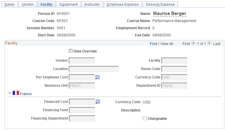

(FRA) Maintain Student Costs - Facility Page
Use the Maintain Student Costs - Facility page (TRN_EE_SESSN_CST5) to review and update the facility costs resulting from the Compute Student Cost process.
Navigation:
Administer Training, and then Cost Analysis, and then Maintain Student Costs, and then Facility
This example illustrates the fields and controls on the Maintain Student Costs - Facility page. You can find definitions for the fields and controls later on this page.

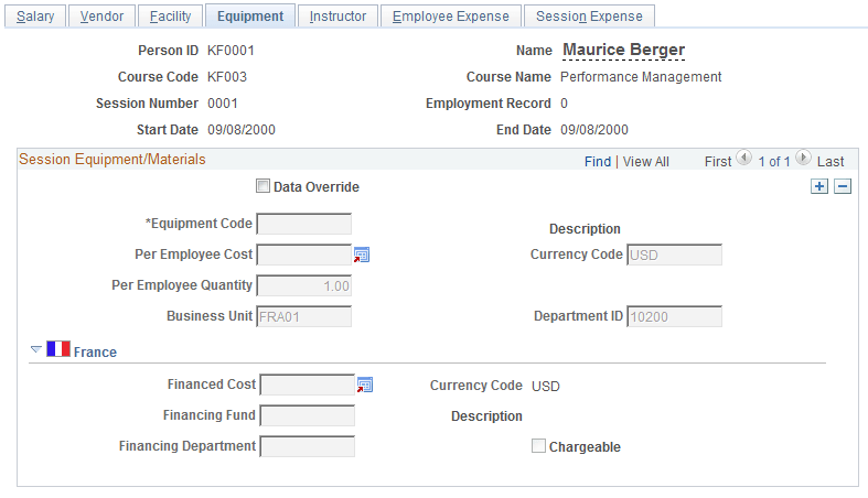

(FRA) Maintain Student Costs - Equipment Page
Use the Maintain Student Costs - Equipment page (TRN_EE_SESSN_CST7) to review and update training equipment and materials costs resulting from the Compute Student Cost process.
Navigation:
Administer Training, and then Cost Analysis, and then Maintain Student Costs, and then Equipment
This example illustrates the fields and controls on the Maintain Student Costs - Equipment page. You can find definitions for the fields and controls later on this page.
