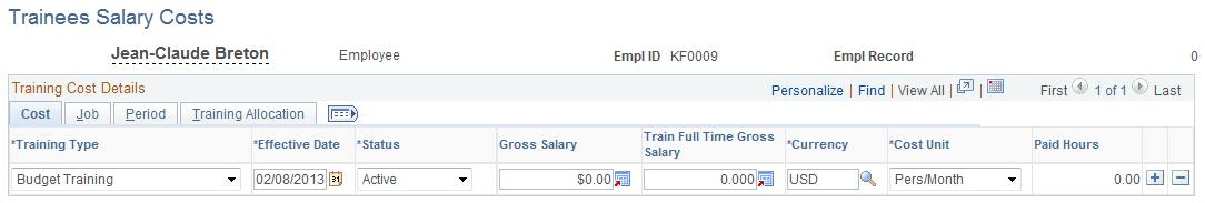

Trainees Salary Costs Page
Use the Trainees Salary Costs page (TRN_EE_SALARY_COST) to identify the cost of having an employee in training.
Navigation:
Set Up HCM, and then Product Related, and then Enterprise Learning, and then Trainees Salary Costs, and then Trainees Salary Costs
This example illustrates the fields and controls on the Trainees Salary Costs page. You can find definitions for the fields and controls later on this page.
Common Page Information
Field or Control Description
Training Type
Select one of these options:
Gross Salary
Enter the employee's gross salary before deductions.
Train Full Time Gross Salary
If the employee works full time for the training department, enter the gross salary.
If you select the Full-Time Instructor check box on the Instructor page, the payroll system considers that instructor full-time.
Paid Hours
Enter the total number of hours the employee works for the related cost unit. For example, if the cost unit is Pers/Month, then the number of hours is related to one month.
If you selected Apply on Jobcodes or Apply on Employees enter the number of hours that the employee worked.
If you selected Load from Global Payroll the system displays the value that is retrieved by the Salary Cost Mass Update process. You cannot change the value here.
Job tab
Job Code
Displays the employee's job code from the Job Data table.
Period tab
Period Begin Date
This field is used for the effective date and the effective date is always equal to the period begin date.
Period End Date
Enter the end of the period in which the cost that you specified becomes effective.
If you have separate costs for Administer Training and Budget Training, the period over which costs apply varies. Administer Training costs cover pay periods, whereas Budget Training costs apply to budget periods, which normally cover a year. Be sure that all these periods are contiguous to ensure accuracy in total compensation.
Calc. Flag (calculate flag)
This field identifies the source of the cost information:
Manually, indicates that the employee's cost data was manually entered on this page.
Job Code, Employee, or Payroll, indicate that the data was loaded by the Salary Cost Mass Update process that you run from the Update Salary Costs page.
Company
Select the employee's company.

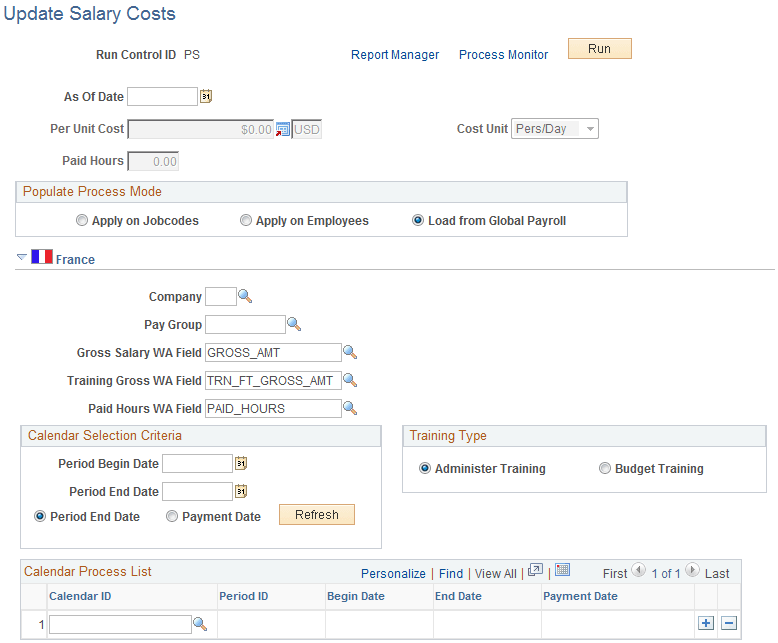

Update Salary Costs Page
Use the Update Salary Costs page (RUNCTL_TRN006) to process training costs for a group of job codes or employees.
Navigation:
Administer Training, and then Define Budget, and then Update Salary Costs, and then Update Salary Costs
This example illustrates the fields and controls on the Update Salary Costs page. You can find definitions for the fields and controls later on this page.
The Job Code Salary Costs and Trainees Salary Costs pages enable you to associate payroll costs with a job code and by employees one at a time. Use the Update Salary Cost process to specify a per cost figure and a cost unit metric to apply on the specified effective date to a group of job codes or employees.
As Of Date
Enter the effective date for this process. This date is used to Effective Date and Period Begin Date.
Per Unit Cost
Enter the cost to use for processing the cost per job or cost per employee.
(FRA) Selecting Load from Global Payroll disables this field.
Populate Process Mode
Apply on Jobcodes
Select to apply the cost to employees with a specified job code.
Apply on Employees
Select to apply the cost to given employees.
(FRA) Load from Global Payroll
Select to apply costs from Global Payroll for France to a group of employees. The system displays the France group box.
Set ID and Job Code
This group box appears when you select Apply on Job Code or Apply on Employees. Select the set ID and job code to which you want to apply the selected cost. Add as many setIDs and job codes as necessary.
(FRA) France
This section becomes available when you select Load from Global Payroll.
In Global Payroll for France, writable array elements are used to store payroll results. The payroll system computes the salary and paid hours for training, and uses the writable array, FOR WA 2483, to store the results in the GPFR_TRN_WA record. When you run the Update Salary Costs process, salaries and paid hours are imported from the writable array.
This is a single table which interfaces between the payroll system and the training business process. When using a payroll system other than PeopleSoft, the table can be used to import salaries into the training business process.
See PeopleSoft Global Payroll for France: Accruals and PeopleSoft Global Payroll for France: Paid Vacation Accruals Calculations.
Calendar Selection Criteria
In this group box, define the criteria for selecting the payroll calendars
Period Begin Date
Select the period begin date for salary training costs, usually the beginning of the fiscal year.
Period End Date
Select the period end date for salary training costs, usually the end of the fiscal year.
Period End Date and Payment Date
Select the date thatPeopleSoft Global Payroll for France: Accruals signifies the end of the period.
Refresh
Click to have the system insert all payroll calendars that occur within the specified period into the Calendar Process List
Calendar ID
Select a Calendar ID that defines the time range in which salary costs are being defined.
Period ID
The system enters a Period ID for the salary costs being calculated during this time range.
See PeopleTools: Process Scheduler.
