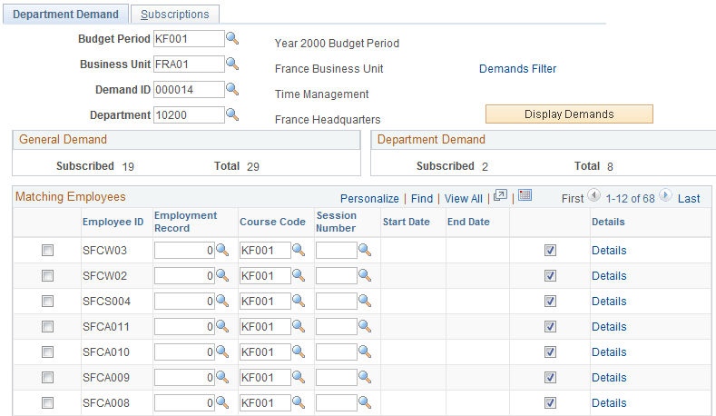

This example illustrates the fields and controls on the Department Demand page (1 of 2). You can find definitions for the fields and controls later on this page.

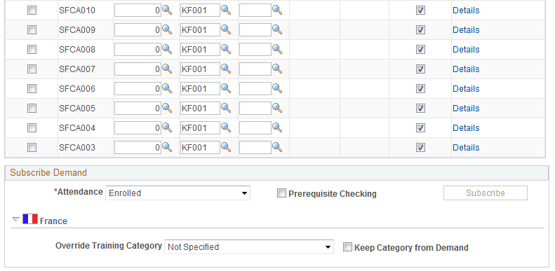

This example illustrates the fields and controls on the Department Demand page (2 of 2). You can find definitions for the fields and controls later on this page.

Enter the department code for the students to enroll in a session. You can select only from the departments that are included in the demand ID that you specified. When you move out of the Department field, the system makes the Display Demands button available.

To limit the search further, click this link to access the Demands Search Criteria page and specify a category or subcategory from the training catalog. You can also specify a course and approved demands only.
To limit demands using selection criteria after you click the Display Demands button, cancel the page and start again.
Display Demands
Click to populate the Matching Employees group box with employees who meet the selection criteria (such as department and job codes) that are defined in the demand ID.
General Demand
Displays the number of employees to be trained for this job code.

Details
Click to access the Department Demand - Employee / Course Details page and view the employee's name and the details of the course session that you selected.
Subscribe Demand
In this group box, you enroll employees or add them to the course or session waiting list.
Field or Control Description
Attendance
Select from one of the following valid statuses:
Crse Wait (course wait-listed), Enrolled, and Sessn Wait (session wait-listed).
If you've already found matching employees and have reset the Attendance field, the system clears any session information that you entered.
Prerequisite Checking
Select to verify whether students have met the prerequisites for a course specified in the Course table. Students who haven't met the prerequisites won't be enrolled in the course when the system processes the request.
Subscribe
Click this button once you have selected the employees to enroll or add to the waiting list. Depending on the attendance value that you selected, the system enrolls or wait-lists students for whom you selected the Do check box.
(FRA) France
Override Training Category
To override the training category that is associated with the training demand, select the category here.
Keep Category From Demand
Select this option to retain the training category that is associated with the training demand.

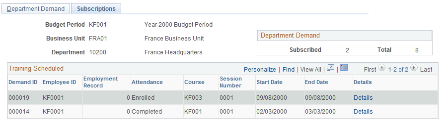

Use the Department Demand - Subscriptions page (TRN_GNRL_TRAIN_SUB) to view subscribed employee information for students who successfully subscribed to the courses and sessions that you selected on the Department Demand page.
Check their status and the course enrollment dates.

This example illustrates the fields and controls on the Enroll by Department Demands - Subscriptions page. You can find definitions for the fields and controls later on this page.
The system lists employees who were enrolled or wait-listed in the courses and course sessions that you selected on the Department Demand page.
Click the Details link to access the Employee / Course Details page and view the employee's name and the details of the course session.
