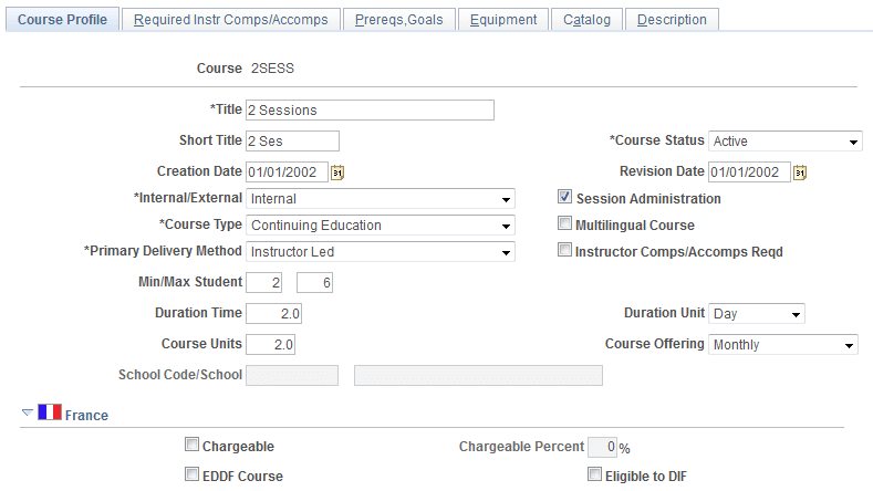

Courses - Course Profile Page
Use the Courses - Course Profile page (COURSE_TABLE1_GBL) to define general course information.
Navigation:
Set Up HCM, and then Product Related, and then Enterprise Learning, and then Courses, and then Course Profile
This example illustrates the fields and controls on the Courses - Course Profile page. You can find definitions for the fields and controls later on this page.
Field or Control Description
Title and Short Title
Enter the course title and an abbreviated title.
Course Status
Select from:
Active: The course is currently available, and you can set up a course session.
Inactive: You cannot set up a course session
Proposed: The course is not yet available. You can't set up a course session.
Creation Date
If you're setting up a new course, the system date (usually today's date) appears by default. You can change it.
Revision Date
Enter a revision date when you make changes to an existing course.
Internal/External
Select Internal if the course is held in-house and External if the course is held offsite.
Session Administration
With Session Administration selected, you can create course sessions, set up waiting lists, enroll students in courses, and send out form letters.
You can select Session Administration for internal and external courses.
Note: If you can't find a session when you're administering course sessions in the Administer Training business process, check to see if Session Administration is selected for the course code, or check to see if the course session is active.
Course Type
Use this field to categorize the courses. It doesn't affect the way that you administer the course in Human Resources.
Select from:
Contin Ed: Continuing education.
Comp check: Competency check.
Functional
Mgmt Devel: Management development.
Skill Dev: Skill development.
Supv Skill: Supervisory skills.
Technical
Multilingual Course
Select if the course is offered in multiple languages. This check box is available if you selected Session Administration.
Primary Delivery Method
Select from:
Audio: For audio training, such as language tapes.
Computer: For computer-based training.
Instructor : For instructor-led courses.
On-the-Job: For on-the-job training.
Video: For video-based training.
Workbook: For self-taught courses with workbooks.
Instructor Comps/Accomps Req (instructor competencies/accomplishments required)
Select to define a set of instructor competencies and accomplishments for the course. This check box is only available if the Primary Delivery Method is Instructor. Selecting this check box makes the Required Instr Comps/Accomps page available.
Min/Max Students (minimum/maximum students)
Enter the minimum and maximum number of students that can enroll in the course.
Duration Time
Enter the duration of the course.
Duration Unit
If you completed the Duration Time field, select the unit in which duration time is measured.
Course Units
Enter the number of course units for external courses.
Course Offering
Indicate how often the course is offered.
School Code/School
This field is not available for internal courses.
For external courses, enter details of the school in the School Code or School field.
If the school doesn't have a code, leave the School Code field blank and enter the school name in the School field.
(FRA) France
The fields in this group box pertain to French regulatory reporting requirements.
Chargeable
Select to have the costs that you enter for this course treated as chargeable, by default, for 2483 reporting. The Compute Student Cost process will consider this option when splitting the training cost by student.
Chargeable Percent
Specify the percentage of this course's time that a student must attend for the course to be considered chargeable. For example, a value of 80% indicates that a student must attend at least 80% of the course for the course to be chargeable.
EDDF Course
Select if this course is eligible for funding under the Engagement De Développment de la Formation (EDDF). Costs related to EDDF courses appear on the 2483 report in Group C – Line 7.
Eligible to DIF
Select to enable students to request the use of DIF entitlement for this course and to enable administrators to record the DIF hours taken.

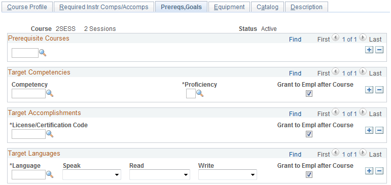

Courses - Prereqs,Goals Page
Use the Prereqs,Goals (prerequisites, goals) page (COURSE_TABLE2) to specify the courses that a student must complete before taking this course, as well as target skills and certifications.
Navigation:
Set Up HCM, and then Product Related, and then Enterprise Learning, and then Courses, and then Prereqs,Goals
This example illustrates the fields and controls on the Prereqs,Goals page. You can find definitions for the fields and controls later on this page.
Prereqs,Goals page
Prerequisite Courses
Before you can select courses as prerequisites, you have to create them using the Course table. Enter the basic courses first and work your way up to the courses that require prerequisites.
Target Competencies
Competency
Select a target competency. Competencies are defined in the Content Catalog, which is part of the Manage Profiles business process.
Proficiency
Select the default proficiency level for a competency that the student receives upon completing the course. For example, a beginner's course competency might give a rating of Fair, while an advanced-level course competency could warrant a rating of Expert.
Grant to Empl after Course (grant to employee after course)
Select to have the system add the selected competency to the employee's profile and set the specified proficiency rating upon completing the course. The system adds the competency to the employee's profile with the profile type PERSON. Competencies that are automatically assigned to an employee's profile have the evaluation type Approved/Official.
Target Accomplishments
License/Certification Code
Select a code if students are awarded a license or certification upon completion of the course.
Select to have the system update employees' profiles upon course completion. The system adds the accomplishment to the employee's profile with the profile type PERSON.
Target Languages
Language
Select a language.
Speak, Read, Write
Select High, Moderate, or Low in each field to indicate the level of proficiency that you expect students to have achieved upon completion of the course.
