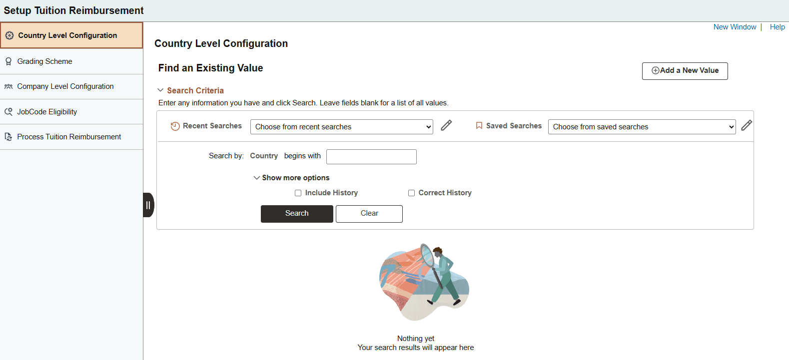

Setup Tuition Reimbursement Navigation Collection
Use the Setup Tuition Reimbursement navigation collection to view a collection of Tuition Reimbursement setup components.
Navigation:
  • Workforce Administration, and then Setup Tuition Reimbursement
  • Perform a global search from the main banner header for the Setup Tuition Reimbursement navigation collection.
This example illustrates the Setup Tuition Reimbursement navigation collection.
This navigation collection enables administrators to access the following setup pages to configure tuition reimbursement settings:

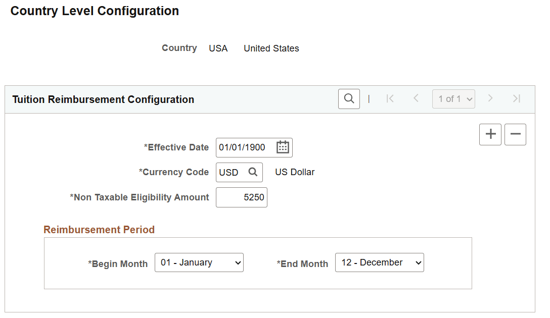

Country Level Configuration Page
Use the Country Level Configuration page (HRTR_COUNTRY_CFG) to define basic country reimbursement configuration settings, such as the period, currency, and non taxable eligibility amount.
Navigation:
  • Workforce Administration, and then Setup Tuition Reimbursement , and then Country Level Configuration
  • Perform a global search from the main banner header for the Setup Tuition Reimbursement navigation collection. Select the Country Level Configuration option from the left panel.
This example illustrates the fields and controls on the Country Level Configuration page.
Field or Control Description
Non Taxable Eligibility Amount
Enter the non-taxable tuition reimbursement limit defined by the government for an employer's educational assistance program. Any amount above this limit is typically considered taxable income.
When the limit changes, insert a new row and enter the effective date of the limit change.
Begin Month and End Month
Enter the start and end months for a tuition reimbursement period. Any requests entered after these dates will apply toward the next year's reimbursement period.

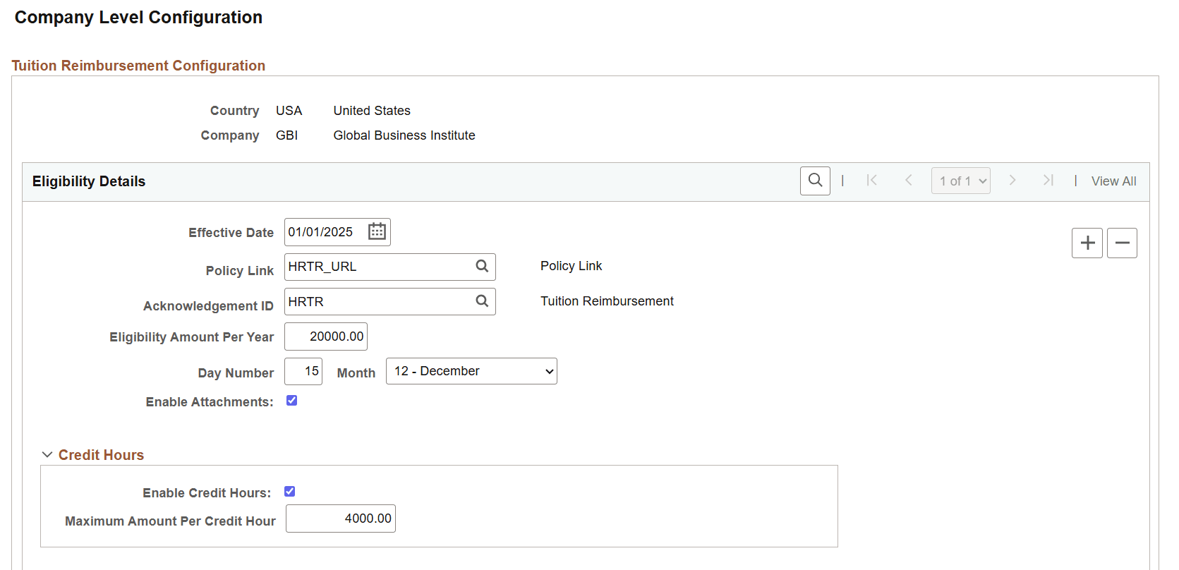

Company Level Configuration Page
Use the Company Level Configuration page (HRTR_CONFIG_PG) to define a company reimbursement rules, like eligibility details, credit hours, payroll data, expense and reimbursement types, and approvals.
Navigation:
  • Workforce Administration, and then Setup Tuition Reimbursement , and then Company Level Configuration
  • Perform a global search from the main banner header for the Setup Tuition Reimbursement navigation collection. Select the Company Level Configuration option from the left panel.
This example illustrates the fields and controls on the Company Level Configuration page (1 of 3).
This example illustrates the fields and controls on the Company Level Configuration page (2 of 3).
This example illustrates the fields and controls on the Company Level Configuration page (3 of 3).
Eligibility Details
Policy Link
Enter the URL identifier of where the tuition reimbursement policy is located. This will appear as a link on the Tuition Reimbursement (Details) Page and the Pending Approvals - Pre-Authorize Tuition or Reimburse Tuition Page to aid the user when creating or approving a reimbursement request.
Acknowledgement ID
Enter the acknowledgement ID containing the information that an employee will need to acknowledge and accept prior to creating a reimbursement request. The text you select will appear on the Tuition Reimbursement (Acknowledgement) Page.
Leave this field blank to have requesters bypass the acknowledgement step. They will not be required to agree to any information and will be taken directly to the Reimbursement Type Page when initiating a request.
You create acknowledgement IDs on the Enterprise Components: Acknowledgement Configuration Page.
Eligibility Amount Per Year
Enter the amount the organization allows annually for tuition reimbursement.
Note: You can override this amount for a job code using the JobCode Eligibility Page. The limit you enter for the job code will override the company limit.
Annual Cut Off day and Month
This is a required field.
Enter the day and month all reimbursement requests should be submitted for the year. Any reimbursement requests approved after this date will be applied to the next year's reimbursement period.
If your organization does not have a specific cut-off day, enter the last day of the reimbursement period.
Enable Attachments
Select to allow the user to upload attachments when creating a reimbursement request. This displays the Attachments section on the Tuition Reimbursement (Details) Page.
Deselect this option to hide the Attachments section on the user page and disable attachments.
Credit Hours
Use this section to limit the cost of training by course credit.
This information applies to reimbursement types that have the Add Courses option selected within the Reimbursement Types section of this setup page. By enabling credit hours, the user can enter the credits given for training. The system uses this information to verify that it does not exceed the maximum per credit amount defined in this section.
Enable Credits Hours
Select to limit the cost of course expenses by credit hours.
When you select this option, the Maximum Amount Per Credit Hour field becomes available for entry. Selecting this option will also display the Credit Hours field to the requester in the Course Information section of the Tuition Reimbursement (Details) Page.
This field is available when you select Enable Credits Hours.
Enter the maximum amount that is allowed for each credit hour. When a user enters the credits and cost of a course in the Course Information section, the system divides the cost of the training by the credit hours and verifies that it does not exceed the maximum per credit amount defined in this section. For example, if the maximum limit per credit is set to $1,000 and the requestor enters a 2 credit course that costs $2,500, the system will issue a warning that the amount exceeds the $1,000 per credit maximum ($2,500/2 = $1,250). If the user enters the amount of $2,000 for the same course, the system allows the expense, provided it meets all other eligibility amounts.
Note: Credit hour amounts must be within the overall eligibility limit setup when a user enters a request.

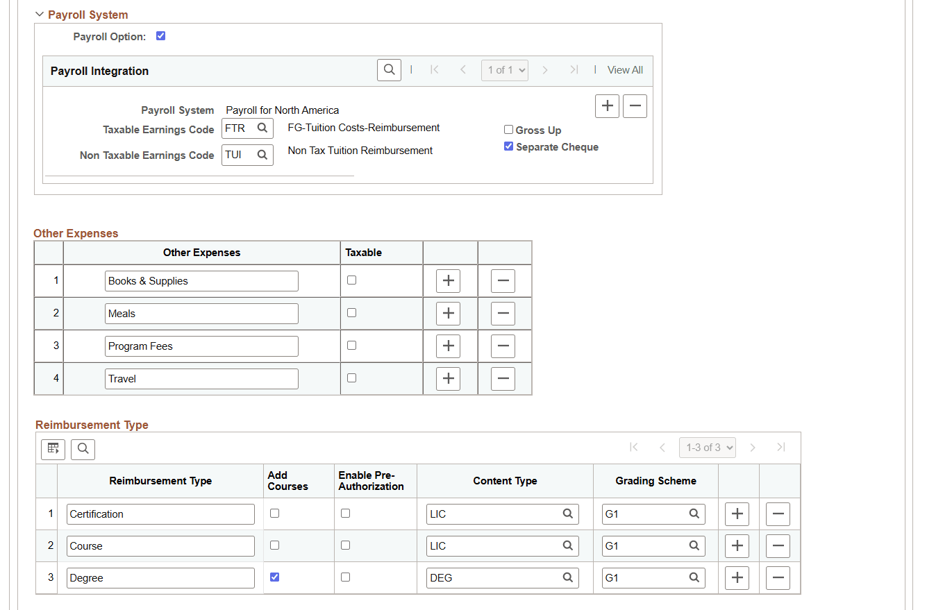

Payroll System
Payroll Option
Select to integrate with your Payroll for North America system. When you select this option, the remaining fields in this section become available for entry.
Payroll System
Displays the payroll system.
Note: Currently, this feature only uses the PeopleSoft Payroll for North America system.
Taxable Earnings Code
Enter the earnings code for expenses that are considered taxable earnings. The HRTR_PROCESS process assigns the codes to the expenses when you submit information to payroll (see Process Tuition Reimbursement Page).
Non Taxable Earnings Code
Enter the earnings code for expenses that are considered non taxable earnings. The HRTR_PROCESS process assigns the codes to the expenses when you submit information to payroll (see Process Tuition Reimbursement Page).
Gross Up
Select to gross up a person's reimbursement check so the system calculates the before-tax earnings needed to provide a specific take-home payment.
Separate Cheque
Select if reimbursements should be delivered as a separate check and not with the regular payroll check.
Other Expenses
Other Expenses
Enter additional expense types that your organization allows for reimbursement, like books or meals.
Taxable
Select if this expense is taxable. This information will be used to calculate the annual non taxable eligibility amount as well as assign earnings codes when you submit the expenses to payroll.
Reimbursement Type
Use this section to identify the types of reimbursements that allow a user to enter multiple courses for training, such as for a degree or program, if the training needs to be pre-approved prior to taking a course, and associate a profile content type to the training.
Reimbursement types are required to create tuition requests.
Reimbursement Type
Enter reimbursement types that categorize the type of training your employees can take, such as certifications, courses, or degrees. The user will select from these types on the Reimbursement Type Page when creating a request. It also groups a person's requests into categories on the Tuition Reimbursement (Landing) Page.
Add Courses
Select to allow the user to enter multiple courses for a reimbursement type, such as for a degree or program.
Note: You must select this option to enforce the maximum amount per credit hour, if enabled in this setup.
Enable Pre-Authorization
Select to require that employees receive pre-authorization before taking training.
When enabled and a tuition request is submitted, the request will go through an approval process prior to the employee submitting a request for reimbursement.
Content Type
Enter the content type from the Manage Profile system. For more information on content types, see PeopleSoft Human Resources Manage Profiles: Understanding the Content Catalog and PeopleSoft Human Resources Manage Profiles: Understanding Managing Profiles.
Grading Scheme
Select the grading method your organization accepts for a reimbursement type. This could include a letter grade, pass/fail, or something else. These are defined on the Grading Scheme Page and will be available for a request on the Tuition Reimbursement (Details) Page.

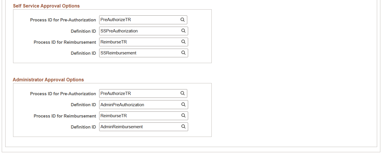

Self Service Approval Options
Use this section to define the employee self service approval processes.
Oracle provides demo-data where pre-approvals involve a one-step authorization process that is sent to the manager, while reimbursement requests use a two-step authorization process, sending the request first to the manager and then to the tuition reimbursement administrator.
Approvals are required to submit tuition reimbursement requests.
Process ID for Pre-Authorization
Associate the pre-approval transaction process ID that should be used when an employee creates a reimbursement request.
Definition ID
Enter the definition ID to be used to process the pre-approval of a reimbursement.
Process ID for Reimbursement
Associate the reimbursement approval process ID that should be used for an employee reimbursement request.
Definition ID
Enter the definition ID to be used to process the approval for the employee request.
Administrator Approval Options
Use this section to define the administrator approval processes.
Associate the pre-approval transaction process ID that should be used when an administrator creates a reimbursement request for a person.
Definition ID
Enter the definition ID to be used to process pre-approval of a reimbursement request from an administrator.
Associate the reimbursement approval process ID that should be used for an administrator's reimbursement request on behalf of an employee.
Definition ID
Enter the definition ID to be used to process the approval for an administrator's reimbursement request on behalf of an employee.
