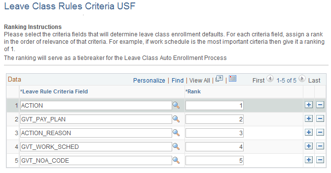

Leave Class Rules Criteria USF Page
Use the Leave Class Rules Criteria USF page (GVT_LVCLSRUL_TMPLT) to rank five rules criteria for the purpose of breaking ties if an employee qualifies under more than one leave class rule.

This example illustrates the fields and controls on the Leave Class Rules Criteria USF page. You can find definitions for the fields and controls later on this page.
Set up the Leave Class Rules template only once.
Field or Control Description
Leave Rule Criteria Field
Select the PAR criteria and rank them on this page. These criteria correspond to the PAR Criteria fields on the GVT Leave Class Rules page, where you select values for each criterion. The criteria that you select and rank are:
ACTION: action
ACTION_REASON: action/reason.
GVT_NOA_CODE: nature of action code.
GVT_PAY_PLAN: pay plan.
GVT_TYPE_OF_APPT: type of appointment.
GVT_WORK_SCHED: work schedule.
Rank
Rank each criterion in order from 1 to 5, with 1 being the highest rank. The single rule where the employee transaction meets the highest-ranking criteria is the rule the system uses as a tiebreaker if an employee qualifies under more than one rule.

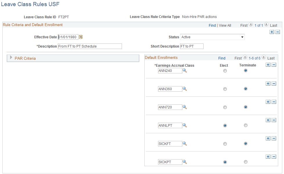

Leave Class Rules USF Page
Use the Leave Class Rules USF page (GVT_LV_CLS_RULES) to define your organization's rules for enrolling or terminating an employee from an earnings (leave) accrual class.
Navigation:
Set Up HCM, and then Product Related, and then Workforce Administration, and then Absence, and then Leave Class Rules USF, and then Leave Class Rules USF
This example illustrates the fields and controls on the Leave Class Rules USF page. You can find definitions for the fields and controls later on this page.
Leave Class Rule ID
Identify each leave class rule you create.
Leave Class Rule Criteria Type
Assign a type to each new rule when you first enter the page. This value determines which additional fields are available on the page. Values are:
Hire/Rehire: for rules associated with hire or rehire actions.
Leave Program Status: for rules associated with leave bank and transfer processing.
Non-Hire PAR actions: for rules associated with PAR actions that are not hire or rehire.
The value you select in the Leave Class Rule Criteria Type field affects which group boxes appear on the page.
Leave Class Rule Criteria Type Group Boxes
Hire/Rehire or
PAR Criteria
Default Enrollments
Leave Program
Default Enrollments
PAR Criteria
Only the criteria you selected and ranked on the Leave Class template appear in this group box. Select a value for a criterion if you want to process leave enrollment based on a designated value for that criterion under this rule. The system processes enrollments based on the value of this field in the employee's PAR transaction.
Default Enrollments
Earnings Accrual Class
Select the earnings accrual classes that apply to this rule.
Elect
Select to enroll employees in the earnings accrual class by this rule's criteria.
Terminate
Select to terminate employees from the earnings accrual class by this rule's criteria.

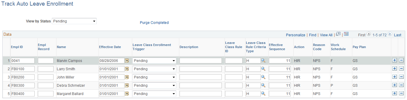

Track Auto Leave Enrollment Page
Use the Track Auto Leave Enrollment page (GVT_LVCLS_TRGR) to review the results of the Leave Class Auto Enrollment process.
Navigation:
Workforce Administration, and then Leave Administration USF, and then Manage Leave Information, and then Track Auto Leave Enrollment, and then Track Auto Leave Enrollment
This example illustrates the fields and controls on the Track Auto Leave Enrollment page. You can find definitions for the fields and controls later on this page.
Not all page elements are visible on this page. Depending on the page arrangement, you see additional elements by scrolling either vertically or horizontally.
Use this page to view the outcome of each transaction that was processed by the Leave Class Auto Enrollment process.
View by Status
Select a value to sort the data by status (Leave Class Enrollment Trigger). Values are: Completed, Error, or Pending.
The system records employees on this table with the status of Pending as soon as a PAR action is completed or the employee is approved into a leave program.
The status changes to Completed when the auto enrollment process is complete.

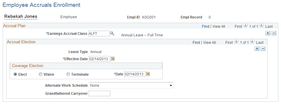

Employee Accruals Enrollment Page
Use the Employee Accruals Enrollment page (GVT_ACCR_PLAN) to adjust employee enrollment in earnings accrual classes if there is a reason to override the automatic enrollment.
If your organization does not use the automatic leave enrollment process, use this page to enroll employees in accrual classes.

This example illustrates the fields and controls on the Employee Accruals Enrollment page. You can find definitions for the fields and controls later on this page.
Accrual Plan
Select an earnings accruals class. The classes you created on the Earnings Accruals Class table are displayed.
Accrual Election
Leave Type
The leave type defaults from the accrual calculation box on the Earnings Accruals − Class Page.
Election
Select the enrollment status.
Select Elect to enroll the employee in a class.
Select Waive to waive a leave just like a regular benefit.
Select Terminate to end the employee's enrollment in a class.
Elect Date
Enter the date on which the accrual election change occurs.
Effective Date
Select a date to specify when this accrual election becomes effective and the employee will be in the new earnings accrual class.
Alternate Work Schedule
The purpose of the alternate work schedule is for those employees on the Credit Leave Accrual. When the employee's work schedule changes, the system creates an additional pay record for them to pay out their current balance.
Grandfathered Carryover
Enter the grandfathered carryover here, if applicable. A grandfathered carryover is when an employee has a balance greater than the new earnings accrual-ceiling amount. For example, an employee who carried an annual leave balance of 360 hours in a previous class can transfer to a new class that has a ceiling of 240 hours. The difference of 120 hours between the new ceiling amount and the current balance of 360 is called the Grandfathered Carryover.
