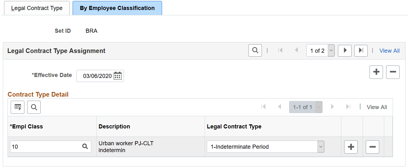

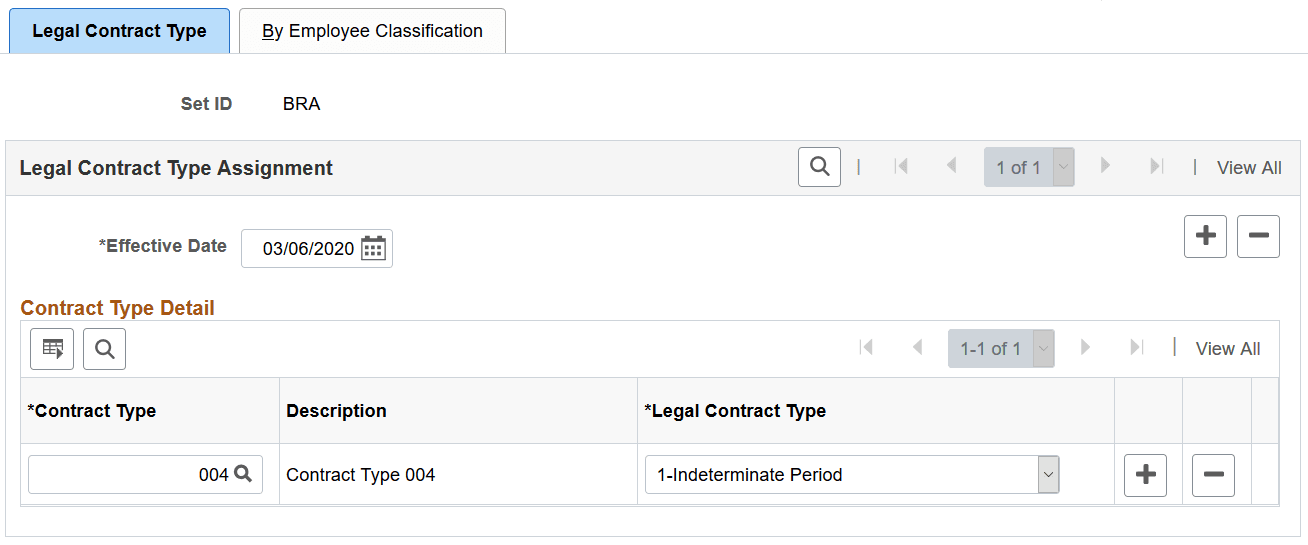

Legal Contract Type Page
CNT_TYPE_BRA
Associate contract types with legal contract types.
By Employee Classification Page
CNT_TYPE_EC_BRA
Associate employee classes with legal contract types.

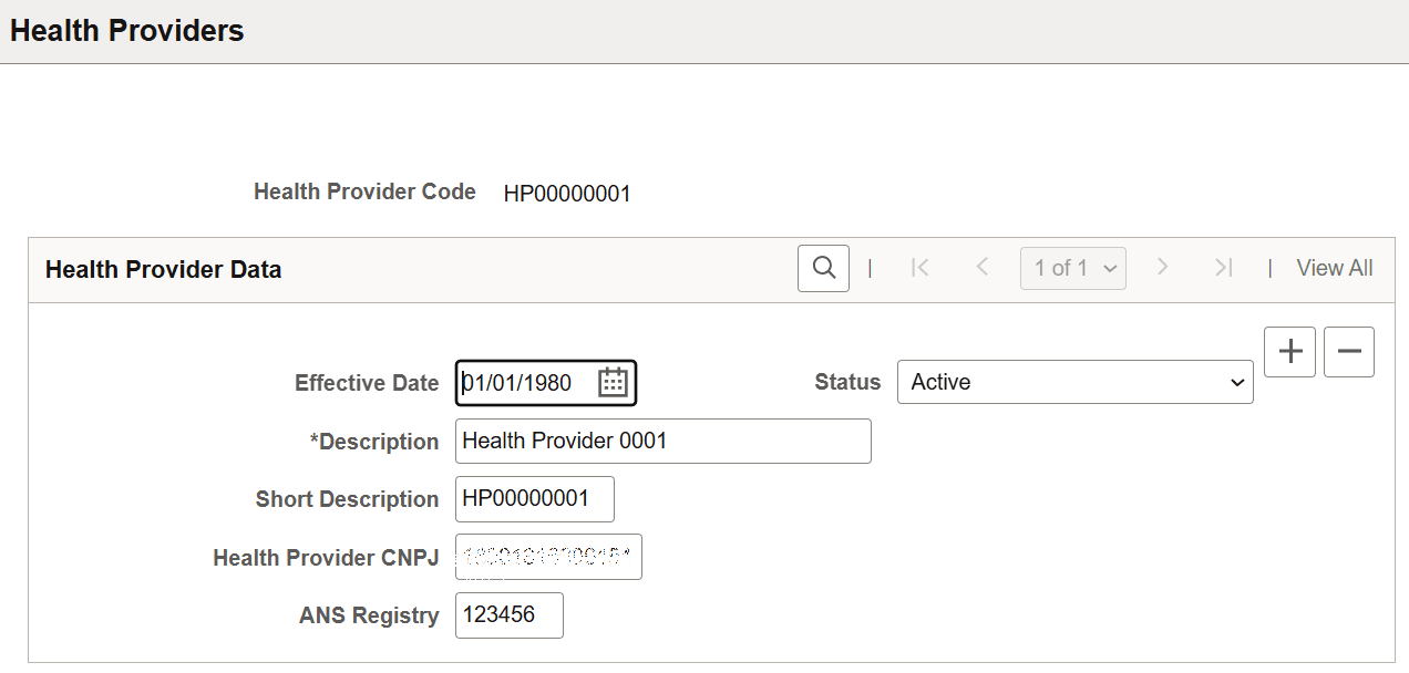

Health Providers Page
HEALTH_PROV_BRA
Define health provider codes.

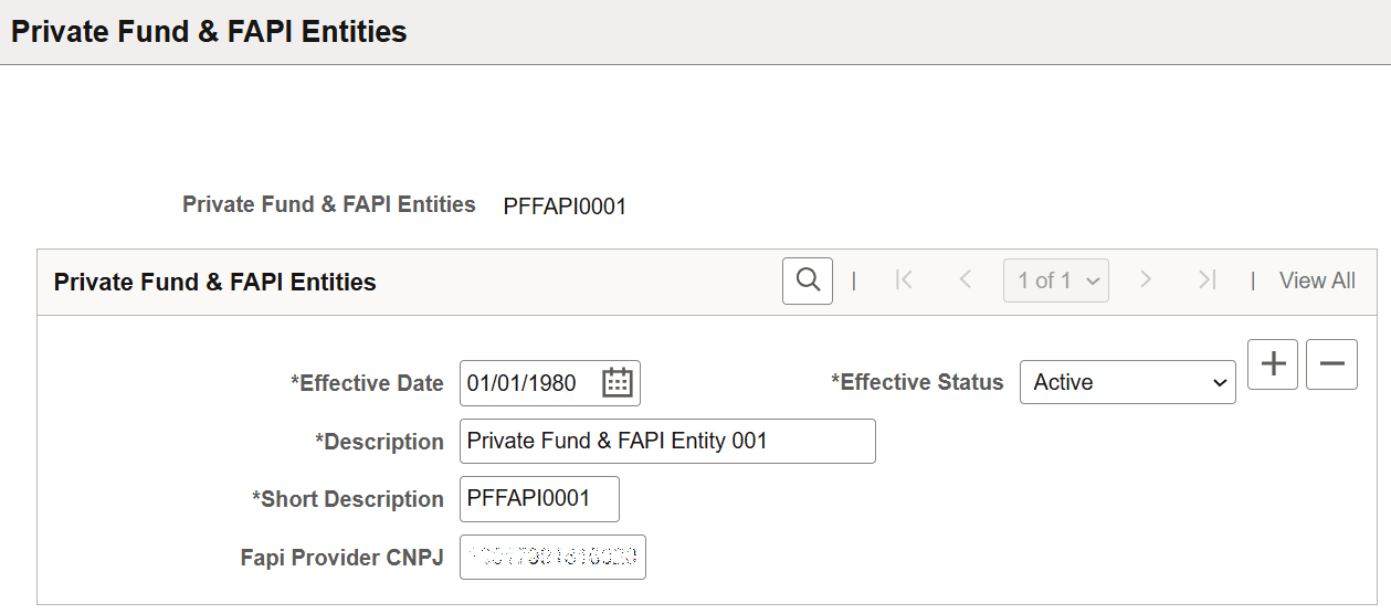

Private Fund & FAPI Entities Page
FAPI_PROV_BRA
Specify private pension funds and associated CNPJ numbers.

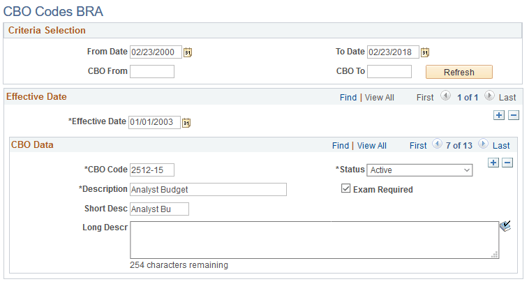

CBO Codes BRA Page
CBO_CD_TBL_BRA
Define occupational codes.

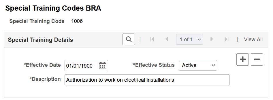

Special Training Codes BRA Page
SPECIAL_TRAIN_BRA
Define special training codes.

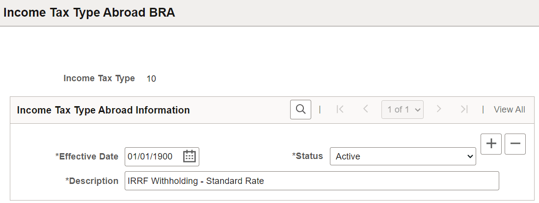

Income Tax Type Abroad BRA Page
INC_TAX_TYPE_BRA
Define income tax type codes for employees living abroad.

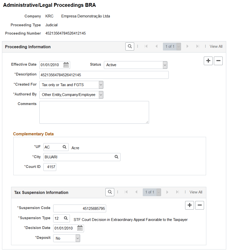

Administrative/Legal Proceedings BRA Page
Use the Administrative/Legal Proceedings BRA page (LEGAL_PROC_BRA) to manage administrative or legal proceedings filed for tax reduction or exemption purposes.
Navigation:
Set Up HCM, and then Product Related, and then Workforce Administration, and then Admin/Legal Proceedings BRA, and then Administrative/Legal Proceedings BRA
This example illustrates the fields and controls on the Administrative/Legal Proceedings BRA page.
Add only proceedings that influence the calculation of taxes or FGTS.
Field or Control Description
Company
Displays the company of the proceeding. This is a required field.
Proceeding Type
Displays the selected type of the proceeding. Values are:
Administrative
Benefit Number – INSS
FAP – Process before 2019
Judicial
Proceeding Number
Displays the entered proceeding number. This is a required field.
Algorithm is in place to validate the proceeding number against the selected proceeding type. The system displays an error if the number cannot be validated successfully.
The proceeding number is:
  • 17 or 21 digits in length if the selected proceeding type is Administrative.
  • 10 digits in length if the selected proceeding type is Benefit Number – INSS.
  • 16 digits in length if the selected proceeding type is FAP – Process before 2019.
  • 20 digits in length if the selected proceeding type is Judicial.
Description
Enter a required description for the proceeding. The maximum length is 100 characters.
Created For
Select the subject or scope of the proceeding. This is a required field.
Values are:
FGTS only/ Termination Soc Cont (FGTS only, or Termination Social Contribution).
Tax only or Tax and FGTS
Note: You may see additional Created For values for proceedings there were added to the PeopleSoft system before the eSocial S-1.0 version.
Authored By
Select the author of the proceeding (for tax reduction or exemption). Values are:
Taxpayer: Company or employee who pays the tax.
Other Entity,Company/Employee
This field is required if the specified proceeding type is Judicial.
Comment
Enter a description or comment for the proceeding. The maximum length is 255 characters.
Complementary Data
Select the state and city of where the proceeding was filed, and enter the 4-digit court ID.
This section is required if the specified proceeding type is Judicial and the Created For field value is Tax only or Tax and FGTS.
Tax Suspension Information
This section is required if the Created For field value is Tax only or Tax and FGTS.
If you update the tax suspension information (for example, the suspension code) on the Admin/Legal Proceeding BRA page after the proceeding information was selected on another page (for example, PeopleSoft Global Payroll for Brazil: Exemption Proceedings Page) using the field prompt, be sure to also update the same information on that page manually. That way, appropriate events (for example, S-1005, S-1010, S-1020, S-1200, S-2299, and S-2399) can be triggered to report the update to the Government.
Suspension Code
Enter the tax suspension number, which is 14 digits in length.
Do not enter a suspension code more than once for the same proceeding number.
Suspension Type
Select the type of the tax suspension. The list of available suspension types varies based on the selected proceeding type:
If the proceeding type is Administrative, valid suspension types are 03,14, and 92.
If the proceeding type is Benefit Number - INSS, all suspension types are available.
If the proceeding type is FAP - Process before 2019, the valid suspension type is 14.
If the proceeding type is Judicial, valid suspension types are 01, 02, 04, 05, 08, 09, 10, 11, 12, 13, 90, and 92.
Suspension types are defined on the Tax Suspension Type BRA Page.
Decision Date
Enter the date that the tax suspension decision was made.
Deposit
Indicate if deposit (for tax payment) is available in the bank from the taxpayer during the proceeding.
The system automatically sets the value to Yes if the specified suspension type is either 02 or 03, and No if the specified suspension type is 90. The field value is not editable.
You can update the Deposit field value for other suspension types.

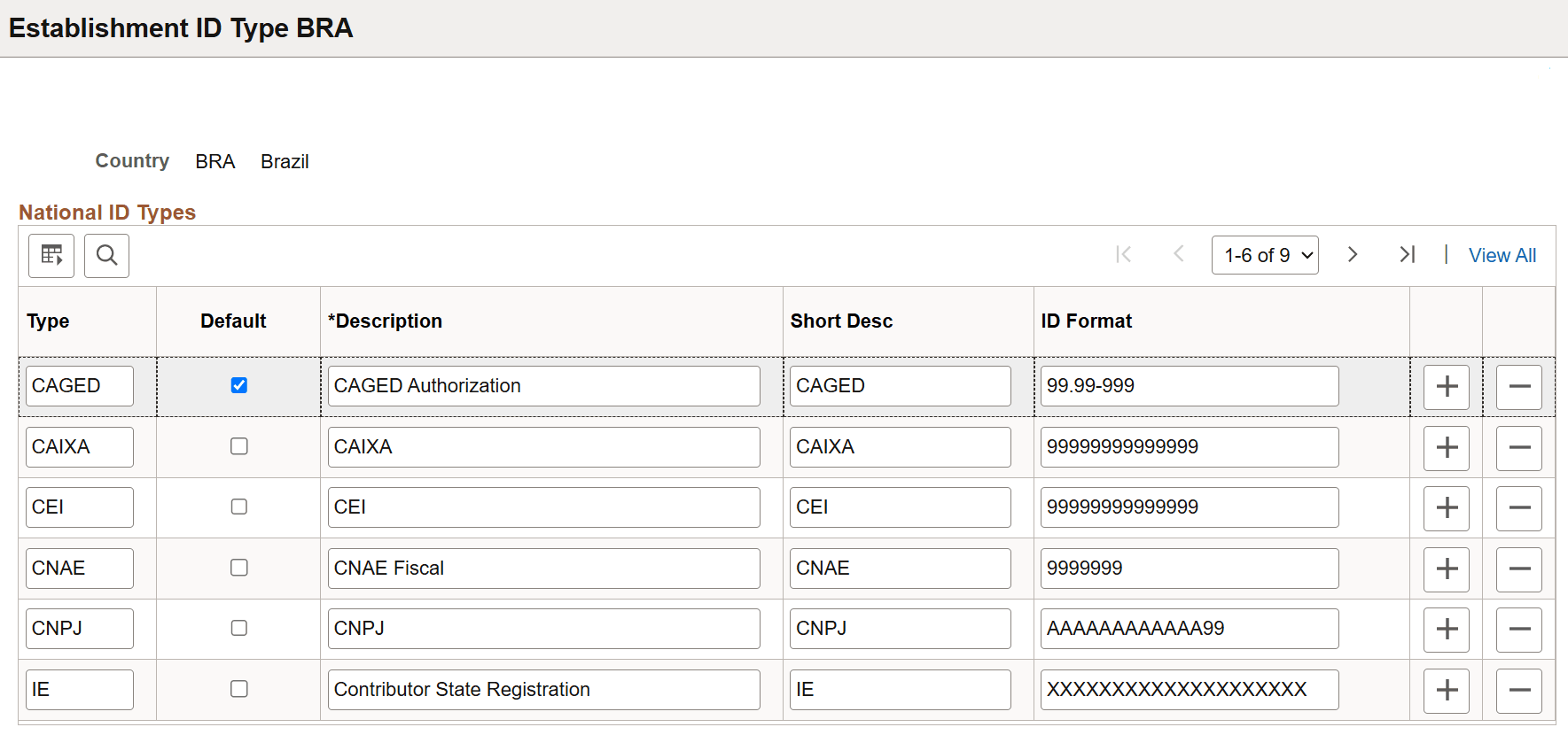

Establishment ID Type BRA Page
Use the Establishment ID Type BRA page (ESTAB_TYPE_BRA) to enter types of establishment ID codes and the format for each ID.
Navigation:
Set Up HCM, and then Product Related, and then Workforce Administration, and then Establishment ID Type BRA, and then Establishment ID Type BRA
This example illustrates the fields and controls on the Establishment ID Type BRA page. You can find definitions for the fields and controls later on this page.
Type
Enter the type of establishment ID code. You can enter ID types that are not legal IDs (national IDs) but are required for certain reports.
Default
Select to establish this type of ID code as the default for the selected country.
ID Format
Specify the format of the ID code. Enter a 9 for each digit of the ID number.
The system has edit masks that apply special formatting to some of the ID types you enter on this page. The system applies the following formatting to these ID types:
  • CNPJ: 99999999999999
  • CNAE: 9999999

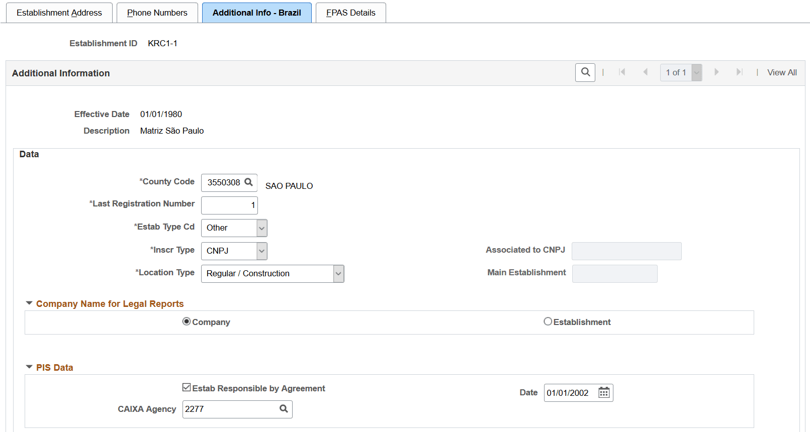

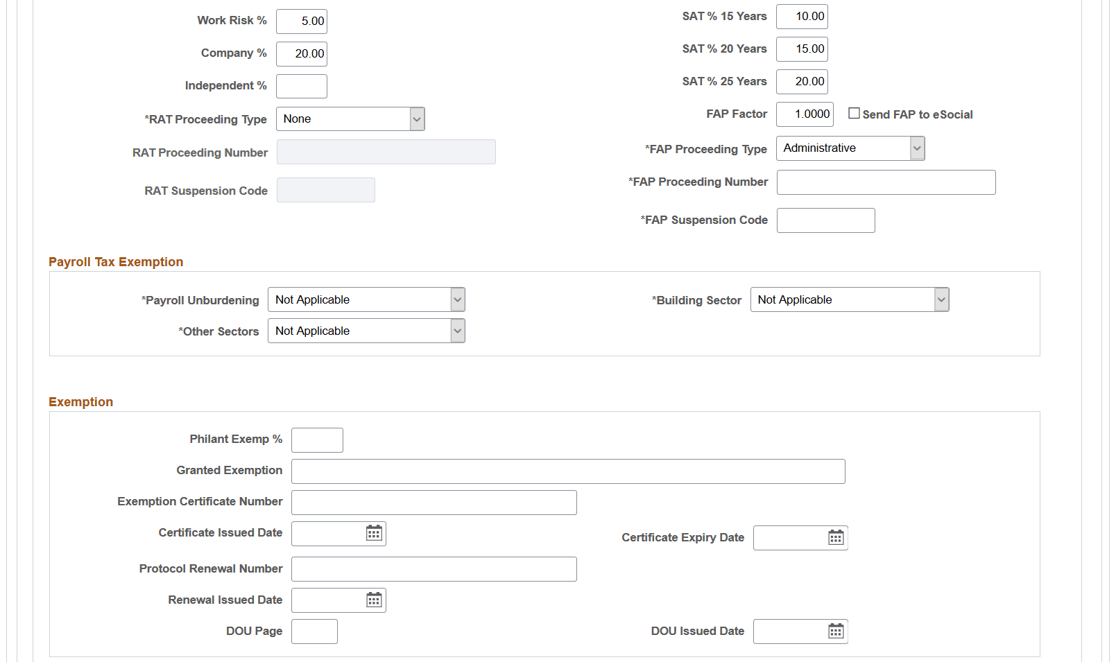

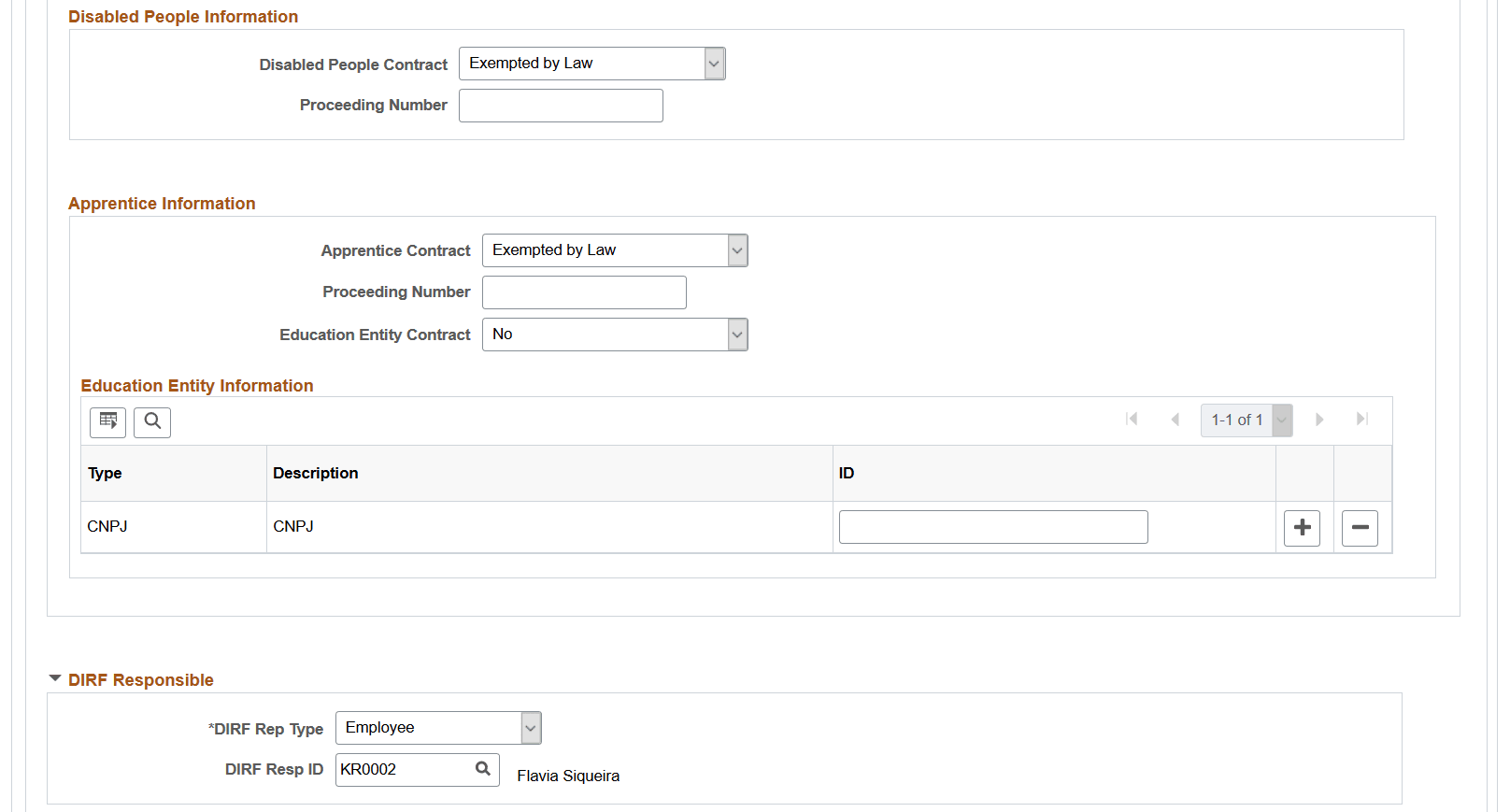

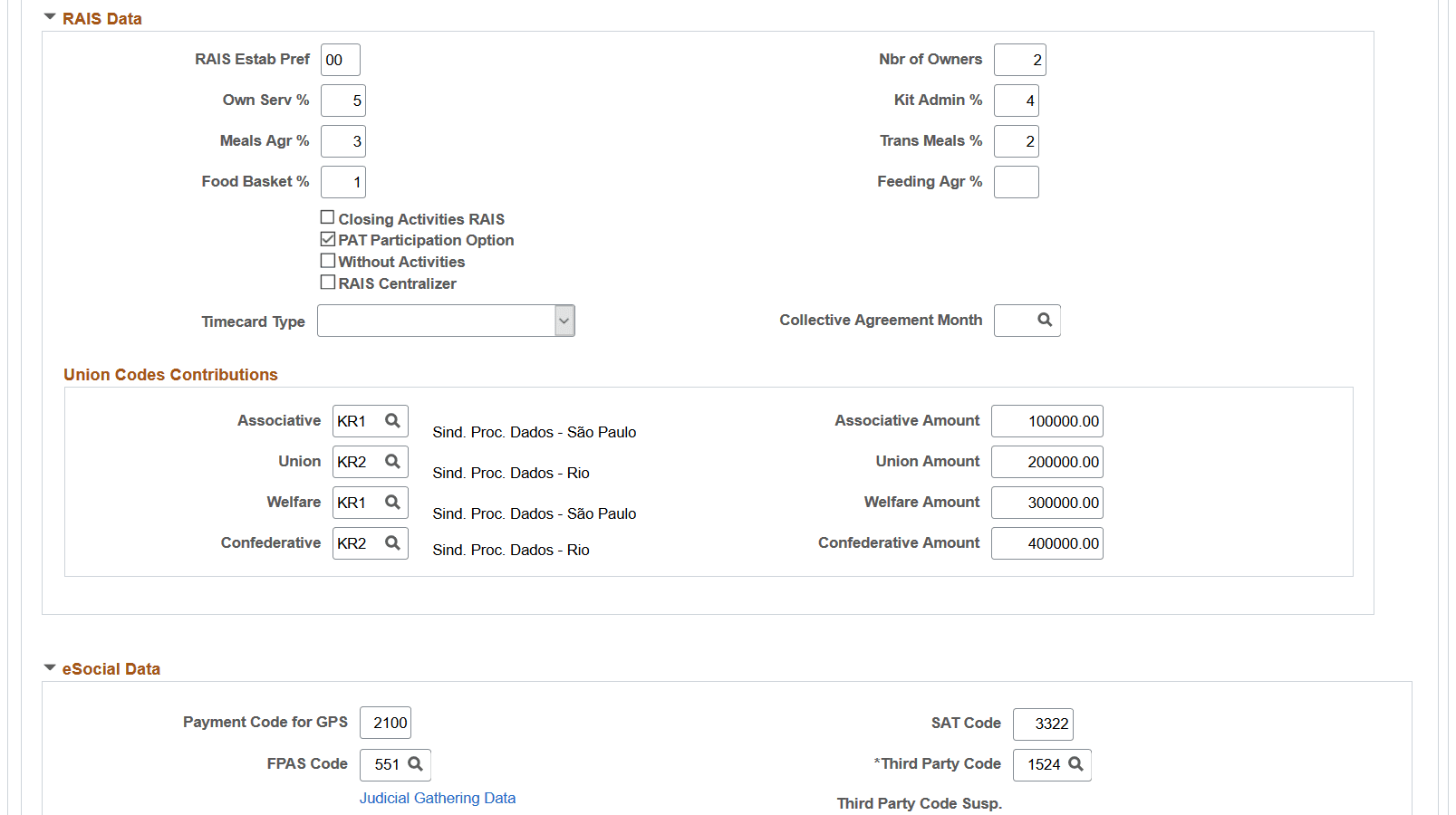

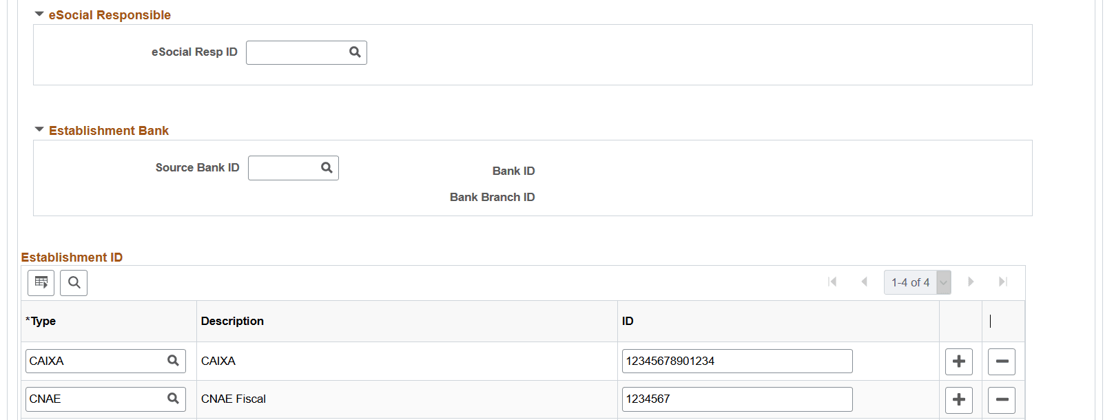

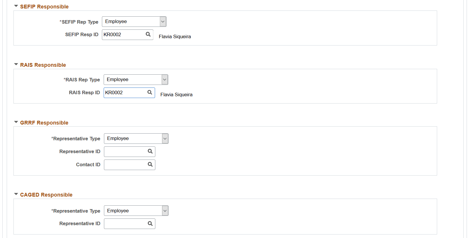

Additional Info - Brazil Page
Use the Additional Info - Brazil (additional information - Brazil) page (ESTAB_TBL_BRA) to enter additional information about the establishment that is specific to the country of Brazil.
Navigation:
Set Up HCM, and then Product Related, and then Workforce Administration, and then Establishment BRA, and then Additional Info - Brazil
This example illustrates the fields and controls on the Additional Info - Brazil page (1 of 6). You can find definitions for the fields and controls later on this page.
This example illustrates the fields and controls on the Additional Info - Brazil page (2 of 6). You can find definitions for the fields and controls later on this page.
This example illustrates the fields and controls on the Additional Info - Brazil page (3 of 6). You can find definitions for the fields and controls later on this page.
This example illustrates the fields and controls on the Additional Info - Brazil page (4 of 6). You can find definitions for the fields and controls later on this page.
This example illustrates the fields and controls on the Additional Info - Brazil page (5 of 6). You can find definitions for the fields and controls later on this page.
This example illustrates the fields and controls on the Additional Info - Brazil page (6 of 6). You can find definitions for the fields and controls later on this page.
County Code
Enter the county code.
Next Registration Number
Displays the registration number to be assigned to the next employee who is hired, rehired, or transferred to this establishment.
The system automatically increments the last registration number value after the current value has been assigned.
This field is not available for edit if the associated company is configured to assign and track registration numbers by company instead of establishment on the Application Fundamentals: Default Settings Page.
Estab Type Cd (establishment type code)
Select the establishment type code, which is based on the size of the establishment. Values are: Micro, Other, and Small.
Inscr Type (inscription type)
Select the establishment inscription type. Values are: CNPJ or CEI.
Associated to CNPJ
Select the CNO owner of the establishment. Establishments that are active for the specified company as of the effective date are available for selection.
This field becomes editable when the selected inscription type is CEI.
Location Type
Select the type of taxable location that is applicable to the establishment. Values are:
Different FPAS/Third. Use this option if the establishment has the same CNPJ as another establishment but different FPAS and third party codes. When selected, the Main Establishment field becomes available for edits.
Location Outside Country
Partial Contract
Regular/Construction

PIS Data
Enter information used to generate the Programa de Integração Social (PIS) report.
Estab Responsible by Agreement (establishment responsible by agreement)
When you select this check box, the CAIXA Agency field appears.
Date
The date the Federal Saving Bank generated the TSO file.
CAIXA Agency
Enter the number of the Caixa Economica Federal (Federal Saving Bank) branch that generates the file with the issued resources for the PIS payment of employees (TSO file).
RAIS Data
Enter information used to generate the Relação Anual de Informações Sociais (RAIS) report.
RAIS Estab Pref (RAIS establishment prefix)
Enter the prefix only if the establishment register appears for RAIS as a key differentiation. RAIS assigns the establishment prefix.
Nbr of Owners (number of owners)
Enter the number of owners working in the establishment.
Own Serv % (owner service percentage)
Enter the owner service percentage.
Kit Admin % (kitchen administration percentage)
Enter the kitchen administration percentage.
Meals Agr % (meals agreement percentage)
Enter the meals agreement percentage.
Trans Meals % (transported meals percentage)
Enter the transported meals percentage.
Food Basket % (food basket percentage)
Enter the food basket percentage.
Feeding Agr % (feeding tickets agreement percentage)
Enter the feeding tickets agreement percentage.
Closing Activities RAIS
Select to indicate that the establishment closed its activities during the base year (the year for which you are currently reporting). A RAIS report uses this information.
PAT Participation Option (Programa de Alimentação do Trabalhador participation option)
Select to indicate the establishment participates in PAT.
Timecard Type
Select a timecard type.
Timecard types are mapped for eSocial reporting on the PeopleSoft Global Payroll for Brazil: Timecard Type Page.
eSocial Data
Information entered in this section is used in GPS/SEFIP and eSocial reporting.
Payment Code for GPS
Enter the company's social security contribution code.
The code is displayed in field #3 on the GPS report.
SAT Code
Enter the work accident insurance code.
FPAS Code
Enter the FPAS (Fundo de Previdência e Assistência Social) social assistance and pension fund code. The activity type of the company determines this code.
The system identifies all third parties and their respective percentages assigned to this code and generates a total percentage of collection for the establishment.
Third Party Code
Enter the code of the third-party that collected services from the establishment. The system uses these codes to identify the third parties involved in a specific collection.
The SEFIP report uses this code to get the GFIP value.
Judicial Gathering Data

Work Risk %
Enter the establishment's identified predominant worth risk percentage. The system uses this percentage to obtain worth risk component of the INSS total amount for collection.
SAT % 15 Years (SAT percentage up to 15 years), SAT % 20 Years (SAT percentage up to 20 years), andSAT % 25 Years (SAT percentage up to 25 years)
Enter the percentages that apply to only the eligible employees for each case of special retirement (with 15, 20, and 25 years of service). The system uses this percentage to obtain the special retirement component of the INSS total amount for collection.
Company %
Enter the percentage to use to obtain the company component of the INSS total amount for collection.
Independent %
Enter the percentage to use to obtain the independent component of the INSS total amount for collection.
Send FAP to eSocial
Select to always print the FAP Factor value in the XML files that are generated for the S-1005 event. Select this check box only if you have received an error from eSocial regarding an integration failure with the Government's FAP system, and need to resubmit the event with a FAP factor.
Clear to print the FAP Factor value in the XML files only if the FAP Proceeding Type value is not None. The Government does not accept any new FAP factor, unless there is an administrative or judicial proceeding number that authorizes its use.
By default, the check box is cleared.
RAT Proceeding Type or FAP Proceeding Type
Select the applicable proceeding type for RAT or FAP. By default, the value is set to None.
RAT Proceeding Number or FAP Proceeding Number
Select or enter the applicable proceeding number for the specified RAT or FAP proceeding type. Proceeding numbers meeting all these conditions are available for selection:
  • Associated with the specified company and proceeding type.
  • Authored by Taxpayer.
  • Created for Tax or Tax and FGTS.
Note: The field prompt is available for use if the Enabled option is selected on the Adm/Legal Proceedings Parameters BRA Page. Enter the number manually, if the option is not selected.
Proceedings are defined on the Administrative/Legal Proceedings BRA Page.
RAT Suspension Code or FAP Suspension Code
Select the tax suspension code for the specified proceeding number. Suspension codes meeting the same conditions as the proceeding numbers are available for selection.
Note: The field prompt is available for use if the Enabled option is selected on the Adm/Legal Proceedings Parameters BRA Page. Enter the code manually, if the option is not selected.
See Also Administrative/Legal Proceedings BRA Page.
Payroll Tax Exemption
Information entered in this section is used in eSocial reporting (S-1280 - Complementary Information to Periodic Events).
Payroll Unburdening
Select the law that the establishment adheres to on payroll unburdening. Values are:
Company - Current Legislation
Municipality - Current Legs
Not Applicable
Building Sector
Select the unburdening payroll for the building sector. Values are:
Non-Replaced Contribution
Not Applicable
Other Sectors
Select the unburdening payroll for other sectors (industries). Values are:
Fully Replaced
Not Applicable
Partially Replaced
Exemption
Philant Exemp % (philanthropy exemption percentage)
Enter the percentage to use to obtain the philanthropy exemption component of the INSS total amount for collection.
Granted Exemption
Enter the granted exemption.
The maximum length of this field is 70 characters.
Disabled People Information
Disabled People Contract
Select the type of contract for disabled employees. Values are:
Exempted by Judicial Process
Exempted by Law
Mandatory
Not Applicable. When selected, the Proceeding Number field is not editable.
Proceeding Number
Enter an applicable proceeding number.
Apprentice Information
Apprentice Contract
Select the type of contract for apprentices. Values are:
Exempted by Law
Mandatory
Not Applicable. When selected, both Proceeding Number and Education Entity Contract fields are not editable.
Proceeding Number
Enter an applicable proceeding number. This value is required if the selected apprentice contract is Exempted by Judicial Process.
Indicate if this is an education entity contract. By default, the value is set to No.
If yes, you must enter a CNPJ ID in the Education Entity Information section.
Specify a CNPJ ID in this section if the Education Entity Contract field is set to Yes.
DIRF Responsible
Complete this group box only for Declaração de Informações à Receita Federal (DIRF) centralizing establishments.
DIRF Rep Type (DIRF representative type)
Select whether the party responsible for generating the DIRF file is a Company, Employee, or Non Empl (non-employee).
DIRF Resp ID (DIRF responsible ID)
Enter the company code or employee ID of the party responsible for generating the DIRF file.
SEFIP Responsible
SEFIP Rep Type (SEFIP representative type)
Select whether the party responsible for generating the SEFIP file is a Company, Employee, or Non Empl (non-employee).
SEFIP Resp ID (SEFIP responsible ID)
Enter the company code or employee ID of the party responsible for generating the SEFIP file.
RAIS Responsible
Complete this group box only for RAIS centralizing establishments.
RAIS Rep Type (RAIS representative type)
Select whether the party responsible for generating the RAIS file is a Company, Employee, or Non Empl (non-employee).
RAIS Resp ID (RAIS responsible ID)
Enter the company code or employee ID of the party responsible for generating the RAIS file.
GRRF Responsible
Representative Type
Select whether the party responsible for generating the GRRF file is a Company, Employee, or Non Empl (non-employee).
Representative ID
Enter the company code or employee ID of the party responsible for generating the GRRF file.
CAGED Responsible
Representative Type
Select whether the party responsible for generating the CAGED file is a Company, Employee, or Non Empl (non-employee).
Representative ID
Enter the company code or employee ID of the party responsible for generating the CAGED file.
eSocial Responsible
eSocial Resp ID (eSocial Representative ID)
Enter the employee ID of the party responsible for generating eSocial reports.
Establishment Bank
Source Bank ID
Enter the establishment's ID.
Establishment ID
Type
Enter an establishment ID type.
Important: If the establishment is set as a headquarter for its company (the Headquarters Unit field is selected on the Establishment Address page), be sure to specify the CNPJ number of the company to support eSocial processing.
ID
Use the Legal Contract Type page (CNT_TYPE_BRA) to associate contract types with legal contract types.
Navigation:
Set Up HCM, and then Product Related, and then Workforce Administration, and then Workforce Data BRA, and then Legal Contract Type, and then Legal Contract Type
This example illustrates the fields and controls on the Legal Contract Type page.
Use this page to associate contract types of your workforce that are defined on the Define Contract Types Page or Contract Types for Regulations Page with available legal contract types.
The system uses this information to identify the legal contract type of contracts (available on the Job Information Page), and populates the information on the (BRA) Additional Contract Data Page for workers.
Use the By Employee Classification page (CNT_TYPE_EC_BRA) to associate employee classes with legal contract types.
Navigation:
Set Up HCM, and then Product Related, and then Workforce Administration, and then Workforce Data BRA, and then Legal Contract Type, and then By Employee Classification
This example illustrates the fields and controls on the Employee Classification page.
Use this page to associate employee classes that are defined on the Employee Class page with available legal contract types.
As an alternative to the Legal Contract Type page, the system uses this information to identify the legal contract type of contracts (available on the Job Information Page), and populates the information on the (BRA) Additional Contract Data Page for workers.
Use the Health Providers page (HEALTH_PROV_BRA) to define health providers.
Navigation:
Set Up HCM, and then Product Related, and then Workforce Administration, and then Workforce Data BRA, and then Health Providers, and then Health Providers
This example illustrates the fields and controls on the Health Providers page.
Use this page to define health providers for use in the system. Health providers are referenced on the PeopleSoft Global Payroll for Brazil: DIRF Parameters BRA Page to generate DIRF reports.
Health Provider Code
Displays the code that identifies the health provider in the system.
The maximum length of this code is 10 characters.
Use the Private Fund & FAPI Entities page (FAPI_PROV_BRA) to specify private pension funds and associated CNPJ numbers.
Navigation:
Set Up HCM, and then Product Related, and then Workforce Administration, and then Workforce Data BRA, and then Private Fund and FAPI Entities, and then Private Fund & FAPI Entities
This example illustrates the fields and controls on the Private Fund & FAPI Entities page.
Use this page to specify private funds and FAPI entities that can be referenced on the PeopleSoft Global Payroll for Brazil: IREN Parameters BRA Page.
CBO Codes BRA Page
Use the CBO Codes BRA page (CBO_CD_TBL_BRA) to define occupation codes.
Navigation:
Set Up HCM, and then Product Related, and then Workforce Administration, and then CBO Codes BRA, and then CBO Codes BRA
This example illustrates the fields and controls on the CBO Codes BRA page.
CBO Codes BRA page
Codes effective before December 31, 2002 were in the format 99999. Codes effective from January 1, 2003 onward are in the format 9999–99.
Refer to the official website (http://www.mtecbo.gov.br) for a list of CBOs (Brazilian Code of Occupation).
Exam Required
Select to indicate that drug test is required for this CBO code and occupation.
Use the Special Training Codes BRA page (SPECIAL_TRAIN_BRA) to define special training codes.

This example illustrates the fields and controls on the Special Training Codes BRA page.
The system prepopulates this component with special training codes from table 28 in eSocial. Do not add any codes that are not supported in eSocial.
These codes are used in recording special training for employees on the (BRA) Training/Capacity Building BRA Page.
Use the Income Tax Type Abroad BRA page (INC_TAX_TYPE_BRA) to define income tax type codes for employees living abroad.
Navigation:
Set Up HCM, and then Product Related, and then Workforce Administration, and then Income Tax Type Abroad BRA, and then Income Tax Type Abroad BRA
This example illustrates the fields and controls on the Income Tax Type Abroad BRA page.
The system prepopulates this component with income tax type codes from table 30 in eSocial. Do not add any codes that are not supported in eSocial.
These codes are used in recording the income tax type for employees living aboard on the (BRA) Personal Information BRA Page.
