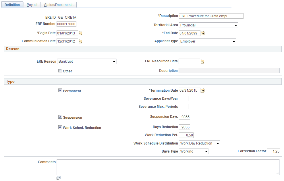

ERE Data ESP - Definition Page
Use the ERE Data ESP - Definition page (ERE_DATA_ESP) to create an ERE data definition.
Navigation:
Workforce Administration, and then ERE Procedure ESP, and then ERE Data ESP
This example illustrates the fields and controls on the ERE Data ESP - Definition page. You can find definitions for the fields and controls later on this page.
Field or Control Description
ERE Number
Enter the unique ERE number that is provided by the labor authority that is administrating the ERE event.
Territorial Area
Select to indicate if the ERE procedure is national, autonomic or provincial.
Begin Date and End Date
Enter the date range for the ERE event.
Communication Date
Enter the date on which the ERE event is communicated to the affected employees and their representatives.
Applicant Type
Select the entity who is applying for the ERE event. Valid values are: Employee’s Representative, Employees, and Employer.
Reason
ERE Reason
Select the reason for initiating the ERE procedure. The values available are:
  • Bankrupt
  • Economical
  • Force Majeure
  • Organizational
  • Production
  • Technological
ERE Resolution Date
If you select Bankrupt as the reason for initiating ERE procedure, the ERE Resolution Date field is displayed and you can specify the date.
Other
Select this check box if the reason for initiating ERE procedure is other than the ones listed in the ERE Reason field.
Description
If you select the Other check box, enter a description of the reason for initiating the ERE procedure.
Type
Permanent
Select to indicate that permanent terminations are included in the ERE event. When you select this check box, the Termination Date, Days/Years, and Max Period fields become available.
Note: If you select this check box, the Permanent ERE (ERE_PERM_EE_ESP) page appears in the ERE Employee Data ESP (ERE_EMPL_DTA_ESP) component for this ERE ID.
Termination Date
Enter the date on which the terminations associated with the ERE event take effect.
Severance Days/Years
Enter the number of days by year of service that the payroll process uses when calculating severance pay amounts for employees affected by permanent ERE.
Severance Max Periods (maximum period)
Enter the maximum number of periods that the payroll process uses when calculating the severance pay amounts for employees affected by permanent ERE.
Suspension
Select to indicate that suspensions are included in the ERE event. When you select this check box, the Suspension Days field becomes available.
Note: If you select this check box, the Suspension ERE (ERE_SUSP_EE_ESP) page appears in the ERE Employee Data ESP (ERE_EMPL_DTA_ESP) component for this ERE ID.
Suspension Days
Enter the length of the suspension in days.
Work Sched. Reduction (work schedule reduction)
Select to indicate that work schedule reductions are included in the ERE event. When you select this check box, the Days Reduction, Work Reduction Pct., and Work Schedule Distribution fields become active.
Note: If you select this check box, the Work Reduction ERE (ERE_WSRD_EE_ESP) page appears in the ERE Employee Data ESP (ERE_EMPL_DTA_ESP) component for this ERE ID.
Days Reduction
Enter the number of days by which the ERE event reduces the work schedule of employees affected by work schedule reduction ERE.
Work Reduction Pct. (work reduction percentage)
Enter the percentage by which the ERE event reduces the work schedule of employees affected by work schedule reduction ERE.
Select whether the work schedule reduction is a Daily Hours Reduction or a Work Day Reduction. If you select the Work Day Reduction value, the Days Type field becomes available.
Days Type
Select whether the work day reduction is for Natural days or Working days. If you select the Working value, the Correction Factor field becomes available.
Correction Factor
Enter the correction coefficient that the payroll process uses when calculating ERE days to account for holidays and weekends. This factor applies to work schedule reductions comprising work days with days not worked.
Comments
Enter any additional comments for the ERE event.
