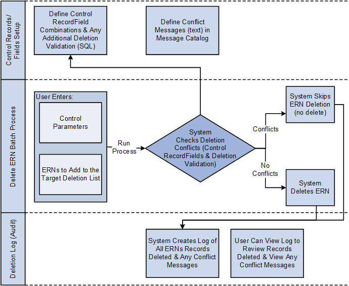

This flowchart illustrates the Delete ERN process. Setup tasks include defining deletion criteria, validations, and error messages. Then, during the deletion batch process, the administrator chooses ERNs to be deleted, and the system checks the ERNs against the deletion criteria, deleting only those with no conflicts. Finally, during the audit phase of the process, the system creates a log showing the deleted ERNs and the conflict messages for the ERNs that were not deleted:
Delete ERN process flowchart showing setup tasks, business process steps, and audit functions

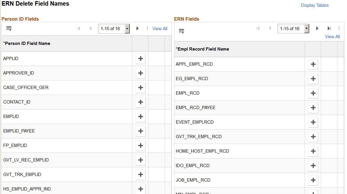

ERN Delete Field Names Page
Use the ERN Delete Field Names page (HR_EERCDDEL_FIELDS) to define Person ID field names and Empl Rcd Nbr field names maintained in the system.

This example illustrates the fields and controls on the ERN Delete Field Names page. You can find definitions for the fields and controls later on this page.
Field or Control Description
Person ID Field Name
Use this table to specify the field names for the Person ID available in the system.
ERN Fields
Use this table to specify the field names for the Empl Rcd available in the system.
Display Tables
Click this link to display all tables in the system that have any combination of these defined PersonID and ERN fields. This display enables system administrators to review tables potentially impacted by the ERN Delete process.

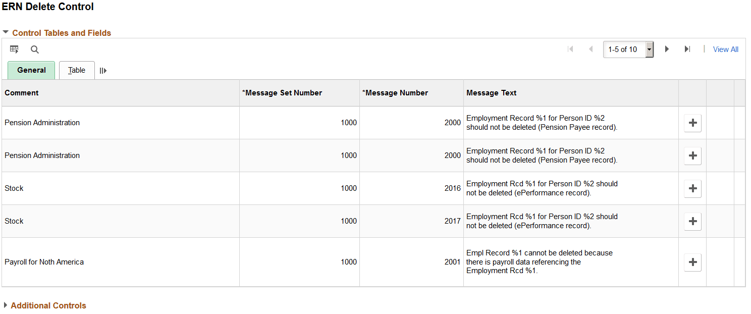

This example illustrates the fields and controls on the ERN Delete Control page: General tab. You can find definitions for the fields and controls later on this page.

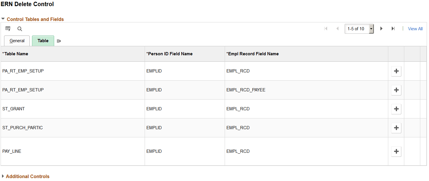

Each of the conflict checks has a configurable conflict message. You can assign conflict messages using the Message Catalog. Conflict messages are displayed on the ERN Delete Process Results page.
This example illustrates the fields and controls on the ERN Delete Control page: Table tab . You can find definitions for the fields and controls later on this page.
The system checks these table and field combinations prior to running the Delete ERN process to help ensure that no key dependent data or process will be negatively impacted by the delete. The system scans the record/field combinations defined in this table and if an ERN that is targeted for deletion is identified in one of these control table/field combinations, the system prevents the ERN from being deleted.

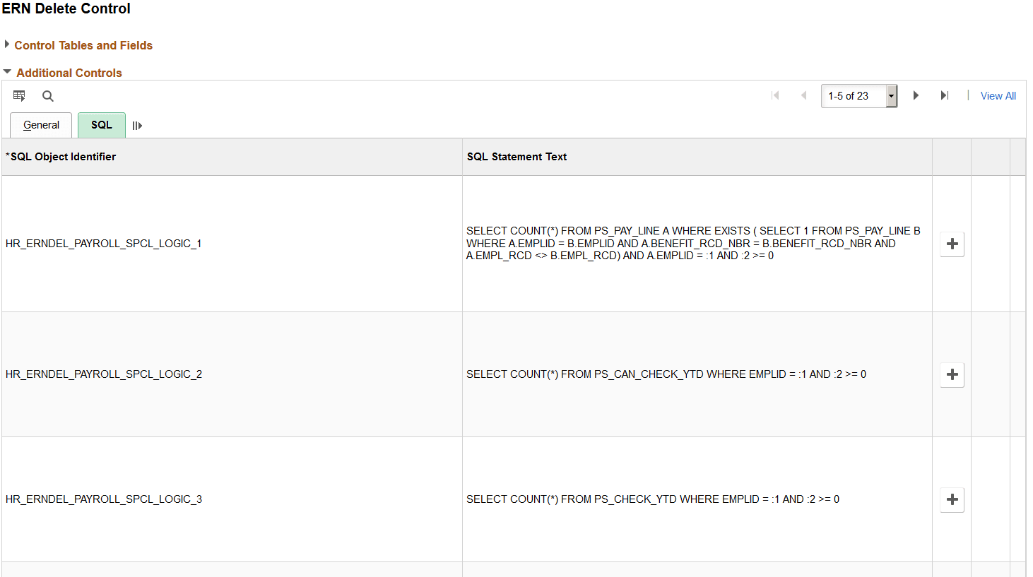

This example illustrates the fields and controls on the ERN Delete Control page: Additional Controls - SQL tab. You can find definitions for the fields and controls later on this page.
Use the SQL tab in the Additional Controls section of the page to enter more complex product specific conflict checking that cannot be represented through the simple entry of control records and fields. Add additional SQL logic that the system needs to check prior to deleting ERNs.
You cannot delete ERN delete controls that are delivered as system data.

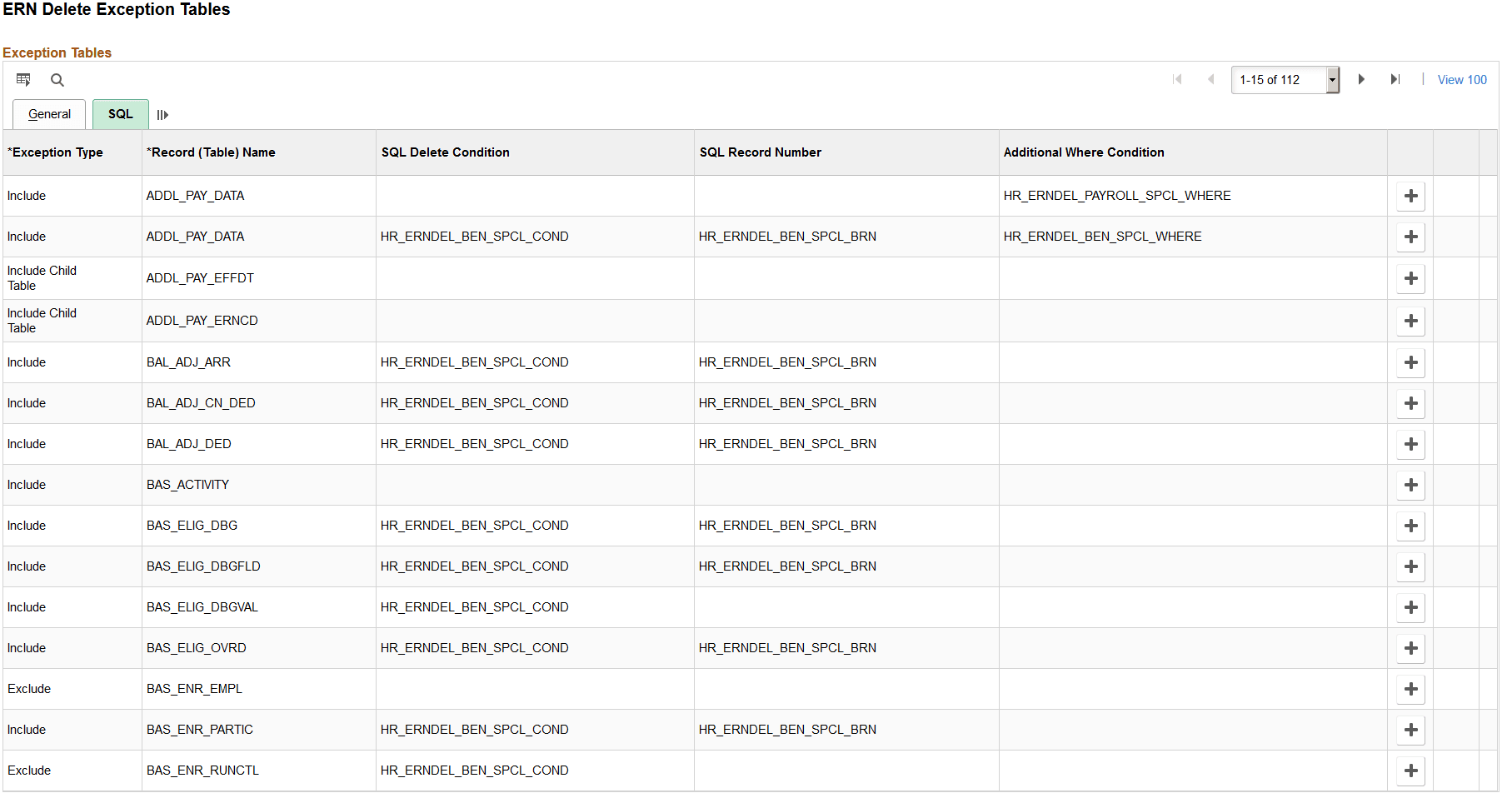

ERN Delete Exception Tables Page
Use the ERN Delete Exception Tables page (HR_EERCDDEL_EXC) to define exceptions for the deletion logic.

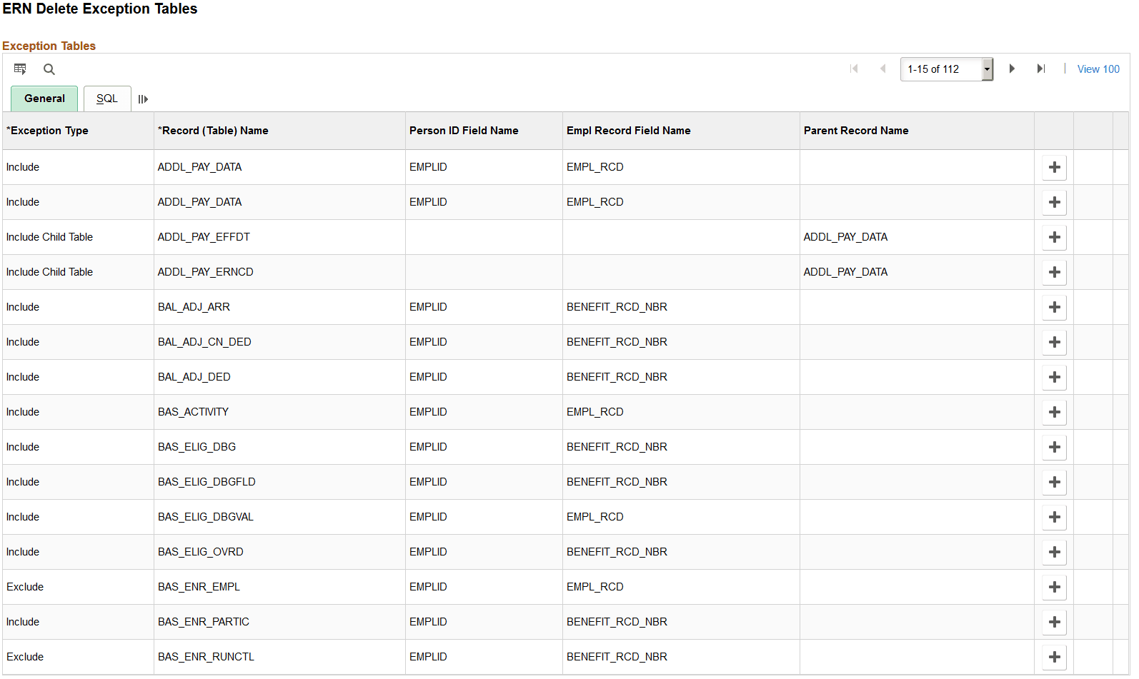

This example illustrates the fields and controls on the ERN Delete Exception Tables page: General tab. You can find definitions for the fields and controls later on this page.
Exception Type
Select one of three options in this field:
  • Include includes the table in the deletion process. Select this option when the table does not follow the standard rule, but specific requirements.
  • Exclude excludes the table from the deletion process.
  • Include Child Table includes a table that does not contains an ERN but is attached as a child to a table that must be deleted.

Access the SQL tab on the ERN Delete Exception Tables page.
This example illustrates the fields and controls on the ERN Delete Exception Tables page: SQL tab. You can find definitions for the fields and controls later on this page.
SQL Delete Condition
Define a condition for deletion based on EMPLID and EMPL_RCD. If the request defined in the setup returns a number greater than 0, the record will be skipped during the deletion process.
SQL Record Number
Define a request that returns the number to be used as the ERN based on EMPLID and EMPL_RCD.
Additional Where Condition
Request that defines an additional where clause added during the deletion process.

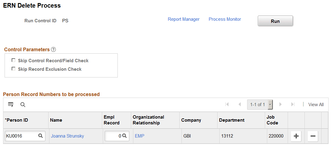

This example illustrates the fields and controls on the ERN Delete Process page. You can find definitions for the fields and controls later on this page.
Run
Click the Run button to access the Process Scheduler Request page, where you can run or schedule the Person ID Delete process. This deletion process is irreversible.
Control Parameters
The PeopleSoft HCM application delivers the ID Delete User role. Only administrator users with this role can modify the settings in this group box. For users without this role, these check boxes are disabled.
Skip Control Record/Field Check
Select this check box to have the ERN Delete process skip the validation of fields and controls within the ERN Delete Control Page, Control Tables and Fields grid box. For example, if this option is left deselected and there is a record that corresponds to those defined on the ERN Delete Control Page, then the system will issue the warning and not process the ERN delete. If you select this check box, the ERN will be deleted even if there is existing data for this person in the records listed in the Control Tables and Fields grid box.
This check box is deselected by default. With this default setting, the deletion process does not allow deletion of the ERN from the system if data exists in the ERN Delete Control setup.
Skip Record Exclusion Check
Select this check box to have the ERN Delete process ignore the exception records marked as Exclude on the ERN Delete Exception Tables Page as well as any of the %AET,AUDIT% and UPG% records in the system. For example, if this option is left deselected and a person has data rows that correspond to any of the exception records listed as Exclude, then the system will process the ERN delete. If you select this check box, the process with delete the ERN even though it is listed as Exclude in the exception setup.
This check box is deselected by default. With this default setting, the deletion process does not affect tables that the process is configured to exclude.
When the Skip Control Record/Field Checkis deselect, regardless if the Skip Record Exclusion Check is selected or deselect, the process will first check the ERN Delete Control page configuration. If the person has data rows in any of the records listed on the ERN Delete Control setup page, then the ERN Delete process will not continue with the deletion.

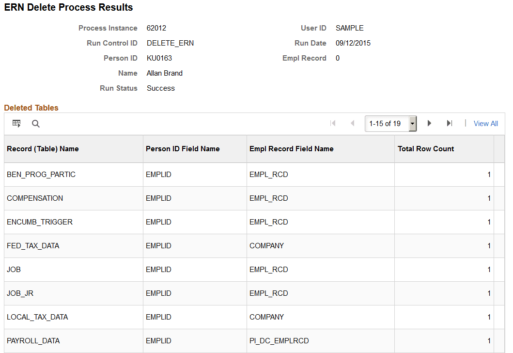

ERN Delete Process Results Page
Use the ERN Delete Process Results page (HR_EERCDDEL_RESULT) to lists ERN Delete Process results information.

This page displays results for a single ERN. The page appearance changes depending whether the ERN was successfully deleted.
This example illustrates the fields and controls on the ERN Delete Process Results page - Run Status - Success. You can find definitions for the fields and controls later on this page.
When the deletion is successful, you can review a list of tables where data was deleted.

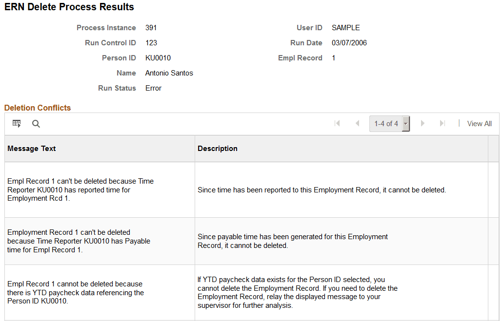

This example illustrates the fields and controls on the ERN Delete Process Results - Run Status - Error. You can find definitions for the fields and controls later on this page.
When the deletion is not successful, the page displays message text describing why the ERN deletion was not processed.
