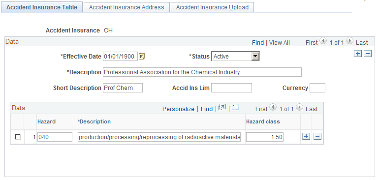

Accident Insurance - Accident Insurance Table Page
Use the Accident Insurance Table page (ACCDT_INS_TABLE) to define accident insurance codes for German employees.
Navigation:
Set Up HCM, and then Product Related, and then Workforce Administration, and then Workforce Data DEU, and then Accident Insurance, and then Accident Insurance Table
This example illustrates the fields and controls on the Accident Insurance - Accident Insurance Table page. You can find definitions for the fields and controls later on this page.
Field or Control Description
Hazard
Enter the code for the hazard type.
Note: German hazard codes are regulated and standardized by the German government.
Hazard Class
Enter the class, or degree, of the covered hazard.
