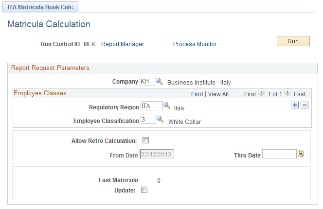

Matricula Calculation Page
RUNCTL_MATRBK_ITA
Run the Matricula Book Calc process to update the Matricula table.
Use the Matricula Calculation page (RUNCTL_MATRBK_ITA) to run the Matricula Book Calc process to update the Matricula table.
Navigation:
Workforce Administration, and then Job Information, and then Employment Categorization ITA, and then Matricula Calculation, and then Matricula Calculation
This example illustrates the fields and controls on the Matricula Calculation page. You can find definitions for the fields and controls later on this page.
Field or Control Description
Employee Classification
Select the employee classification for this book.
Allow Retro Calculation
Select to enable retroactive calculations to capture previously lost or missed matricula data.
Last Matricula and Update
Select if you want the process to check for new matricula data only.
