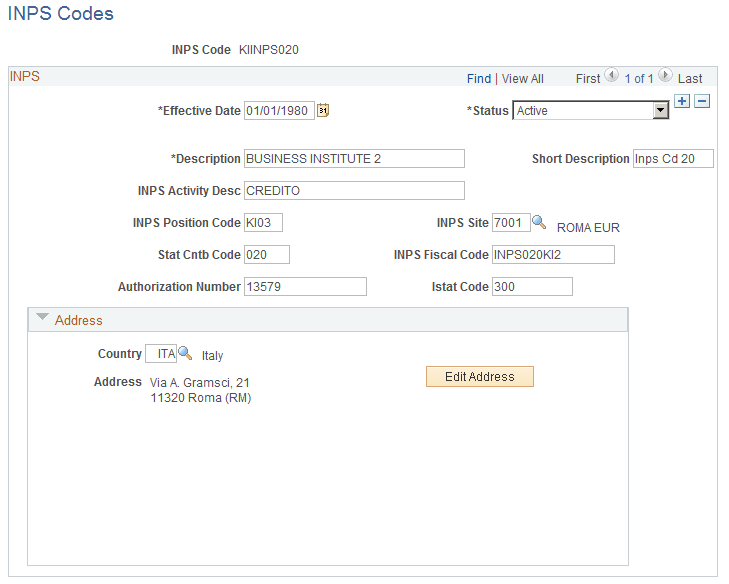

INPS Codes Page
Use the INPS Codes page (INPS_TBL_ITA) to define INPS data for social security contributions and information needed for social security reporting (DM10).
Navigation:
Set Up HCM, and then Product Related, and then Workforce Administration, and then Workforce Data ITA, and then INPS Codes, and then INPS Codes
This example illustrates the fields and controls on the INPS Codes page. You can find definitions for the fields and controls later on this page.
INPS Codes page
Field or Control Description
INPS Activity Desc (INPS activity description)
Enter the company activity description to be reported on the INPS declarations.
INPS Position Code
Enter the company INPS position codes.
INPS Site
Select the INPS site to which the company must send declarations. Set up INPS site codes on the INPS Site page.
Stat Contr Code (statistical contribution code)
Enter the statistical contribution code to be reported on the INPS declarations.
INPS Fiscal Code
Enter the company fiscal code.
Authorization Number
Enter the authorization codes to be reported on the INPS declarations.
Istat Code
Enter the Istat code to be reported on the INPS declarations.
