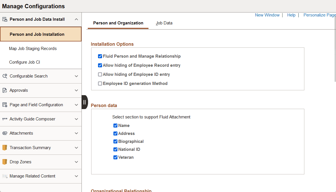

Manage Configurations Tile
Administrators use the Manage Configurations tile to access a navigation collection of setup pages used to configure Person and Job Data for fluid.
Navigation:
The Manage Configurations tile is delivered as part of the Manage Human Resources Dashboard, but the location can change if you change the delivered home pages or if administrators personalize their home pages.
This example illustrates the Manage Configurations tile.
Select the Manage Configurations tile to access the Manage Configurations navigation collection.
This example illustrates the Manage Configurations application start page for the tablet.
This application start page is a navigation collection that enables administrators to access frequently-used HR administration setup components for fluid Person and Job Data from one location.
The application start page lists the components collected under these categories:

Rows that display a downward facing arrow are category headers. Select a category row to expand and view the component collection associated with that category.
When using a large form factor device, the right panel displays the component selected in the left panel.
For small form factor devices, the application start page displays the categories and components. Select a component item to have the system take you to that component. Use the back button to return to the HR Administration application start page to select a new component.
