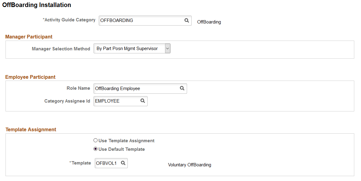

OffBoarding Installation Page
Use the OffBoarding Installation page (HR_OFB_INSTALL) to identify the OffBoarding category, participants, and template assignment settings.
Navigation:
This example illustrates the fields and controls on the OffBoarding Installation page.
Field or Control Description
Activity Guide Category
Indicate the Activity Guide Composer category that should be used for OffBoarding. Only those templates that use this category will be available when assigning templates to a worker. The PeopleSoft application delivers the OFFBOARDING category and the delivered templates are assigned to this category.
The category is assigned to a template on the Enterprise Components: Activity Guide Composer - General Information Page.
Manager Participant
Manager Selection Method
Select the managerial reporting relationship the system should use for OffBoarding transactions if the manager is a participant of the process. Available options for are:
  • By Department Manager ID: Defines the reporting relationship based on information in the Manager ID field on the Department Profile page (DEPARTMENT_TBL_GBL).
  • By Dept Security Tree: Determines person data access using information from the security tree.
  • By Group ID: Determines data access using the Group ID set up in the group build feature.
  • By Part Posn Mgmt Dept Mgr ID: Defines the reporting relationship by the Reports To field on the Work Location page (JOB_DATA1) and the information in the Manager ID field on the Department Profile page. This is designed for the organizations that use partial Position Management. The system searches for reporting relationship based on Report To first, and then for Department Manager ID.
  • By Part Posn Mgmt Supervisor: Defines the reporting relationship by both the Reports To and the Supervisor ID fields on the Work Location page. This is designed for the organizations that use partial Position Management. The system searches for reporting relationship based on Report To first, and then for Supervisor ID.
  • By Reports To Position: Defines the reporting relationship based on the position in the Reports To field on the Work Location page.
  • By Supervisor ID: Defines the reporting relationship based on information in the Supervisor ID field on the Work Location page.
Employee Participant
Role Name
Enter the OffBoarding role that should be assigned to employees when a termination event trigger is initiated from Job Data. The PeopleSoft application delivers the OffBoarding Employee role to access the OffBoarding tile and pages. You can also create and enter your own role to access the OffBoarding pages.
The End User roles for a template are assigned on the Enterprise Components: Activity Guide Composer - Security Page.
Note: The role name that is assigned to the user profile must match the role that is specified for the End User security type on the Enterprise Components: Activity Guide Composer - Security Page.
Category Assignee Id
Select from a list of assignee IDs. Valid IDs come from the activity guide category you entered at the top of this page and are defined on the Enterprise Components: AG Composer Categories - Assignees Page. The system uses the assignee ID to identify if the employee is a participant so that the OffBoarding role will get automatically assigned during the handler processing.
Template Assignment
Use Template Assignment and Template Assignment
When you select the Use Template Assignment option, the Template Assignment field appears.
Select this option to indicate that the system should automatically determine the template that should be assigned to a worker using the Template Assignment engine. The system will use the Template Assignment ID you enter here, which defines the rules for automatically assigning templates to workers. For more information on the Template Assignment process, see the Enterprise Components: AG Composer Tmplt Asgnmt - Template Assignment Page.
Use Default Template and Template
When you select the Use Default Template option, the Template field appears.
Select this option to indicate a default template that should be assigned to all workers when an event triggers the process. The PeopleSoft application delivers OFBINVO (Involuntary OffBoarding) and OFBVOL1 (Voluntary OffBoarding) as the default template, but you can add your own templates.
For additional information on OffBoarding triggers, see the topic.
