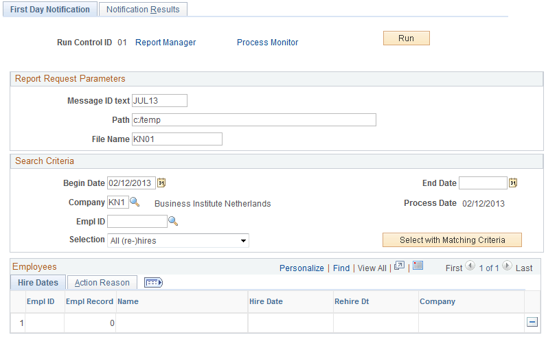

This example illustrates the fields and controls on the First Day Notification page. You can find definitions for the fields and controls later on this page.
Field or Control Description
Message ID text
Enter free format text that is combined with the company's federal employer tax ID and the tax number suffix to form the message ID in the XML file. Use the First Day Report Setup page to define the tax number suffix to use.
Path
Enter the location of the XML file that is created by the First Day Notification NLD process. Enter an absolute path name, such as c:/temp/, or a relative path such as \\machinename\temp.
File Name
Enter the name of the XML file that is created by the First Day Notification NLD process. The process generates files with file names that combine the file name you enter here with the employee ID and employee record number.
Search Criteria
Use this group box to specify the search criteria for the First Day Notification.
Begin Date and End Date
Enter the dates for the reporting period. The system searches for hires and rehires that occurred within this period.
Company and Empl ID (employee ID)
Select a company to search for hires and rehires within that company, or select an employee if you want to run the report for a specific person.
Leave this field blank to run the report for all companies.
Selection
Select one of these values:
New (re-)hires: To include only those hires and rehires that have not been previously reported.
All (re-)hires: To include all hires and rehires that occurred in the period defined by the begin and end dates. Use this option if you want to rerun the notification for a period. For example if you have changed employee data and you need to recreate the notification, use this option to run the report.
Select with Matching Criteria
Click this button to search for employees who match the criteria you entered in the Search Criteria group box. The system displays matching employees in the Employees scroll area.
Employees
This scroll area lists the employees who matched the search criteria that you specified. Review the employee details and delete any employees you don't want to include in the report. When you click the Run button to run the First Day Notification NLD process, the system generates a notification for the employees that are listed in the scroll area.
The system includes employees whose Regulatory Region is NLD only. Employees' regulatory region is defined on the Job Data - Work Location page.
Hire Date and Rehire Dt (rehire date)
Displays the employee's hire or rehire date.
Action and Reason Code
Displays the action and reason code that were used for the hire or rehire. The system includes employees with the HIR (hire) action or REH (rehire) action codes only.
Empl Class (employee class)
Displays the employee class that is assigned to the employee on the Job Data - Job Information page.
