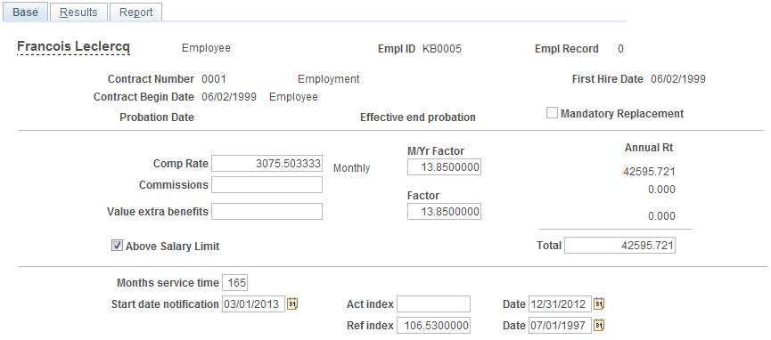

This example illustrates the fields and controls on the Create Notification - Base page. You can find definitions for the fields and controls later on this page.
The system displays the employee's name, employee ID, and the employment record number for your reference. This information comes from the person's personal data record.

Determining the Employee's Base Compensation Amount (Jaarloon)
Field or Control Description
Comp Rate (compensation rate)
The system calculates the employee's monthly compensation rate based on the employee's compensation rate information on the Job Data - Compensation page and displays it here. Adjust the rate information as necessary. The system uses this amount when determining the employee's monthly pay variable for the Claeys calculation.
M/Yr Factor (month/year factor)
The system multiplies the month base amount by the month/year factor of 13.85000 to calculate a value for the employee's Annual Rt (annual rate) income amount field. The default factor displayed here comes from the default employee compensation factors that you entered on the Company table. The Belgian government determines this factor amount, but you can override the default here if the factor amount changes.
Commissions
Enter any commissions amount that the system should add to the employee's month base as part of the Claeys calculation income amount.
Value extra benefits
Add value extra benefits amounts, including other components of nonbase pay, such as any benefits that the employee receives (for example, salary, vacation pay, 13th month, meal checks, and so on). The system multiplies the value extra benefits amount by the value extra month/year factor of 13.85000 to calculate the employee's yearly extra income amount.
Total
The system displays the total compensation amount (jaarloon) based on the year base, the commission, and extra benefit results. Adjust the system calculated total as necessary.
Understanding the Above Salary Limit Setting
Above sal. limit (above salary limit)
The system indicates if the employee's compensation total is above salary limit by accounting for the contract type. Select this check box to override the factor values on the Create Notification - Results page.
To change the salary limit setting, ensure that the notification period start date falls after the effective end probation date that appears with the employee's contract information at the top of the page. In this case, the system fixes the salary limit for a longer period (the system uses the factors in the Claeys Defaults group box on the Create Notification - Results page to calculate the notification period, and makes the factors available for entry).
If the date is before the effective end probation date, you can't change the salary limit setting.

Determining the Employee's Seniority
Months service time
The system calculates and displays the employee's number of months service time. The system determines service month information by considering both the employee's service months information on the Job Information page (JOB_DATA) and the number of months service time on the Seniority page (SENIORITY_BEL) if the seniority type is set to Legal Seniority. The system adds the two seniority amounts and displays them as the months service time amount.
The system doesn't consider partial months in this calculation and doesn't round up. If the employee's service time is 9 months, 16 days, the system displays 9 as the employee's months service time. Adjust the months service time as necessary.
Note: If you enter seniority information on the Seniority page for an employee and the seniority type is set to Company Seniority, the system uses the months of seniority calculation on the Job Information page to set the number of months service time on the Create Notification - Base page.
Start date notification period
Set the start date notification period for the employee's termination notification to the first day of the next month if you're not performing the Claeys calculation for this employee on the first day of the current month. The default value is the first day of the month following the effective date that appears with the contract information at the top of the page.
For example, if you start your Claeys calculation for an employee on April 14, the system enters a start date for the notification period of May 1. Override this date as necessary.
Note: The start date notification period that appears on the Base page affects the way the system performs the Claeys calculation on the Results page. If the start date notification period begins before the effective end probation date on the Base page, the system uses a notification period of Days on the Results page when you click the Calculation button. If you enter a start date notification period that begins after the employee's effective end probation date, the system uses a notification period of Days, Weeks, or Months, depending on the statute information for that employee on the Contract Data - Contract Type/Clauses page, as follows. If the employee is classified as a Worker on the Employment Terms Type page, the notification period appears in Weeks. The classification of Employee results in a notification period of Months. The classification of Not Applicable results in a notification period of Days.
Act. Index (actual index)
The actual index if one is assigned for this company in the Company table. The actual index is a monthly reference number to be held against the reference index number.
The actual index is used in the Claeys calculation to calculate the notification period term that is related to the yearly base on the Create Notification - Results page:
(Yearly base salary / 1000) × (factor yearly base / actual index) × correction factor)
Date
The last day of the year preceding the year in which you're performing the Claeys calculation for an employee. This date is for your reference only, and isn't saved when you save the page.
Ref. Index (reference index)
You can also update the reference index or accept the system default that is based on the factor yearly base index that is set up on the Company Table- Default Settings, Claeys Defaults for this company. The reference index is a yearly reference amount to be compared against the actual index amount.
Date
The system also displays the reference index date. The system sets this date to the beginning of the last half of the year prior to the year in which you're performing the Claeys calculation. This date is for your reference only, and isn't saved when you save the page. The system doesn't use the reference index as part of the Claeys calculation.
