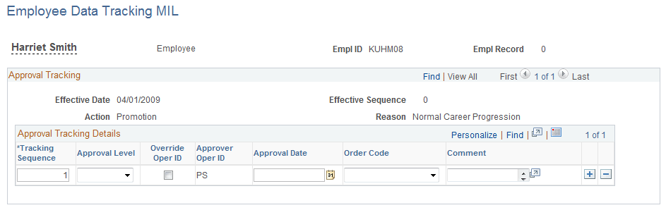

Employee Data Tracking MIL Page
Use the Employee Data Tracking MIL page (MIL_EE_DATA_TRK) to track approvals for mass or individual job updates.
When an employee or group of employees have a new Job row created as a result of a specific event (for example, mass deployment), use this component to indicate the approvals that occurred for this Job Data change. Changes to the job rows can be done manually or through the Mass Update process.

This example illustrates the fields and controls on the Employee Data Tracking MIL page. You can find definitions for the fields and controls later on this page.
Field or Control Description
Tracking Sequence
Enter a tracking sequence number.
Approval Level
Select a level, such as an initial request or final, for approving a military order. Define approval levels in the Military Approval Levels table.
Override Oper ID (override operator identification) and Approver Oper ID (approver operator identification)
The system displays the operator that entered the approval information. Select the Override Oprid check box to manually update the approving operator id.
Approval Date
Enter the date for this approval level.
Order Code
Select an order that explains the purpose of this job change. Define order codes in the Military Order Codes table.
Comment
Enter additional comments regarding this job update and approval.
The Mass Update process will update this component by calling the service MassUpdateMilitaryApproval, which in turn will call the Component Interface HCR_MIL_EE_TRK_SRV.
