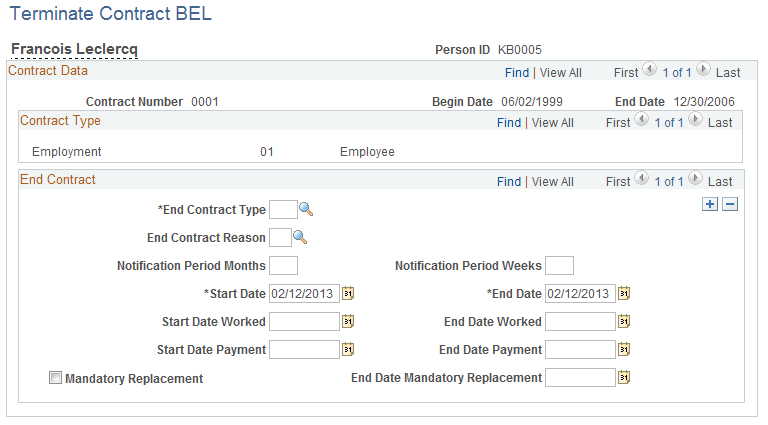

Terminate Contract BEL Page
Use the Terminate Contract BEL page (CONTRACT_END_BEL) to record information that is necessary for terminating a Belgian worker.
Navigation:
Workforce Administration, and then Job Information, and then Contract Administration, and then Terminate Contract BEL, and then Terminate Contract BEL
This example illustrates the fields and controls on the Terminate Contract BEL page. You can find definitions for the fields and controls later on this page.
Use this page to:
  • Specify that the worker's employment contract has ended, and the reason that your organization has chosen to end the contract.
  • Set up and track the worker's termination notification period.
  • Track the worker's replacement if a replacement is mandatory based on the contract type.
Field or Control Description
End Contract Type
Select a valid end contract type (such as death, disability, or early retirement with mandatory replacement).
End Contract Reason
Select an end contract reason (such as disrupted employee relations, family reasons, a company specific program, or contract expiration).
Notification Period Months
Enter the number of months of notice that the employee must be given prior to the contract end date. The notification period that you enter here affects Claeys calculations in the Create Notification component.
When you enter an amount here and move out of the field, the End Date field value adjusts accordingly.
Notification Period Weeks
Enter the number of weeks of notice that the employee must be given before the contract end date. The notification period that you enter here affects Claeys calculations in the Create Notification component.
Start Date andEnd Date
Enter the date that the notification period begins, and the date on which the notification period ends and the employment contract terminates.
The Start Date defaults to the next up-coming Monday and the end date is calculated from the values entered in the Notification Period Months and Notification Period Weeks values. You can overwrite these dates.
Start Date Worked
Record the employee's start date for this job contract, which should be the same as the date that you record for a job change in the worker's job record.
End Date Worked
Enter the employee's last working day on this job contract, which should be the same as the date that you record for a job change in the worker's job record—whether the worker is terminating with your company or leaving one job contract to move into another.
Start Date Payment and End Date Payment
Track the start and end payment dates, which the system stores and uses for payroll.
Mandatory Replacement
If the end contract type that you selected requires mandatory replacement, the system automatically selects this check box and makes it display-only. Specify whether an end contract type requires replacement on the Define Contract End BEL page.
End Date Mandatory Replacement
If the end contract type requires mandatory replacement, the system calculates the end date of the mandatory replacement period based on the end date on which the employee is terminated. It also calculates the number of months that you specified on the End Employment Terms table (CNT_END_TBL_BEL) as the length of the replacement period.

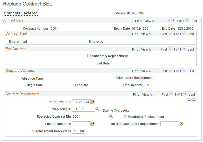

Replace Contract BEL Page
Use the Replace Contract BEL page (CONTRACT_REPL_BEL) to enter the person who replaces the worker in the employment contract.
Navigation:
Workforce Administration, and then Job Information, and then Contract Administration, and then Replace Contract BEL, and then Replace Contract BEL
This example illustrates the fields and controls on the Replace Contract BEL page. You can find definitions for the fields and controls later on this page.
Replacing ID
Select the ID of the employee who replaces the terminated employee in this contract. The system displays all employees who have been tagged as replacement employees for Belgian employment contracts in your human resources system. Select any applicant or employee with employment terms. If you want to start someone's employment as a replacing employee, you must create employment terms for that person first.
Replacing Contract Nbr (replacing contract number)
Select the number for this contract, based on the replacing employee ID that you selected.
Select to indicate that mandatory replacement is required.
End Replacement
If you selected Mandatory Replacement, enter the date for the end replacement. You may want to track this date if you have an earlier than expected end date for a fixed term employment contract.
Enter the end date for mandatory replacement.
