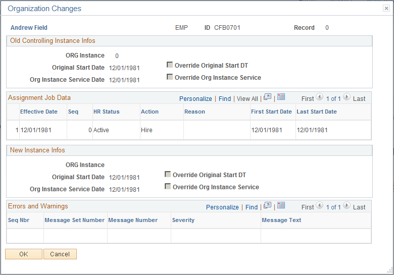

Click the Details link to access the Details page for Promote Instance.
This example illustrates the fields and controls on the Promote an Assignment - Details page. You can find definitions for the fields and controls later on this page.
Field or Control Description
Old Controlling Instance Infos
This information is for display only.
Assignment Job Data
The grid displays job data for the selected assignment, sorted by effective date in ascending order.

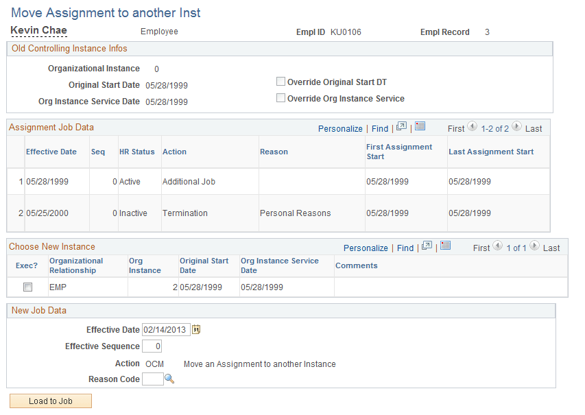

Move Assignment to another Inst Page
Use the Move Assignment to another Inst page (HCR_OC_CHG_ASGN) to move an additional assignment to another instance.
Navigation:
Workforce Administration, and then Job Information, and then Assignment Instance Change, and then Move Assignment to another Inst
This example illustrates the fields and controls on the Move Assignment to another Inst page. You can find definitions for the fields and controls later on this page.
Assignment Job Data
Choose New Instance
This grid lists all instances for this employee per organization. If you select an assignment that has a start date prior to the instance's first hire date, you cannot select that instance. You can only move an assignment to an instance if the active date of the assignment coincides with the dates of the instance.
New Job Data
Enter the job effective date, job effective sequence, the action reason for the action. The action code defaults to OCM (move an assignment to another instance), and cannot be changed.
Load to Job
Click this button to insert the new job data into the JOB record.
Transfer to Job
This button is displayed after the Load to Job process runs successfully. Click the Transfer to Job button to review the updated JOB data. If the process does not run successfully, an Errors and Warnings grid appears that lists the errors.

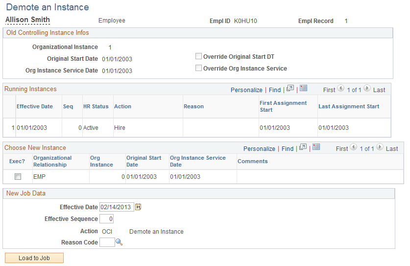

Demote an Instance Page
Use the Demote an Instance page (HCR_OC_CHG_ASGN) to change a controlling instance to an additional assignment under another instance.
You can demote an instance to an assignment only if the instance does not have any additional assignments.
Navigation:
Workforce Administration, and then Job Information, and then Demote an Instance, and then Demote an Instance
This example illustrates the fields and controls on the Demote an Instance page. You can find definitions for the fields and controls later on this page.
Running Instances
Choose New Instance
New Job Data
Enter the job effective date, job effective sequence, the action reason for the action. The action code defaults to OCI (Demote and Instance), and cannot be changed.
Load to Job
Transfer to Job
This button is displayed after the Load to Job process runs successfully. Click this button to review the updated JOB data. If the process does not run successfully, an Errors and Warnings grid appears that lists the errors.
