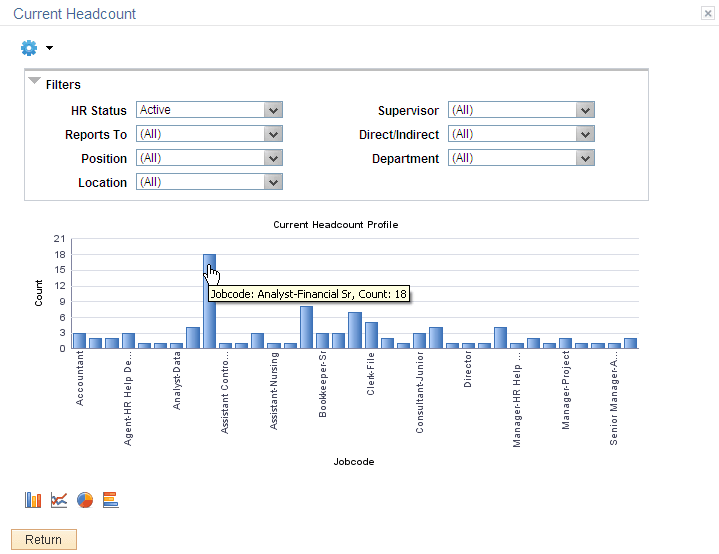

Current Headcount Pivot Grid
Use the Current Headcount pivot grid page (PTPG_PGVIEWER) to view the distribution of the organizational population.
Administrators can view this information for employees, contingent workers, and persons of interest based upon the current job effective dated rows. Managers can view the distribution of the organizational population by job code based upon the current job effective dated rows.

Field or Control Description
Filters
Select values from the following filter drop-down fields to narrow your report results.
  • HR Status
  • Reports To
  • Position
  • Location
  • Supervisor
  • Job Code (administrator page only)
  • Direct/Indirect (manager page only)
  • Department
All fields are set to (All) as a default value (with the exception of the HR Status field for the administrator view, which defaults to Active). The drop-down list contains values you can select or deselect, to enable you to include one or many criteria options for a field. For example, you can choose to view the results of one department, such as Finance, several departments, such a Finance and Human Resources, or select to include all valid departments in the drop-down list. When you select various options, the field will display (Multiple Items).
Use the (Select All) check box in the drop-down list to select or deselect all field values. When you have not selected any items for the field, the filter field will default back to (All).
The chart will update dynamically after selecting criteria for each filtering field. As you select items within each filtering field, other filter fields may be hidden or shown as display only, based on valid values that are available based on your current filter settings. For example, if you select a specific manager in the Supervisor field, only locations associated with the manager’s employees will be available in the Location field. If all the people reporting to this manager have the same location, then the page presents the Location field as display only with that one location as the filter value.
To refresh the chart, change the available filter fields to All. This will reset the other fields in the Filters group box.
The page displays the chart in the middle of the page, based upon the search criteria filter settings. You can change how the chart appears by selecting from one of these icons at the bottom of the page:
  • Bar Chart
  • Line Chart
  • Pie Chart
  • Horizontal Bar Chart
Pause over each graphic items, such as a bar or pie, to view the organizational relationship (administrator) or job code (manager) details and count. Select the bar or pie piece to choose from the following options:
  • Detailed View:
    Select this option to access the Pivot Grid Drilldown page to view a list of employees that make up the results for the bar or pie piece.

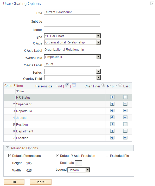

User Charting Options Page
Use the User Charting Options page (PTPG_DISPLAYOPT) to define the display settings for the user results chart.
Navigation:
Select the Chart Options item from the Options Menu drop-down arrow above the Filters group box on the Headcount Movement or Current Headcount page.
This example illustrates the fields and controls on the User Charting Options page.
Use this page to change the chart title, chart type, data to be displayed on the x axis, data to be displayed on the y axis, or add or delete chart filters. Changes you make here are good for the current session of viewing the pivot grid.
For example, if you want to view a headcount profile by full time/part time status, select Full/Part Time from the X Axis drop-down list and click OK. The chart will refresh and display the full/part time label and data on the X axis.
Chart Filters
Select the add a row icon button to include additional filters. Filter options vary according to the pivot grid and administrator or manager access.
Select the delete row icon button to remove filter options for this session.
Advanced Options
Default Dimensions
Select this check box to have the system default the 265 height and 625 width for the bar or pie graphic. Deselect this check box to enter your own height and width.
Default Y Axis Precision and Decimals
Select to have the system default the decimal precision of 0. Deselect this check box to enter your own decimal precision number in the Decimals field.
Legend
